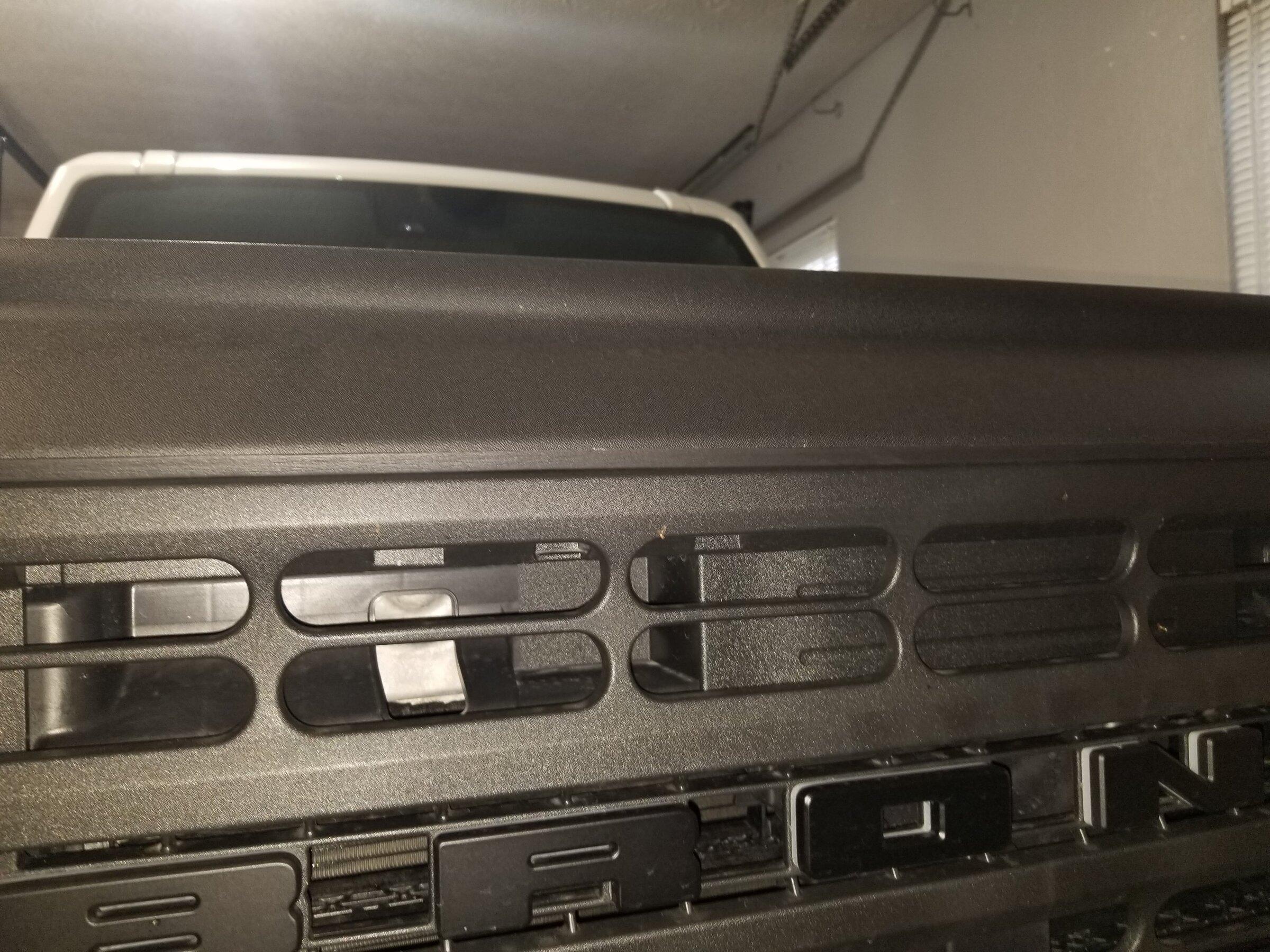

I just installed the Aeroskin II today. No flutter from the hood at 75mph, but I did hear a slight whistling sound. It was really windy today, so I am hoping that was the issue. Anybody else notice a whistling sound after they put it on?

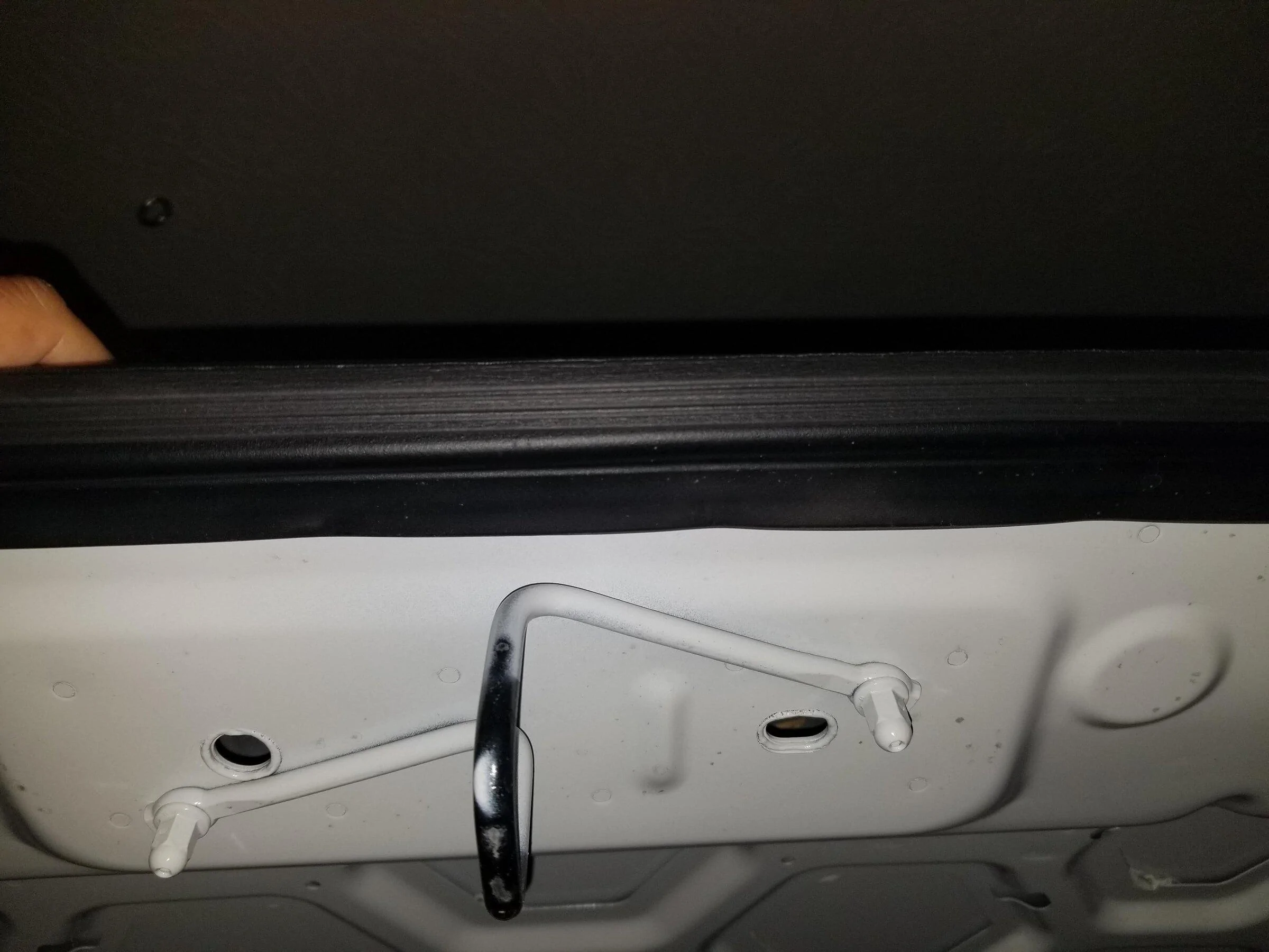

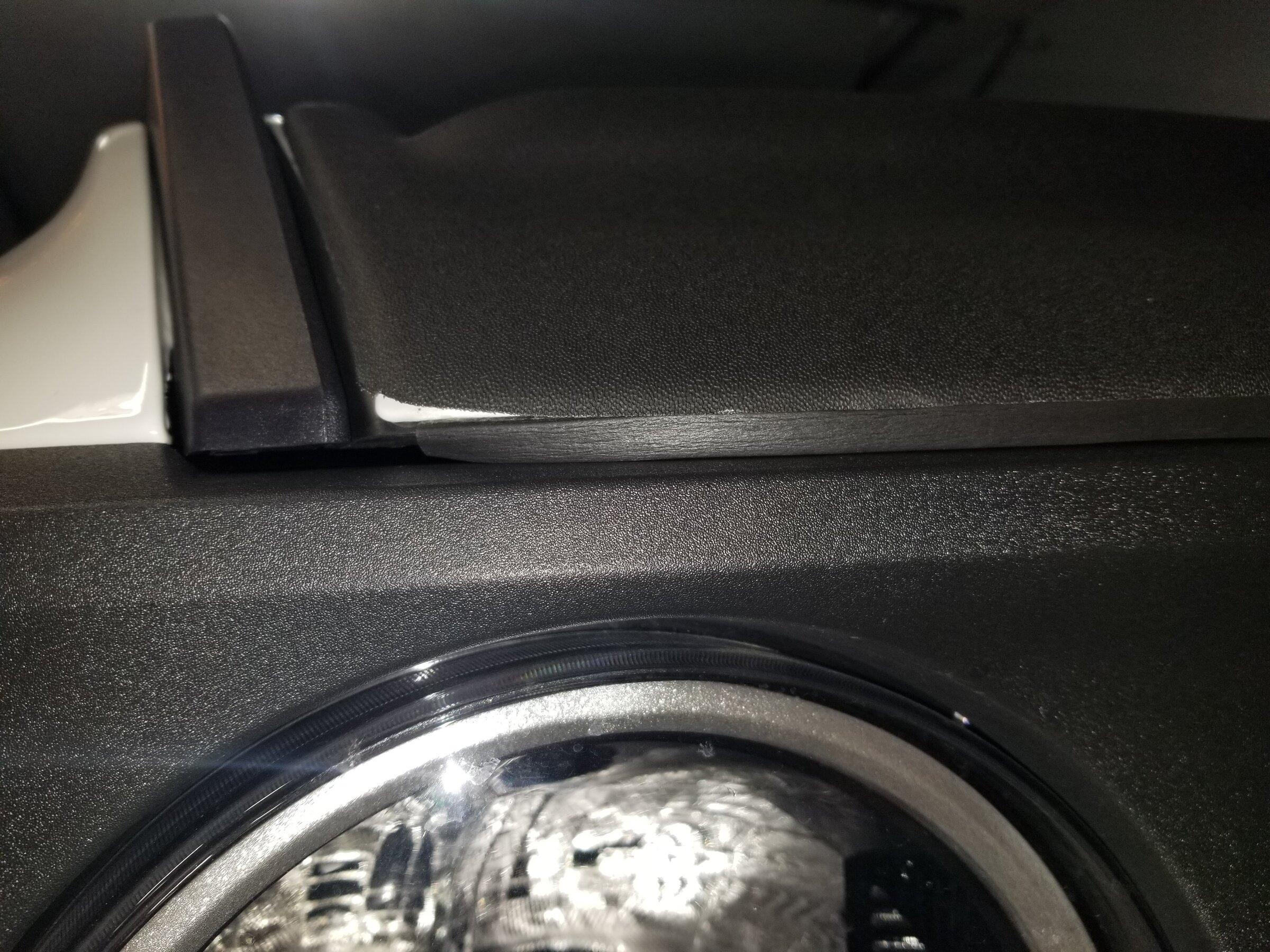

I was finally able to track down and fix the whistle a few weeks ago. I thought I would post my solution. There was about a 1/4" gap between the grill and the bottom of the hood deflector that was causing the whistle. Found some stick on weather seal at lowes that worked perfect, sorry don't have the weather seal details threw out the packaging. Whistle is gone and has been working great for a few weeks.

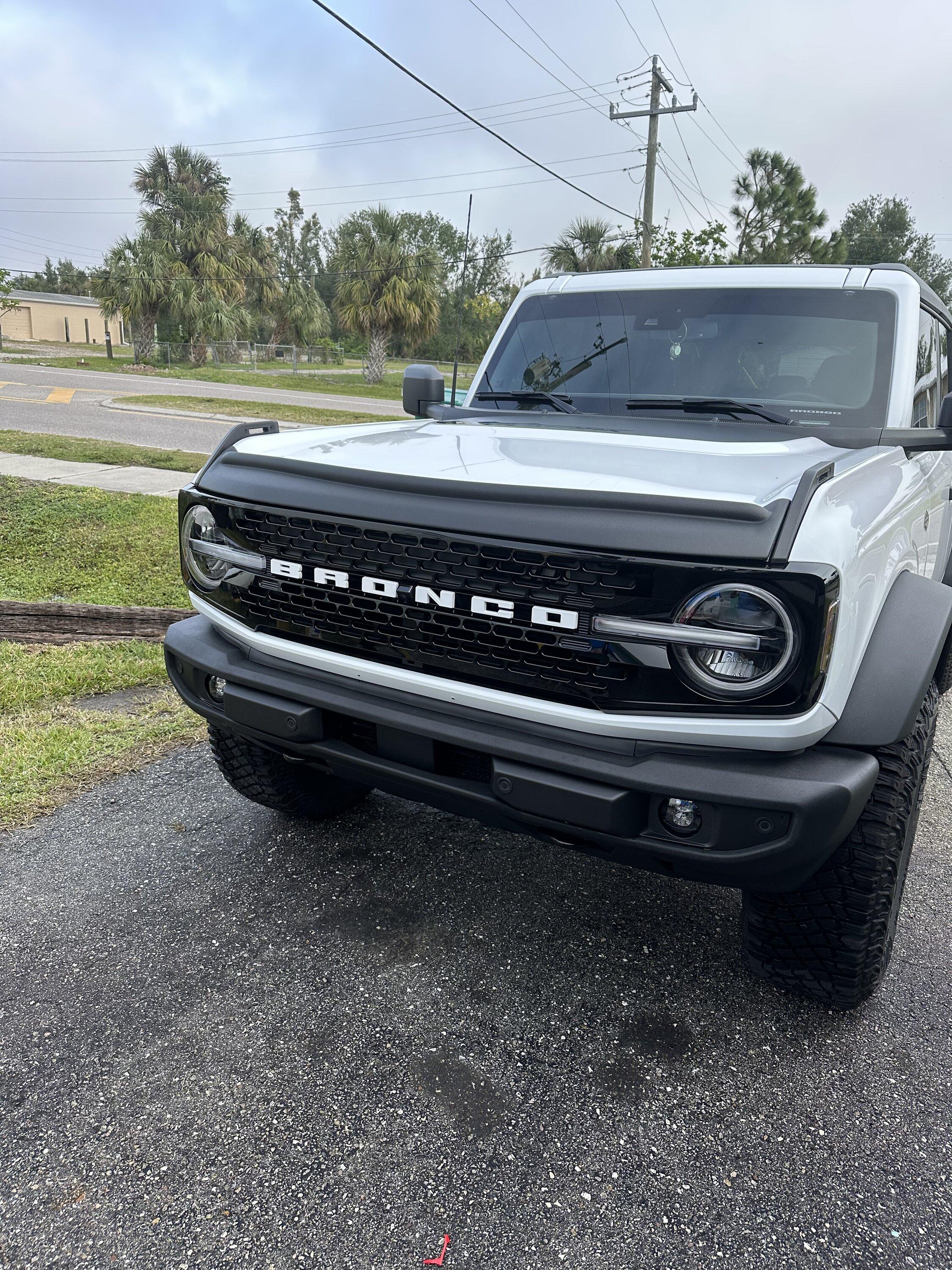

I did notice some flutter up in the rise near the cowl where the Wildtrak graphic is. Aeroskin II.
