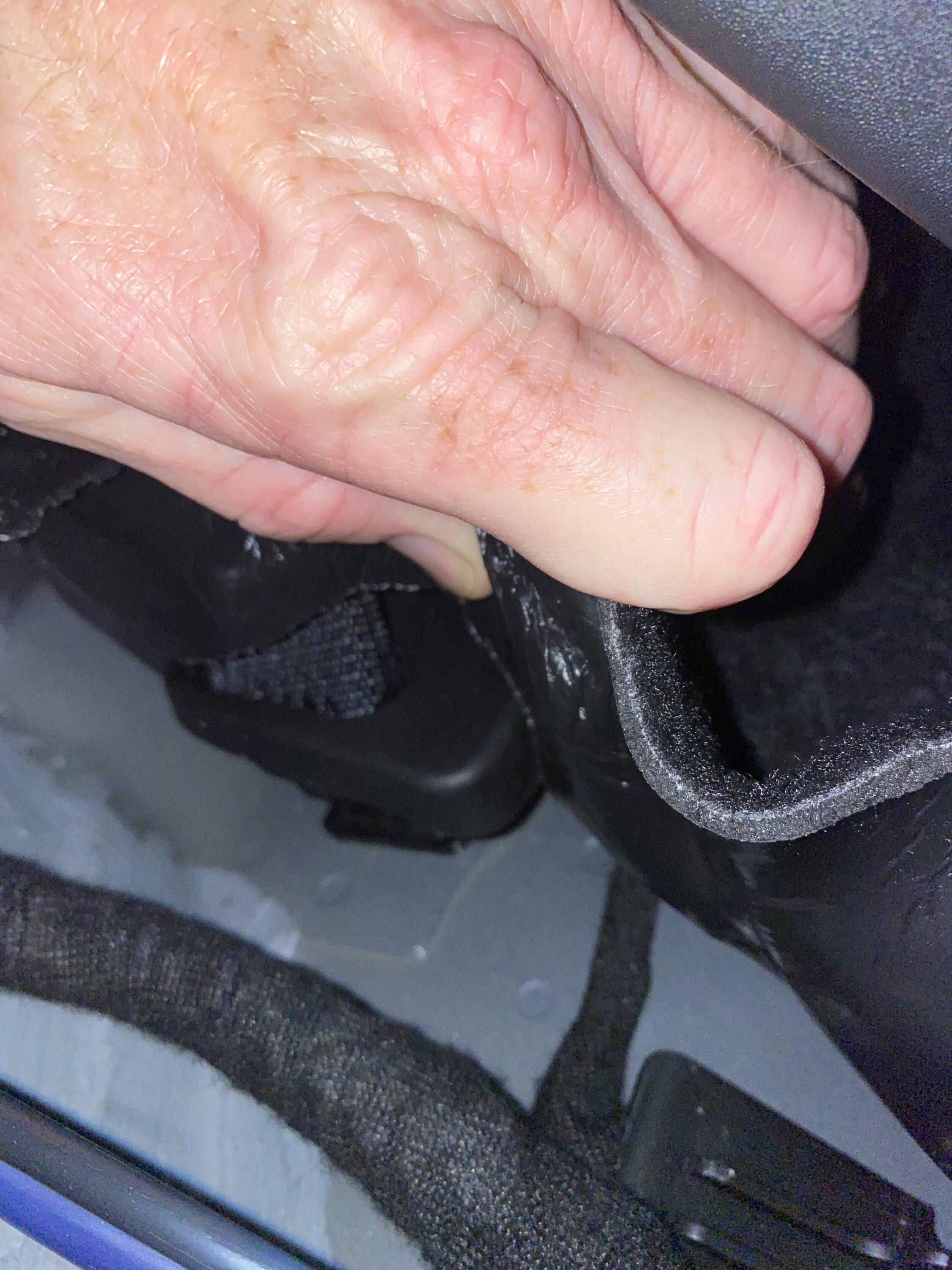

If anyone has those back panels off does the seat belt retract un bolt with no electrical connections? I did a rear seat delete and I hate those belts I will never use them but don't want to cut them.
Also how difficult to remove rear panels?

@wetdog None of the panels I removed were that difficult to remove. Just always pull straight out, not at angles. Here is a pic. Looks like it just bolts through body. I don’t see a wire connected here. Probably one at the fastening end, not the retractable end based on that wire that looks like it runs 90 degrees out of the door sill under the back seat. The small one just below my hand.

Great thank you so much đź‘Ťim going to pull the panels tomarrow and be rid of those rear belts,this is what b6g is all about!
Thanks again for being the trailblazer and for the helpđź‘Ť

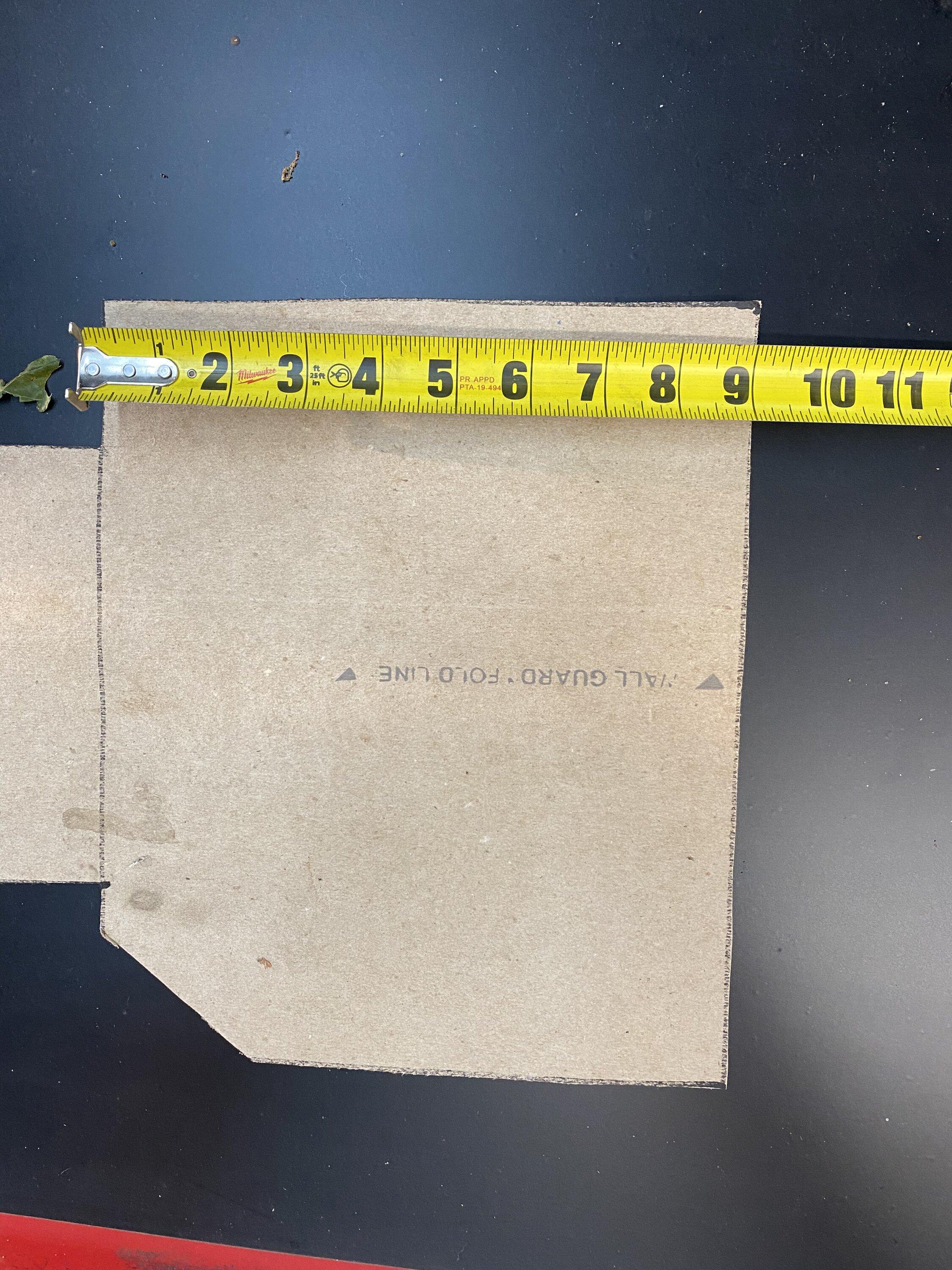

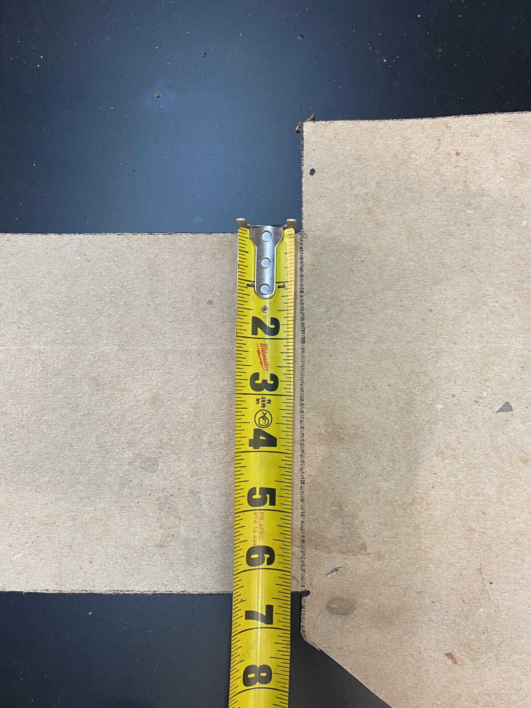

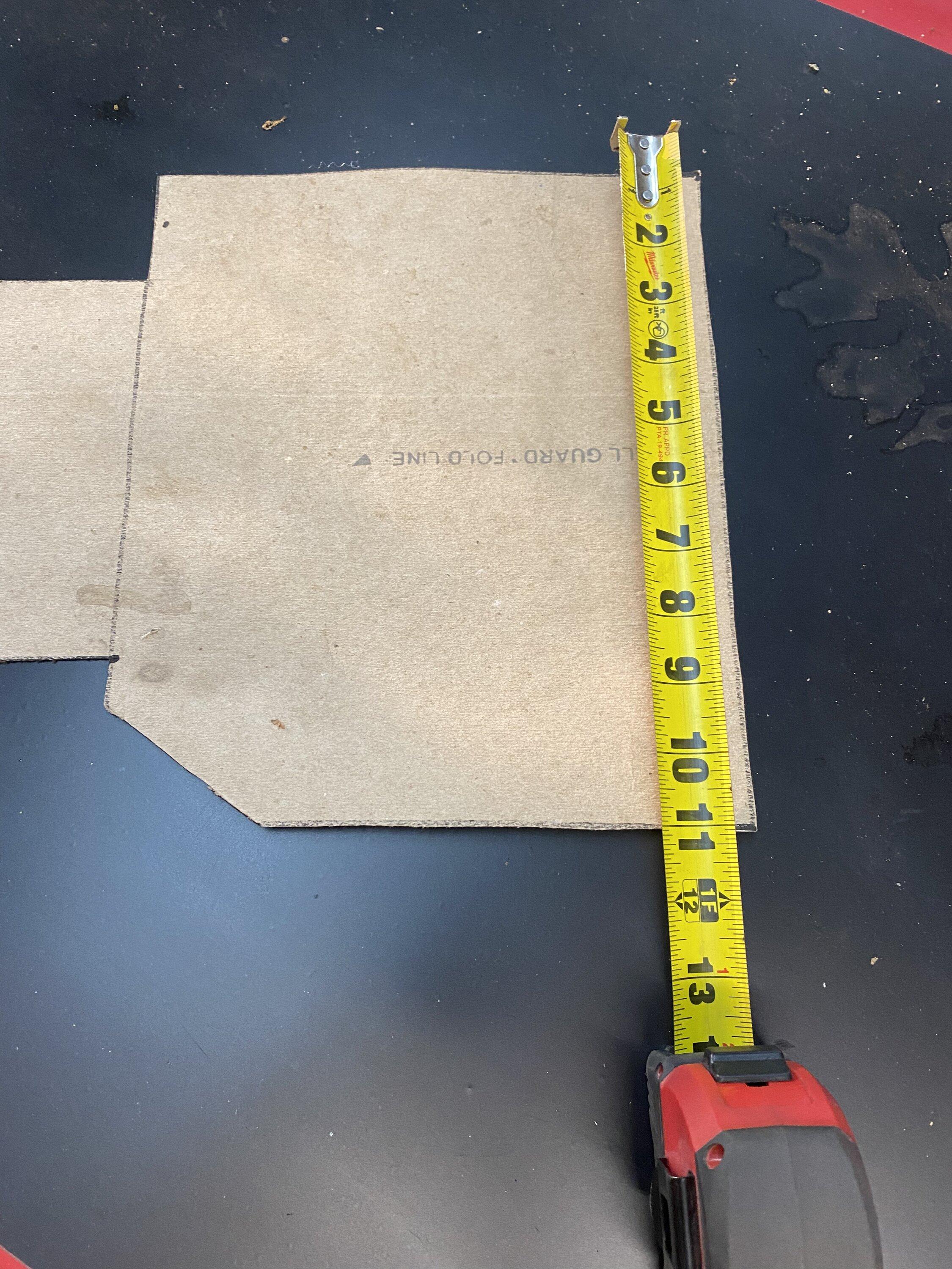

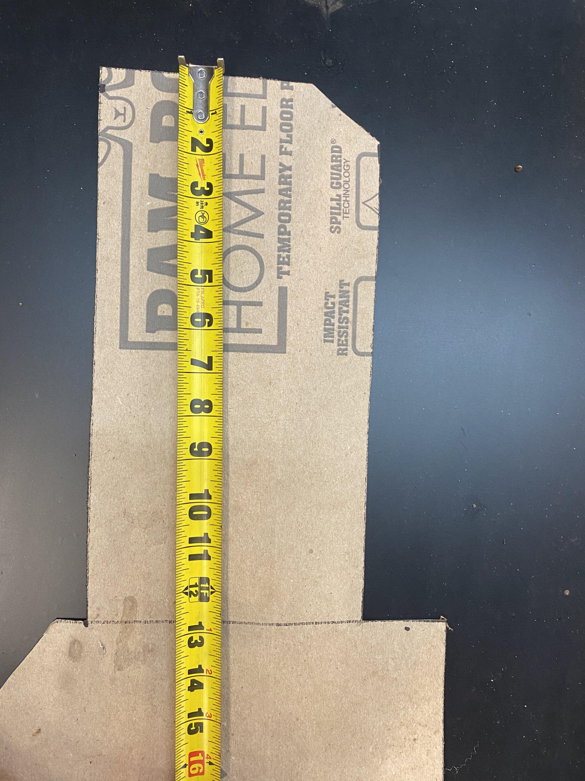

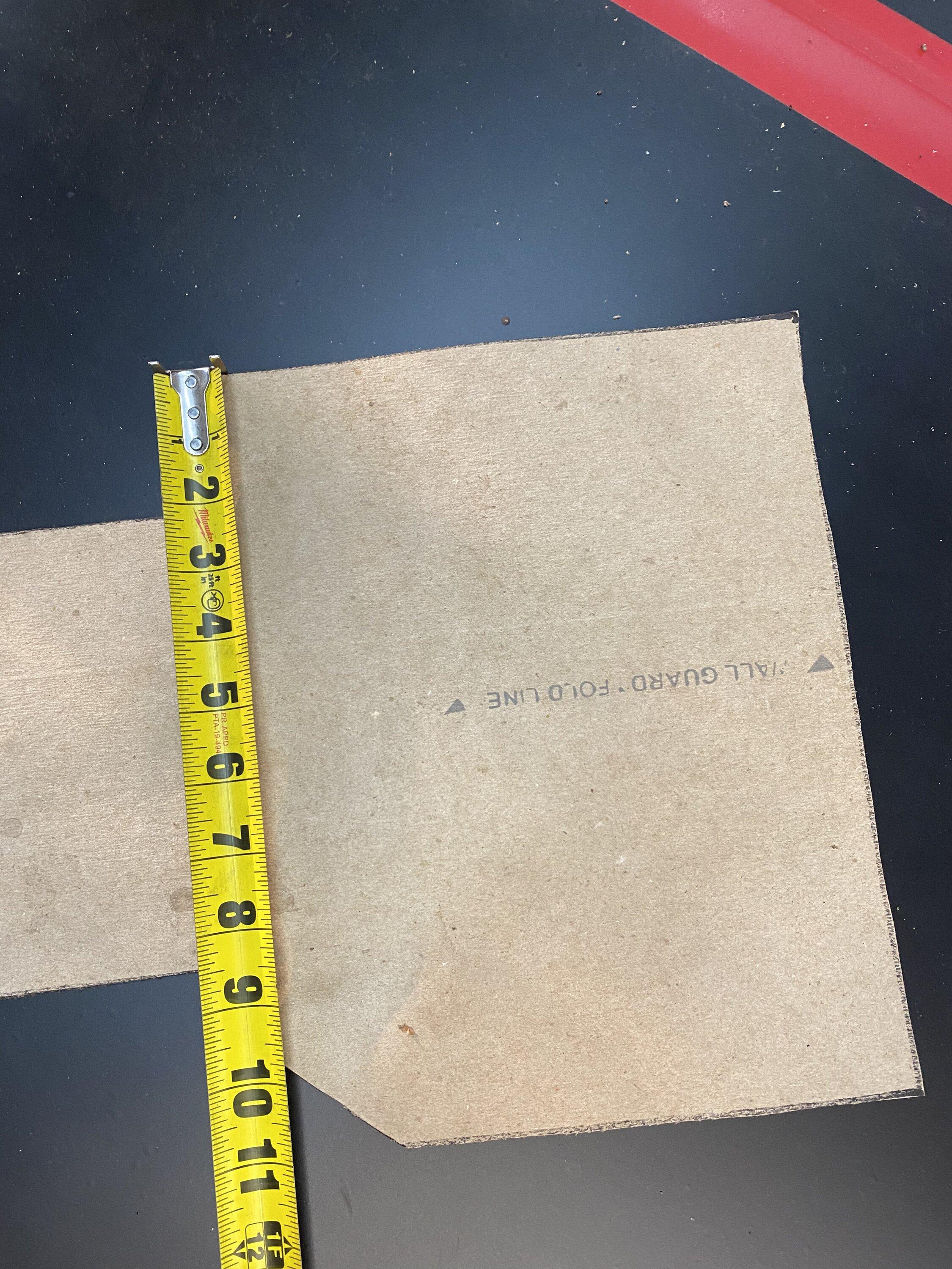

By chance you don't have the measurements of the boards you mounted the amp and loc on do you? I'm still waiting on my bronco to get built but want to start building my own sub box. I think I've got my template measurements close from looking at pictures but would like to make sure. I'm going to put it where the b&o sub is.

Thanks. Yeah…I’ll post them here in an hour or so. I used chip board to template the shape and then transferred to 3/4 mdf. I made the bottom support angle from flat bar and the top brace is a piece of angle iron cut down on my band saw.

@kreuselh. Here you go. Take note you will have to remove the storage cubby to make room for the amp panel. I plan to form some metal speaker mesh to cover the opening.

Thank you. I really appreciate it.
