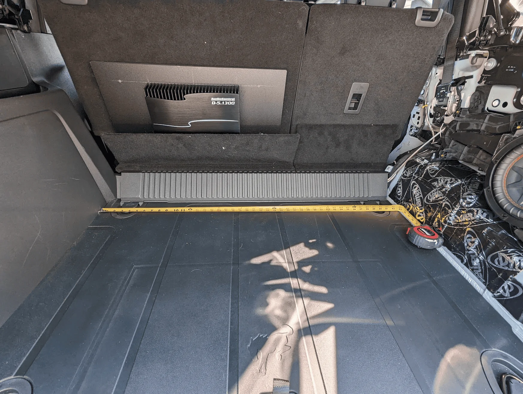

under the steering wheel for the front amp and over one of the wheel wells for the rear.

I was lazy and did what I've always done, mounted the amp to the sub box ;)
