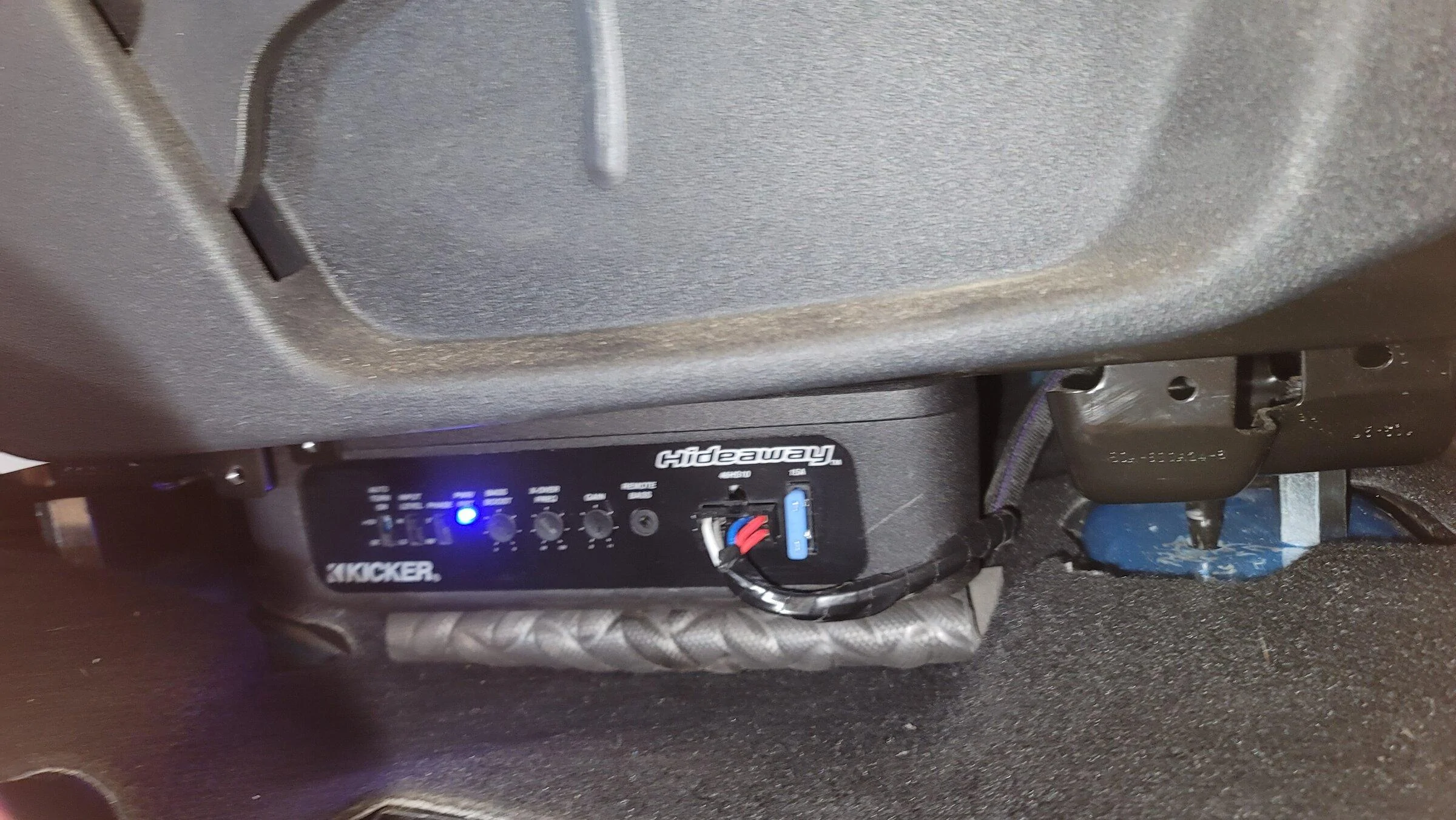

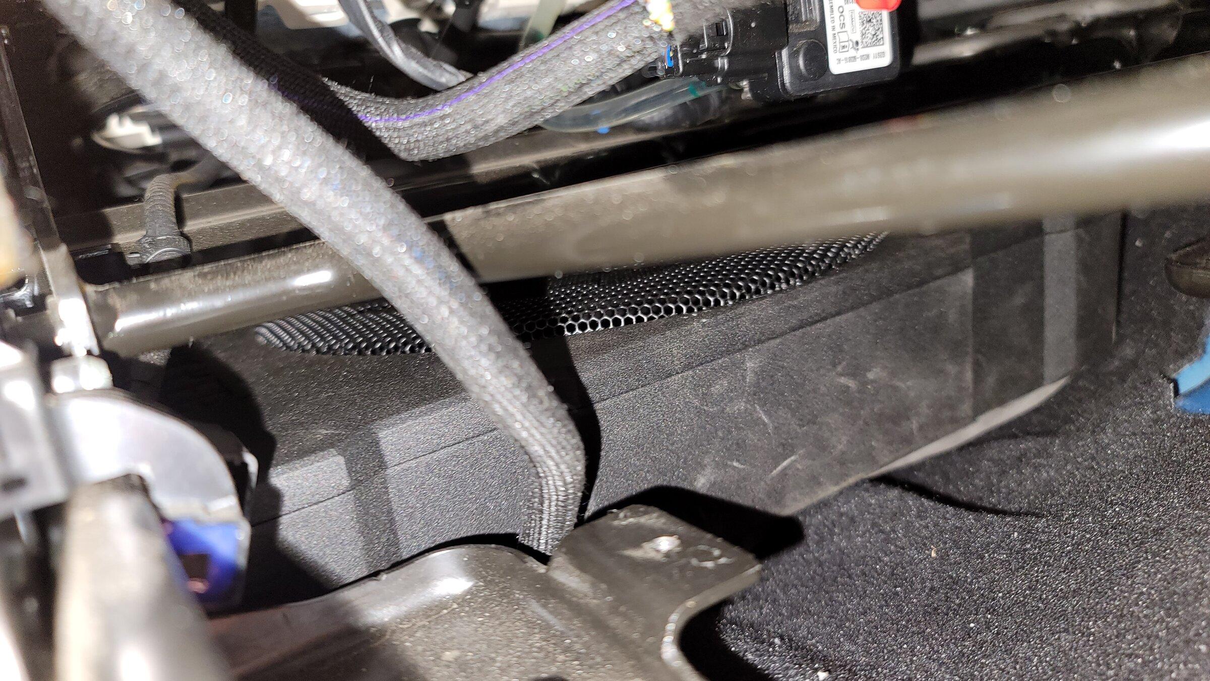

In my 2dr I just squeezed in a kicker 10 " hideaway in under the passenger front seat.. I needed it since I removed the OEM sub. I HAD TO RAISE THE SEAT 1", which is OK because the seat has some height adjustment bult-in. My space is very limited now inside the half-cab so I need this type of hidden setup to keep waisted space to a minimum.
It don't move enough air to sound like a true 10" in a box of course but it does hit good on the lower frequencies.
Good bass overall, I like it so much I'll likely add another under the other seat, and I think the two hidden ones will sound close to a real 10 in a box. šŸ˜†

How’d you end up securing that puppy?

How bad or noticeable is the vibration for person sitting in seat?
Well my wife likes it .🤭..I don't sit there often enough to give feedback. However it sounds so nice and hits the deep low note we'll, so I ordered another to get just a bit more volume and equalize the bass in the cabin. Also I'm adding 2 JL 6.5 subs and soundstream amp , for the kick panel speakers, well see how that works next week.

What’d you attach it to? Right through the floor or?
Yes it's bolted to the floor...I ordered a second one for the drivers side too and a roll of dynamat, so I'll pull the 1st one out and dynamat the floor before re-install the pair of them next week. I'll get some pictures of the install if you want?

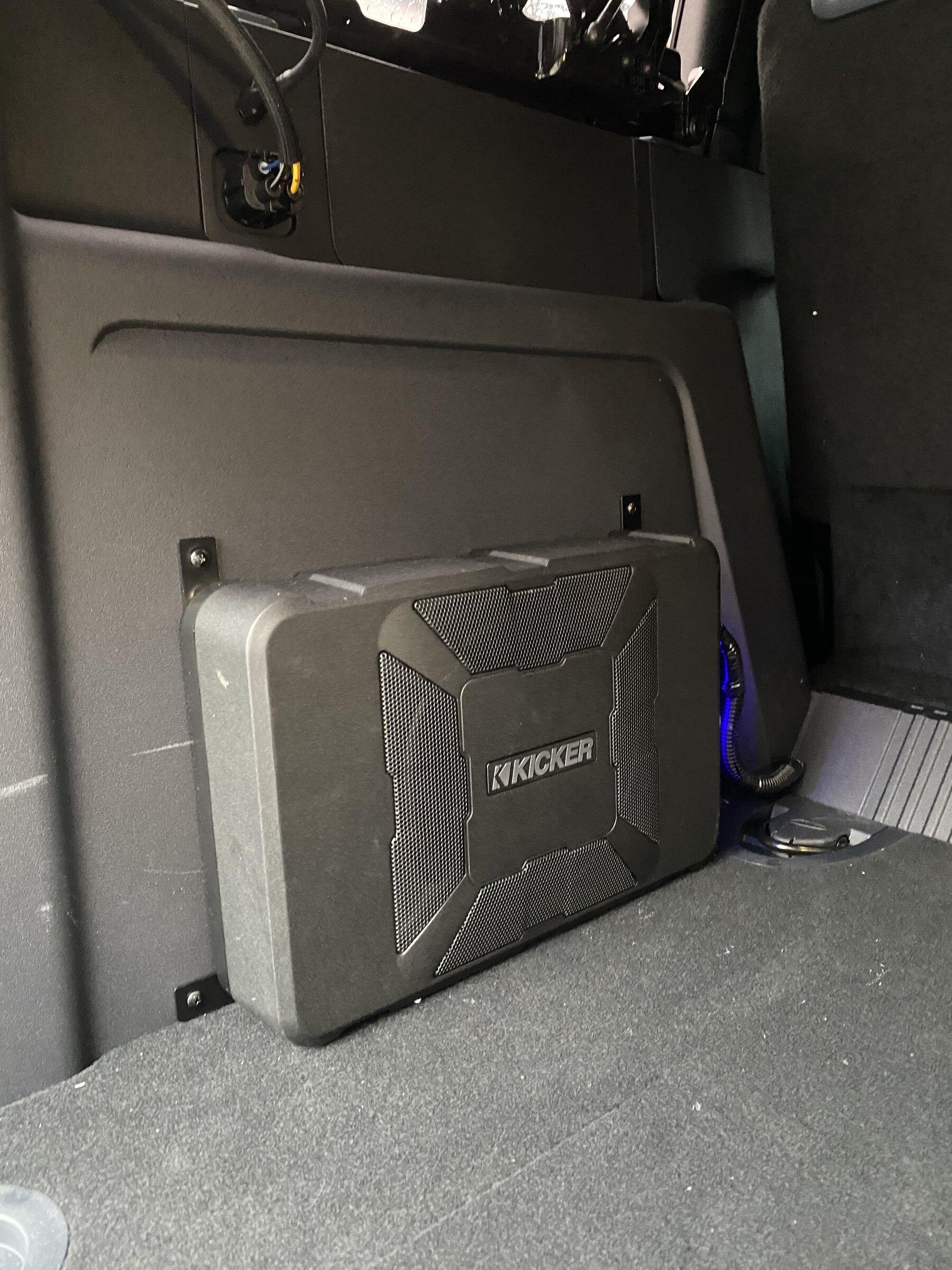

I used this sub in my upgrade. I have it installed on the driver’s side panel in the back storage area. It doesn’t take up much room. It will rattle a bit when I turn the base up too much but I have an adjustment knob by my right leg on the console and can quickly adjust. I’m also planning to put some poly fill behind the panel if/when the rattle bugs me more. As it is I just figure it reminds me that I have the bass and sound too high. :) I used Kicker CS 4ā€ and 6ā€ to replace the two dash speakers, pod speakers and kick panel speakers. Stuffed poly fill behind all of them. It sounds incredible and louder than I’d ever need. The highest I’ve turned it up is 18 with the top down, windows open at 65-70mph. It doesn’t sound good with it the sun.
P.S. - The sub would not fit under the rear seats and allow them to fold down. Nor would it have adequate air space
