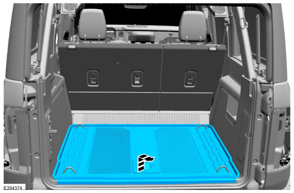

Loadspace Trim Panel - 5-Door
Special Tool(s) / General Equipment
Interior Trim Remover
Removal
NOTE:
Removal steps in this procedure may contain installation details.

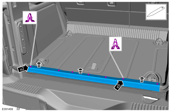

  1. Remove the rear scuff plate trim panel.
    Refer to: Rear Scuff Plate Trim Panel (501-05 Interior Trim and Ornamentation, Removal and Installation).
  1. Remove the load compartment floor covering mat.
Ford Bronco {thread} {filename}

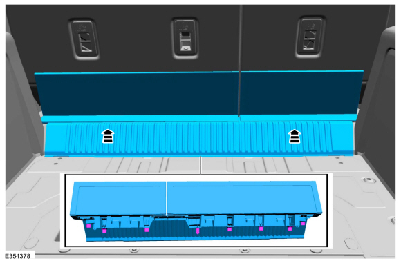

  1. Release the clips and remove the loadspace scuff plate trim panel.
    Use the General Equipment: Interior Trim Remover

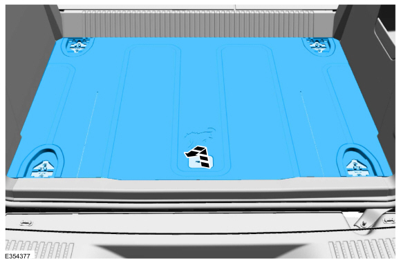

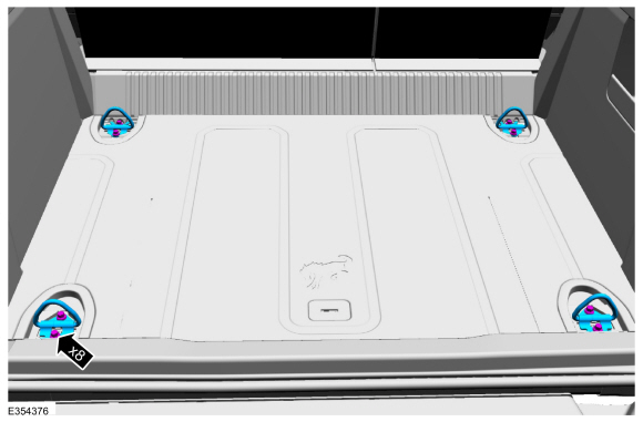

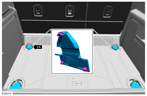

  1. Remove the load compartment floor covering tie down covers.
  1. Remove the bolts and the load compartment floor covering tie downs.
    Torque: 21 lb.ft (28 Nm)
  1. Remove the load compartment floor covering.

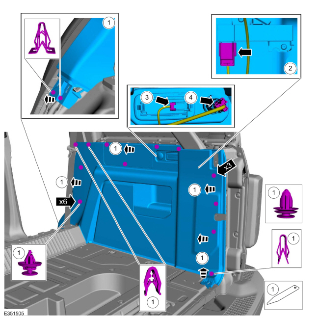

Left hand side
  1. NOTE: Seats removed for clarity.
    Remove the loadspace trim panel.
    1. Release the clips.
    1. Disconnect the PATS rear antenna electrical connector.

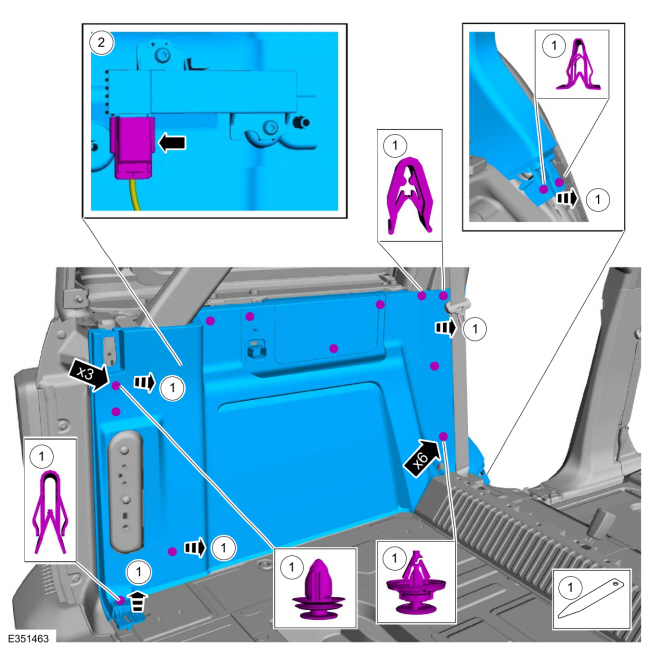

Right hand side
    1. Disconnect the loadspace interior rear light electrical connector.
    1. Disconnect the power point electrical connector.
Ford Bronco Sound System Upgrade Question Hel
