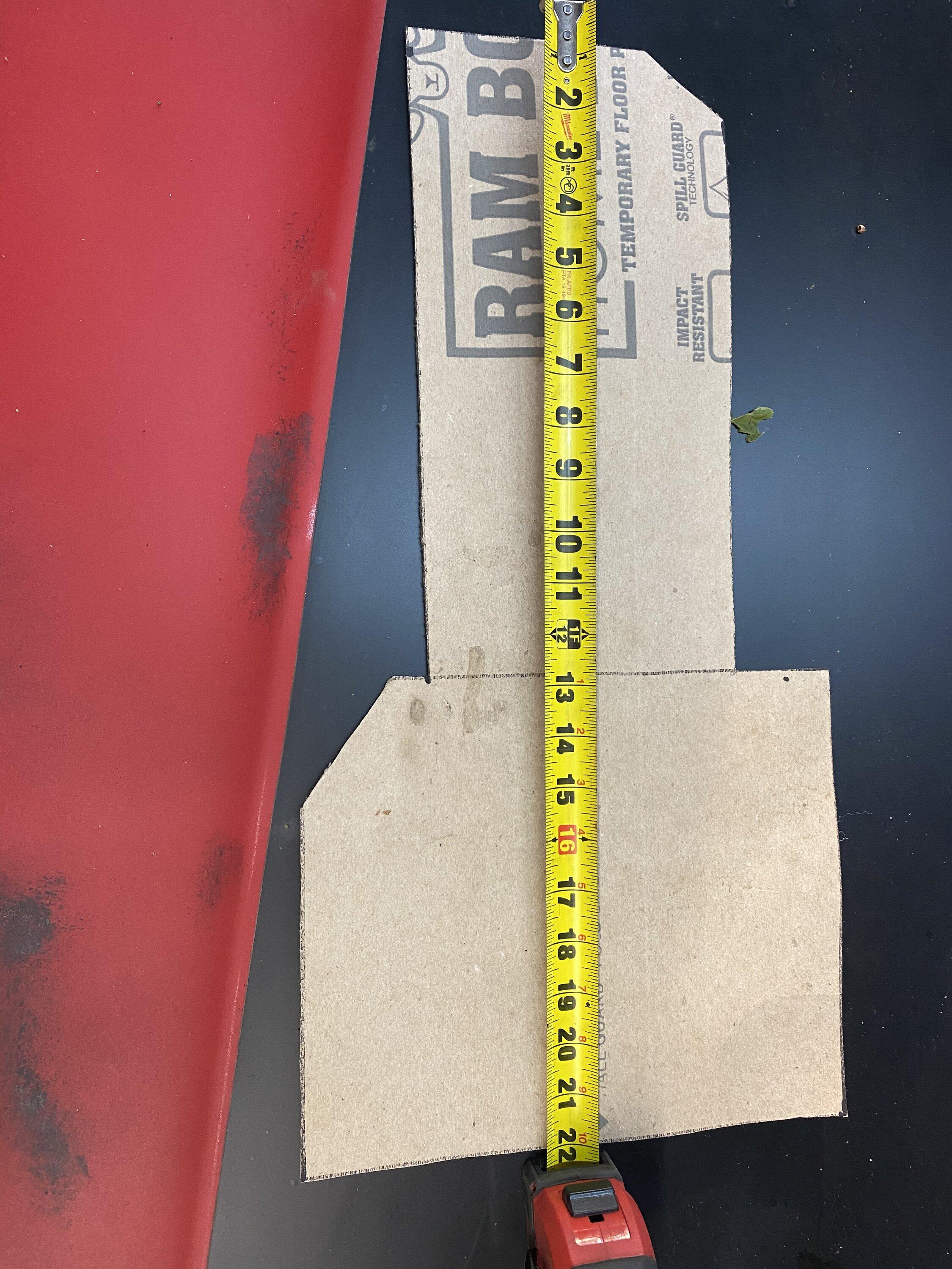

@kreuselh. Here you go. Take note you will have to remove the storage cubby to make room for the amp panel. I plan to form some metal speaker mesh to cover the opening.

@kreuselh missed the overall length pic. Here it is.
Thanks. This verifies what I came up with. Getting a Wikdtrak with the B&O system but heard about all the rattling problems with the B&O sub decided to make my own box. Going to put the amp and dsp in the we'll in the middle of the cargo area. Pretty much going try to keep everything concealed as much as possible. Did you have to use any load generating devices?

Hartford, AL
No load devices were needed. Sounds like a plan.

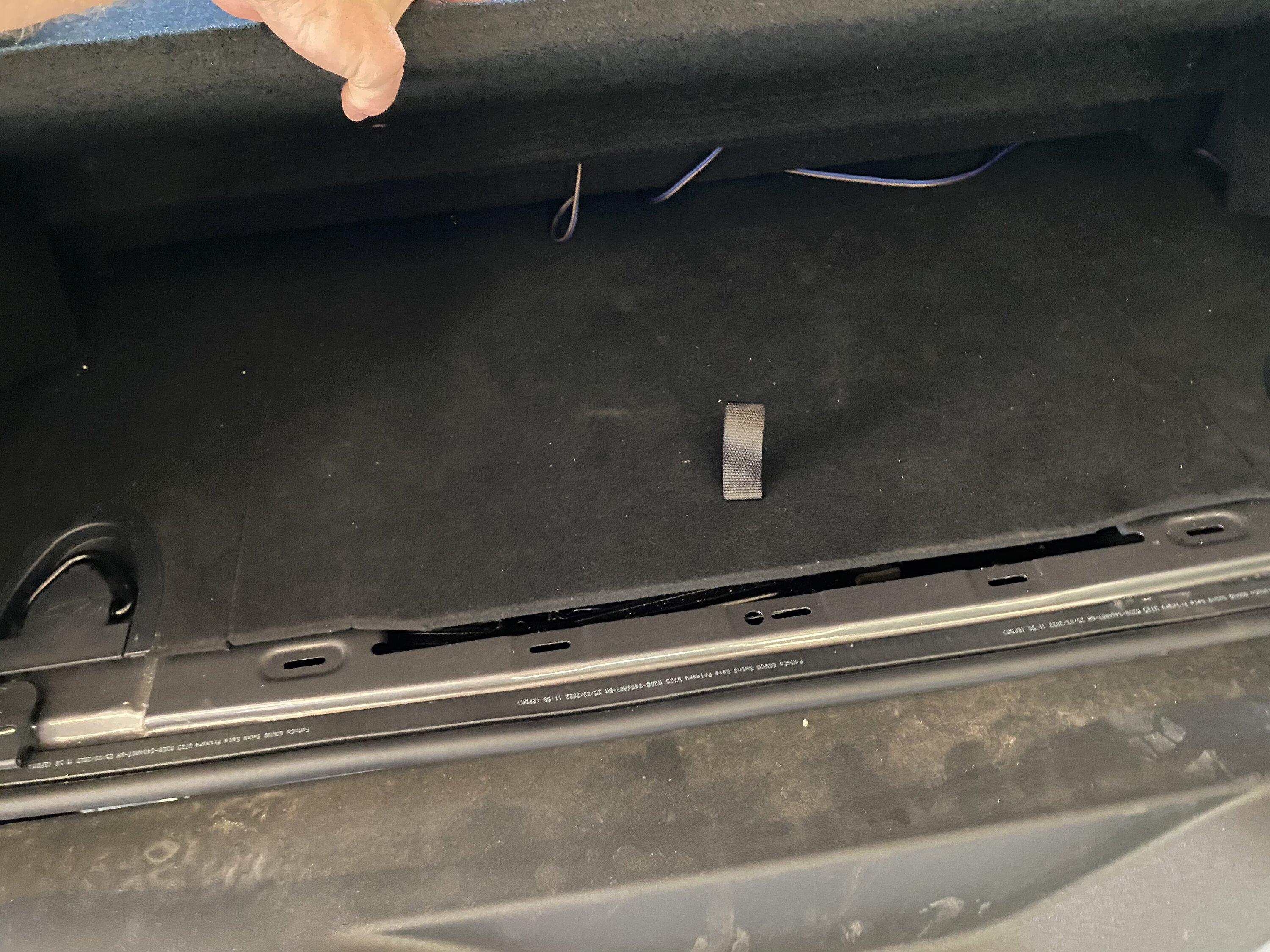

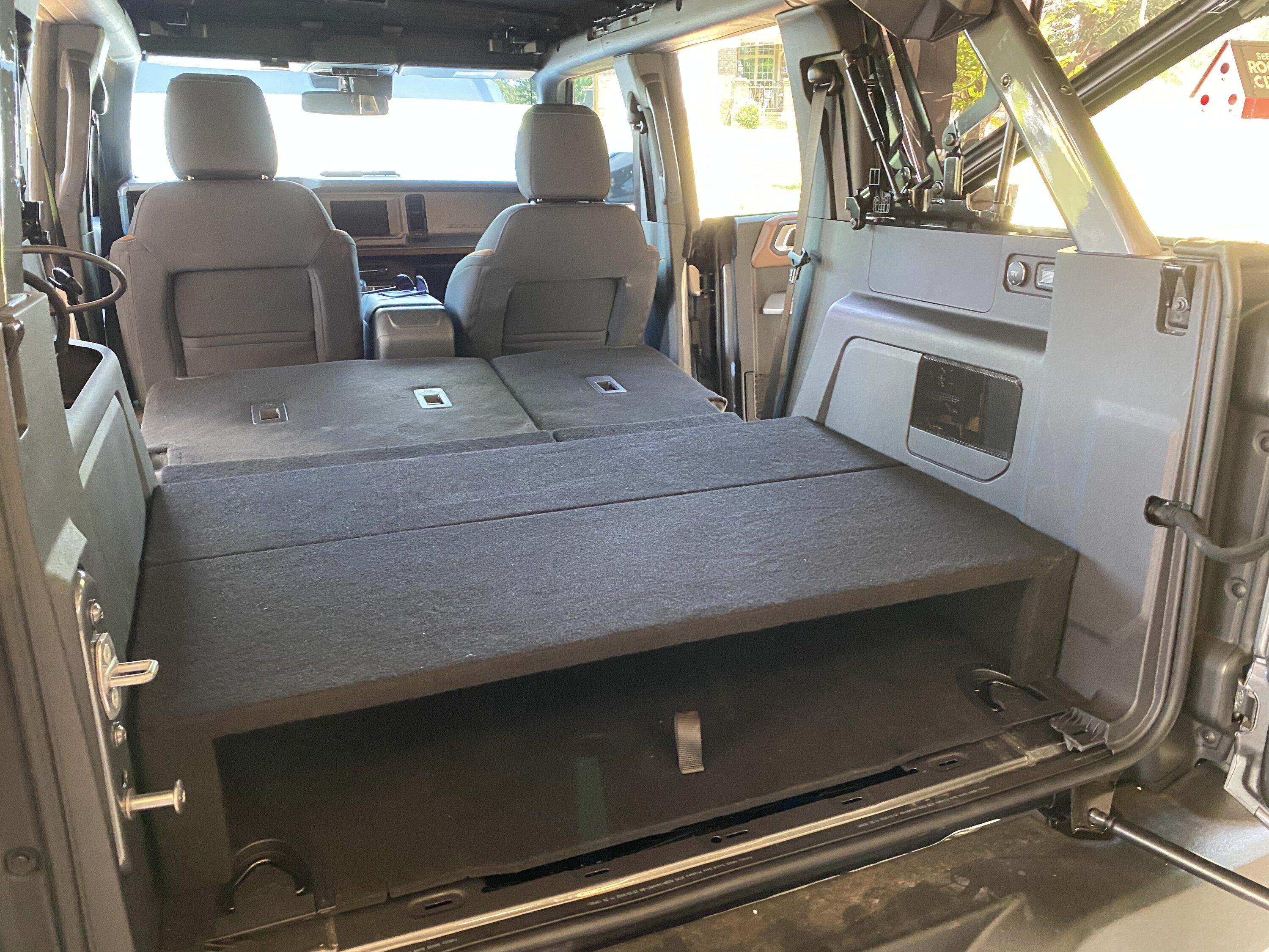

Some updated final install pictures with all panels back in. I added another section that I can store things under, but also levels the storage space. Also, removed the cubby and added mesh since the cubby doesn’t allow clearance for the amp behind the panel.
