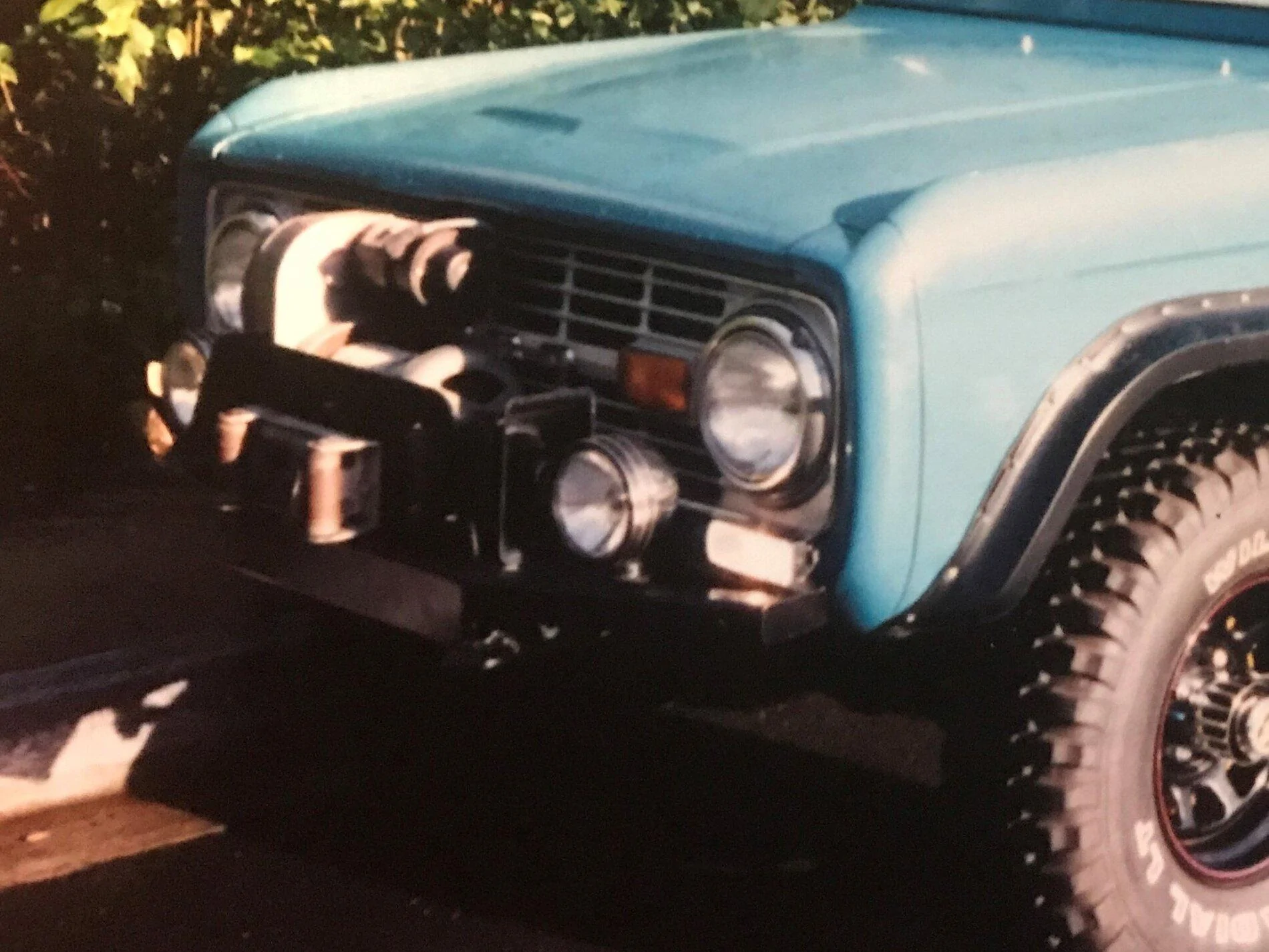

Short answer, nope. I like the looks and function of it, and it even looks kinda like the one I had on my old Bronco.
I am looking forward to someone coming up with the hidden winch mount similar to the Rough Country, just for the mod bumper and a little beefier. I think the hidden mount is the best compromise to keep all the sensors and cameras in play as designed and carry the added weight lower and close to the front axle.
My old bumper with the old Warn Bellview was stout, the wings were 2" square stock, and once done made the front of the Bronco heavy and bob down the road, even with the dual front shocks. The bobbing got better once I got the HD rear bumper and tire carrier done to balance it out a bit.
