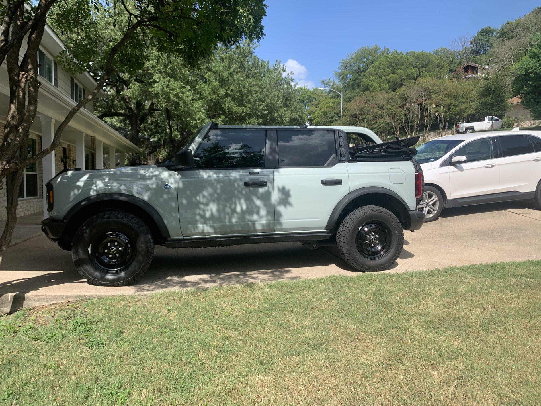

If it’s hot like it is in austin it doesn’t turn off

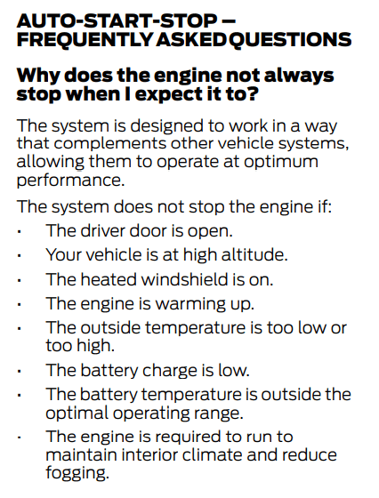

Auto start stop suddenly stopped working on my Bronco and hasn't worked in a couple of weeks. It doesn't show any error messages. Should I be happy? or worried?
I think it may have stopped working when I had my doors off for a while. But it's not working with the doors on either.
I searched to see if anyone else's stopped working. I noticed yesterday that mine was no longer working. Would be nice to know why it stopped working.

Any of these conditions apply? Page 165 in the manual.

Thanks! The only thing on this list could be the temp is too high. But, it's been hot in TX since I picked it up from the dealer last month and it was working until a couple days ago.
