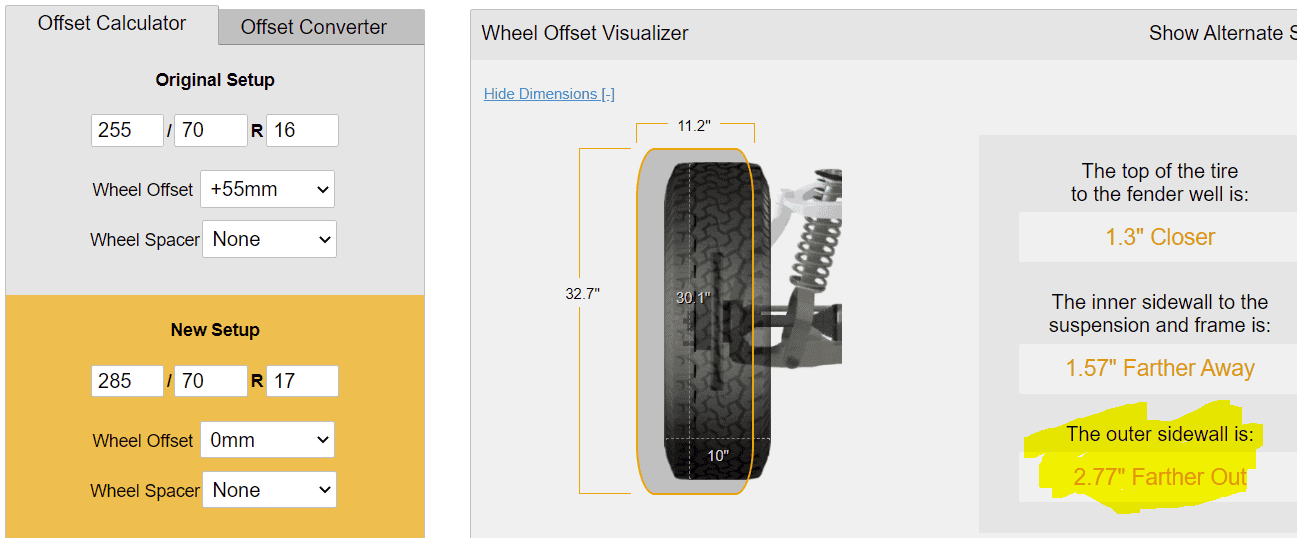

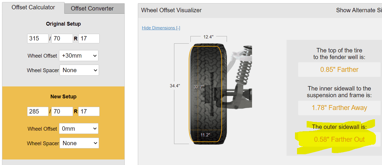

Here's what you had, and went to:

And here's your new set up compared to Squatch:
Ford Bronco Base Bronco on 33" KO2 tires & 17" Method 701 wheels 1627063268911
So you could actually run wider Squatch flares, and still have some poke
