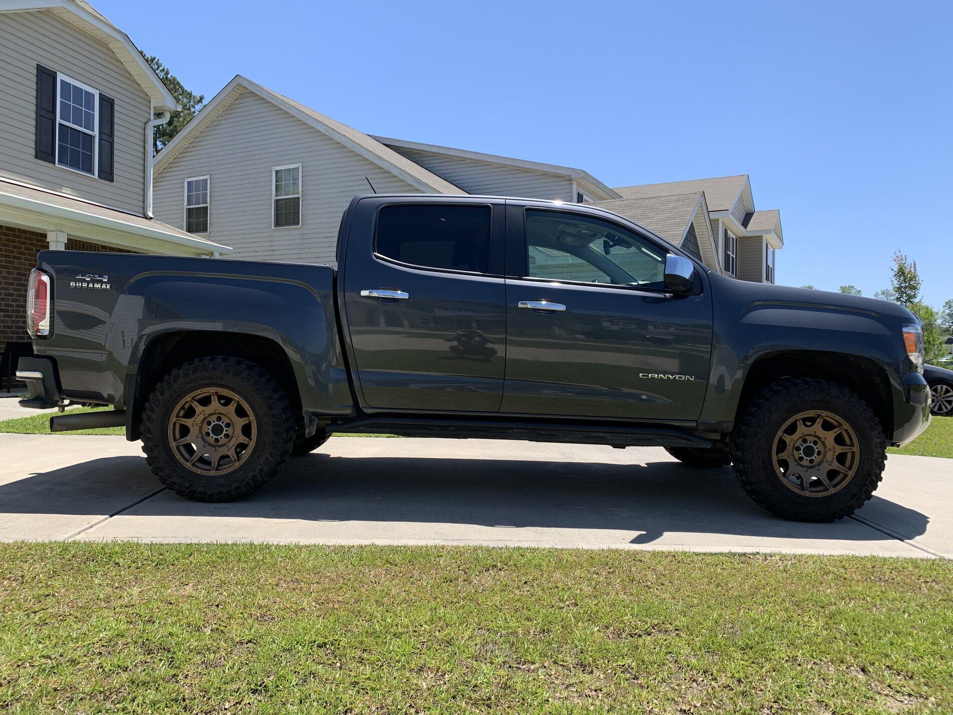

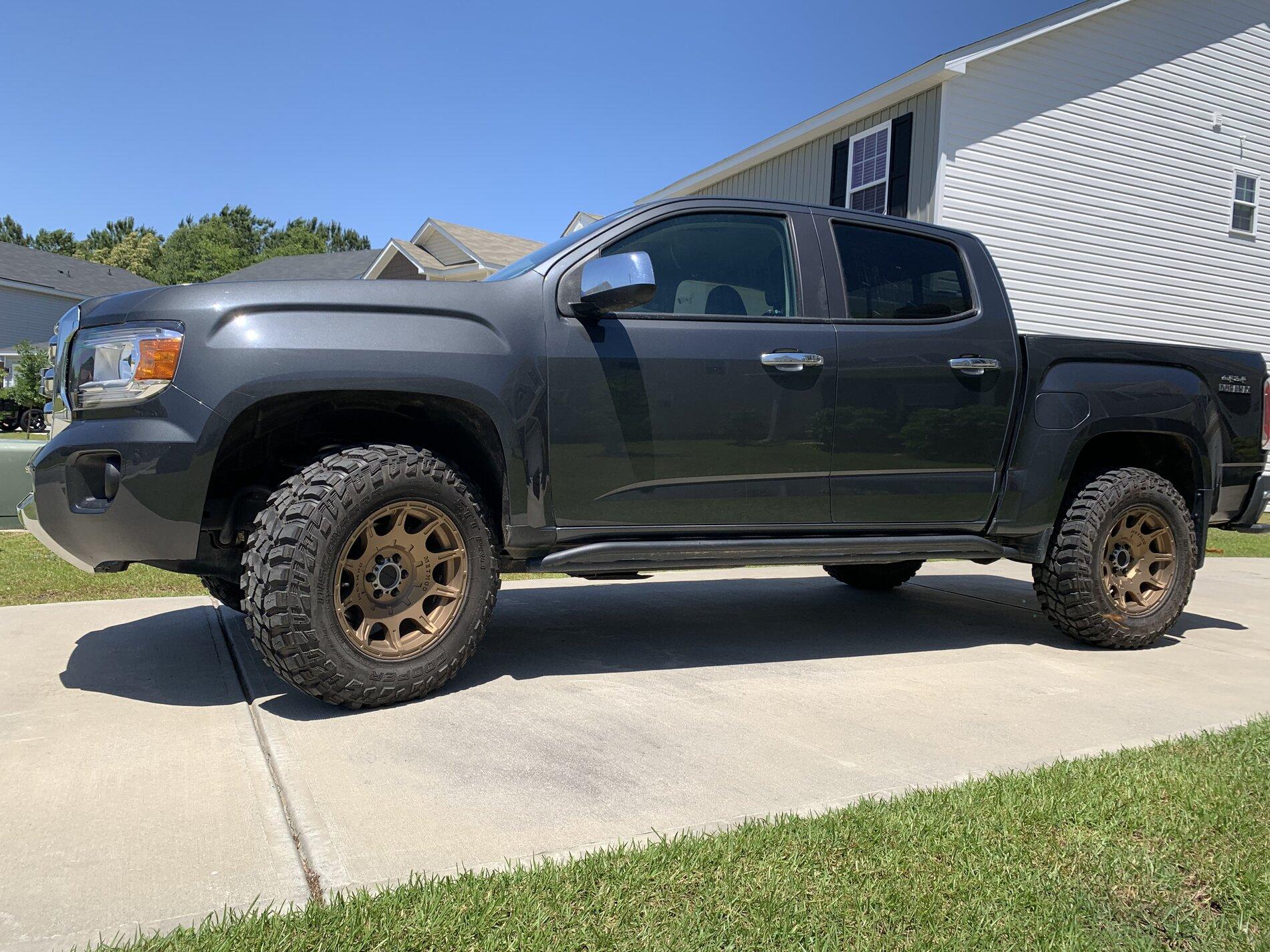

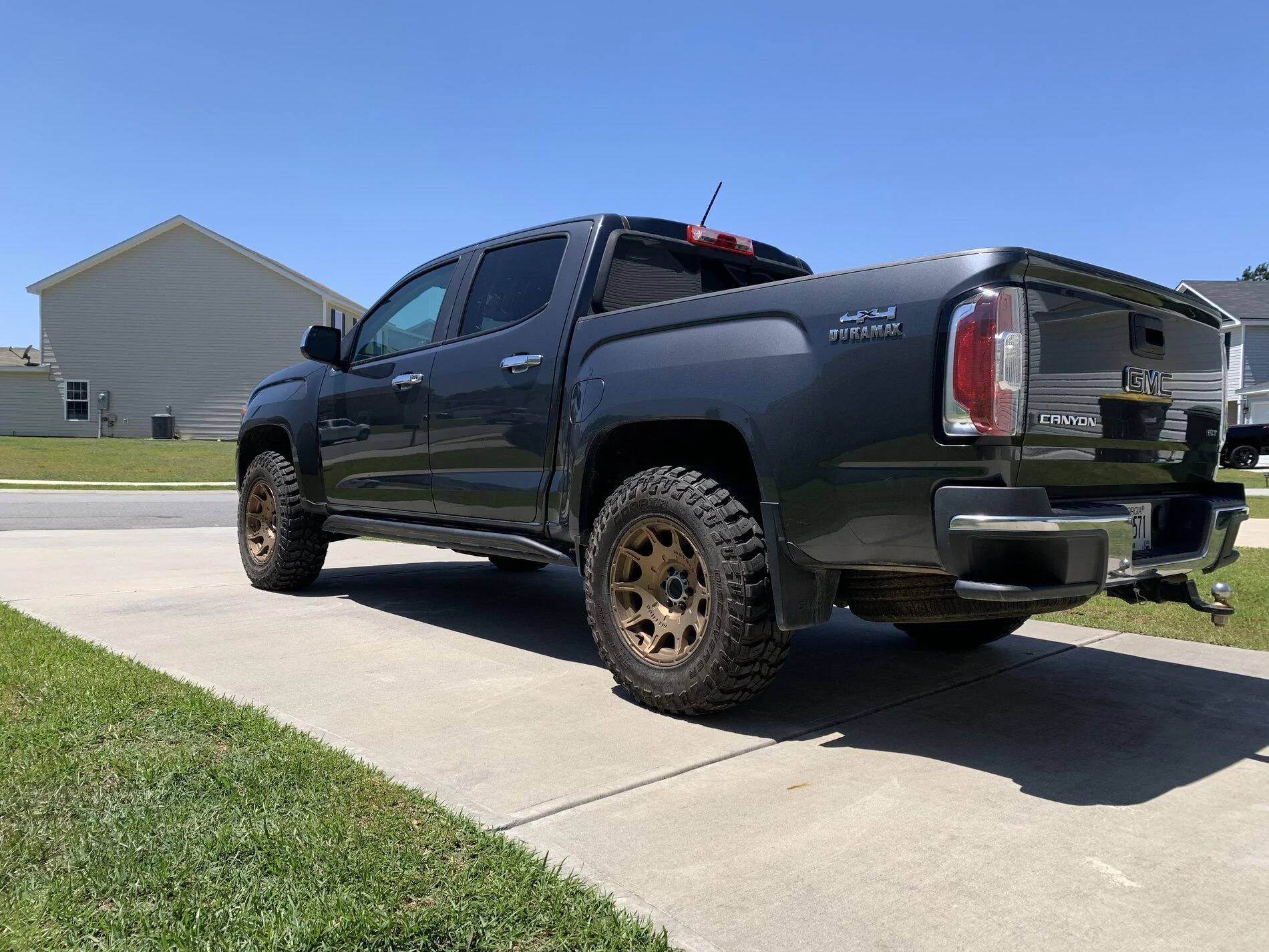

Same color combo as my truck!! Bronze on gray is a really underrated color combo. I only wish the Colorado/Canyon twins has the same bolt pattern, otherwise I’d keep these wheels for sure to put on my Bronco. It probably also would have made me reconsider color choice from Cactus Gray to either Carbonized Gray, white, or black.
