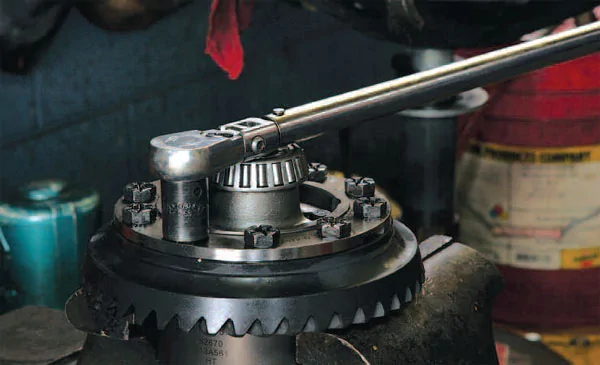

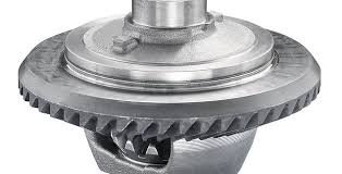

The basic configuration of the differential is same as it ever was. As you noted, this is similar to a conventional arrangement, where there's a ring gear attached to the diff case, and inside the diff case, spider gears mounted on cross-shaft are used to drive side gears that in turn, rotate the axle shafts. So, torque is transferred from the ring gear to the diff casing, then from the casing to the spider gears, and then through the side gears to the axle shafts. None of that changes. What has changed is simply the method of how the ring gear is attached to the diff casing.
Ford Bronco Base Model Rear Locking Differential 36_6
This is a representative image that I found on google. Basically, instead of having those bolts that are shown here being torqued down, there is a weld where the flange (which is shiny here) and the ring gear (which is dark colored) are butted together. Looks like this (this image comes from EMAG, manufacturer of laser weld machines):
Ford Bronco Base Model Rear Locking Differential Nd9GcSxX2UYpr11Idf-h3YJyh62wsdxXiSWke4kfA&usqp=CAU
That is what is different between the open and locking versions of the Ranger & Bronco axles.

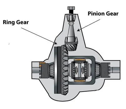

OK, so when the ring gear is welded to the diff case, it is a permanent fixture on that diff. So, to install another differential, you also need another ring gear too. I found this image, again, on google:
Ford Bronco Base Model Rear Locking Differential ring-pinion-gears
The catch here is that the ring & pinion gears are matched sets (at least normally). They're married for life. So, not only do you have to replace the ring to facilitate the diff swap, you also have to replace the pinion, because they're a set. What's more, installing a fresh ring & pinion set requires proper set up to get the meshing correct. This is done typically with shims under the pinion head and shims next to the diff case bearings, and the process to do it requires a bit of experience and skill.
So, that makes the swap a bit more complicated and costly then just a simple diff swap would normally be.
