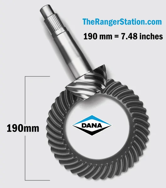

Okay, it appears that the base has a Dana 44 housing and 210mm diameter gears with presumably strong axles for the rear and a front with 190mm diameter gears with hopefully? strong enough axles.
With the rear being a solid axle and bigger components I'm confident with putting a LSD in that though the weaker front makes me wonder why it is not the same as the rear or if an LSD might hurt it. Also, would a Torsen fit in an IRS front? Is it basically a Dana pumpkin like the rear, just smaller, but with hinged axles?
The (rear) IRS in the Cobra Mustangs would break sometimes with even drag radials. I'm wondering what the weak link would be. My guess is the cv front axles /housing /connection points though I have no idea what I'm talking about.
