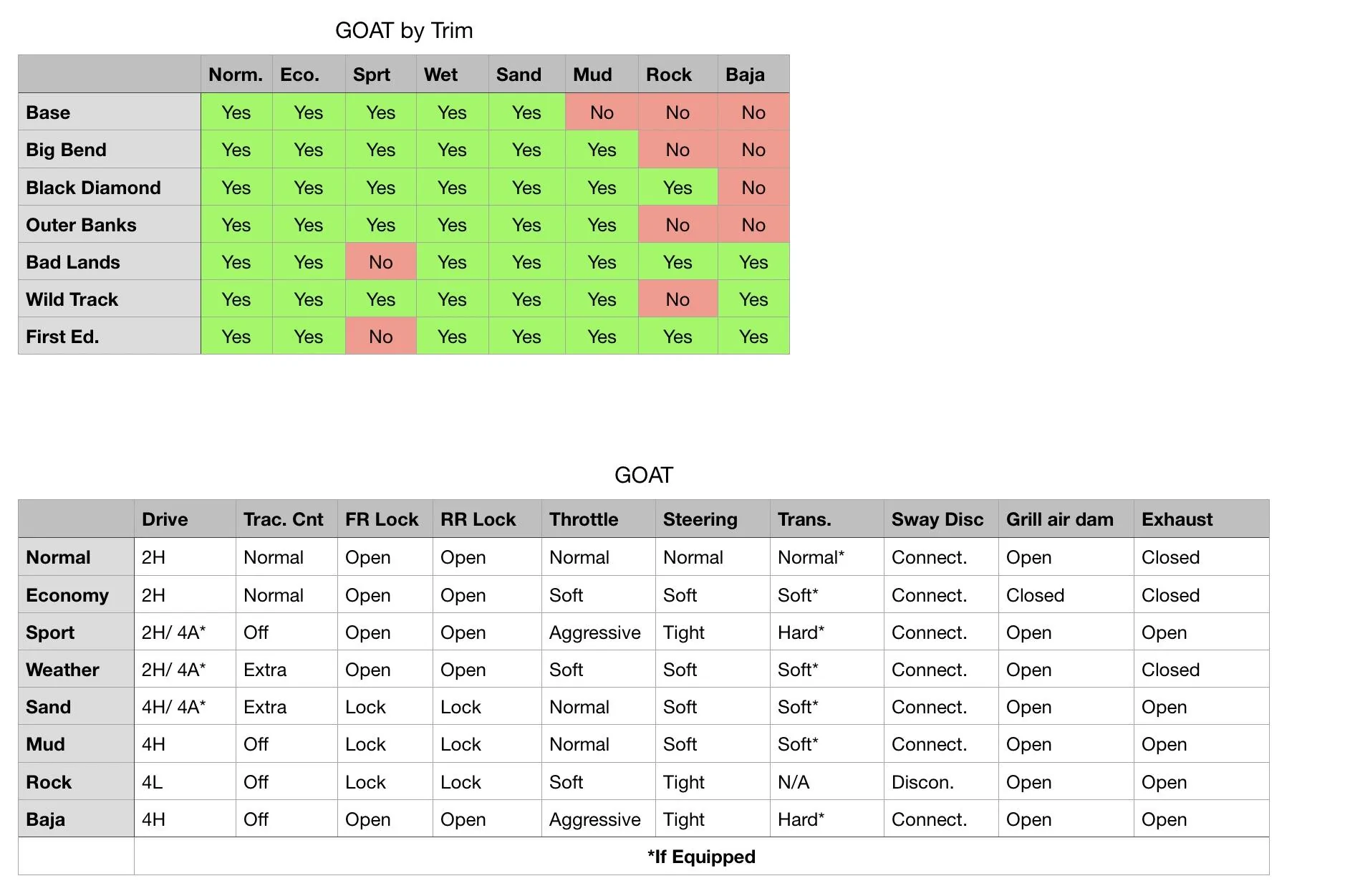

I have this mode available but have open differentials and no stabilizer bar disconnect. What does it do exactly?

Likely changes shift points (if automatic transmission), throttle pedal vs. torque mapping, and maybe traction and stability control thresholds for control.

Although I think the 2nd table here is a combination of based on F-150 Raptor and speculation, it gives some idea of what things are/may be adjusted by the mode settings.

Bottom chart is what it does, if your rig isn't equipped it doesn't do that thing.
Link.
I wonder if the brake differential lock changes between the modes at all.
Aka when each corner's brake is engaged to mimic a locker.
Toyota's do this.

Good question. I'd like Ford to be upfront about all of this. Many of us "know" and care about such details of implemented software.
Ford Bronco Big Bend Mud/Ruts G.O.A.T. Mode 392f297d-45da-476e-88b5-ed8777a6dd26-jpeg-
Very conclusive, thanks. So softer ride and steering and an exhaust note difference. Traction control is disabled by default, so I don't have to push that other button thingie.
Exactly the opposite... Please read my post a couple above the post of that table. I linked to it along with caveats/cautions.
What I mean is that, based on this information, there is no reason to focus on the mud/ruts mode from my perspective.
