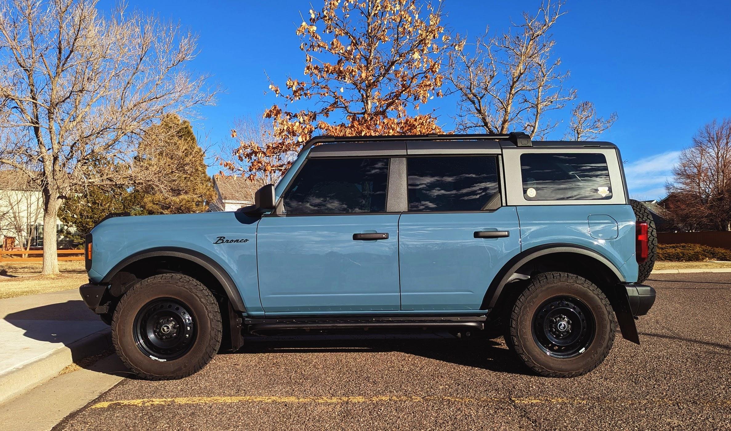

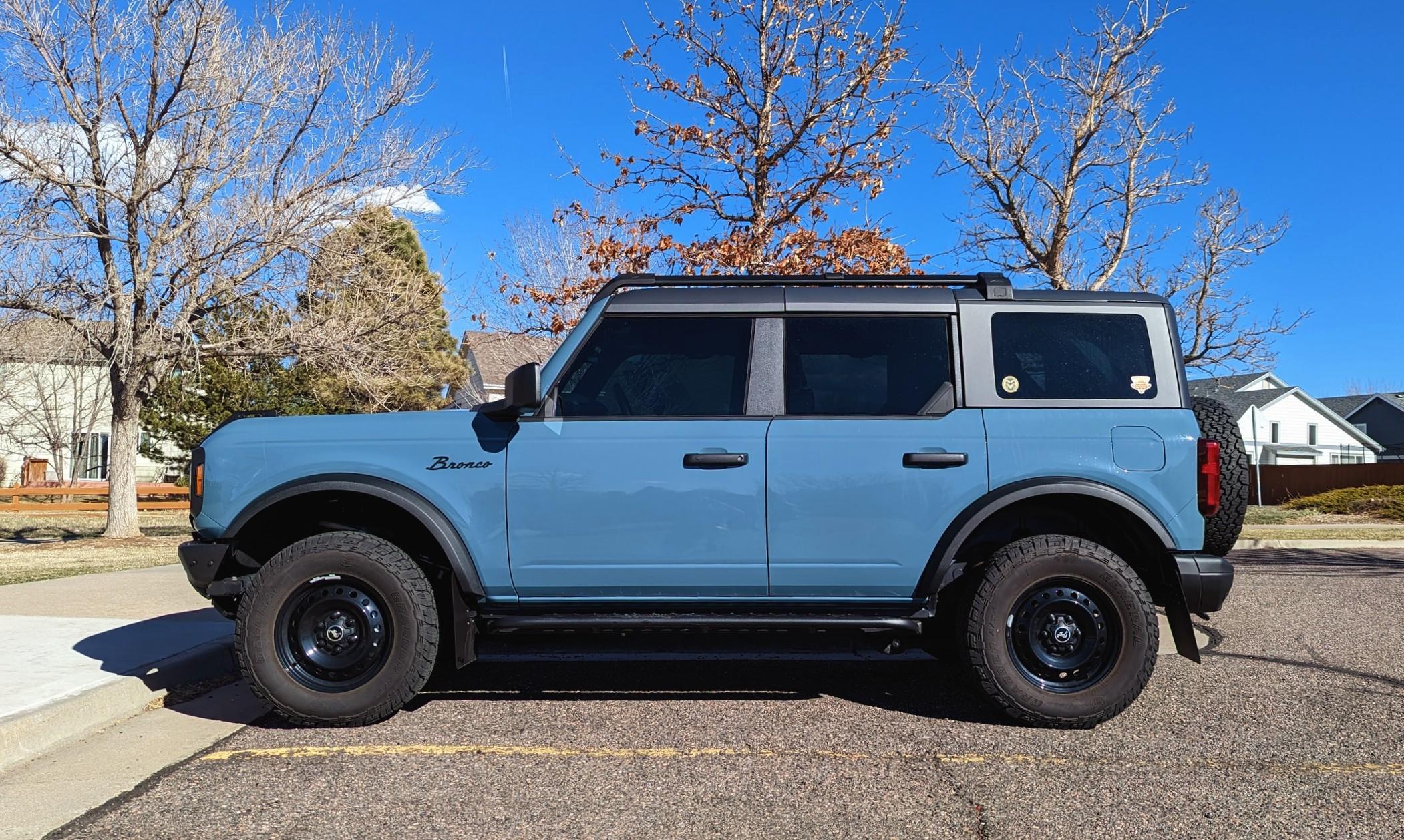

Before and After Side shot:
Ford Bronco Black Diamond Hitachi to Non-Sasquatch Badlands Bilstein Swap Impressions Comparo 1 (1)
Ford Bronco Black Diamond Hitachi to Non-Sasquatch Badlands Bilstein Swap Impressions Comparo 1 (4)

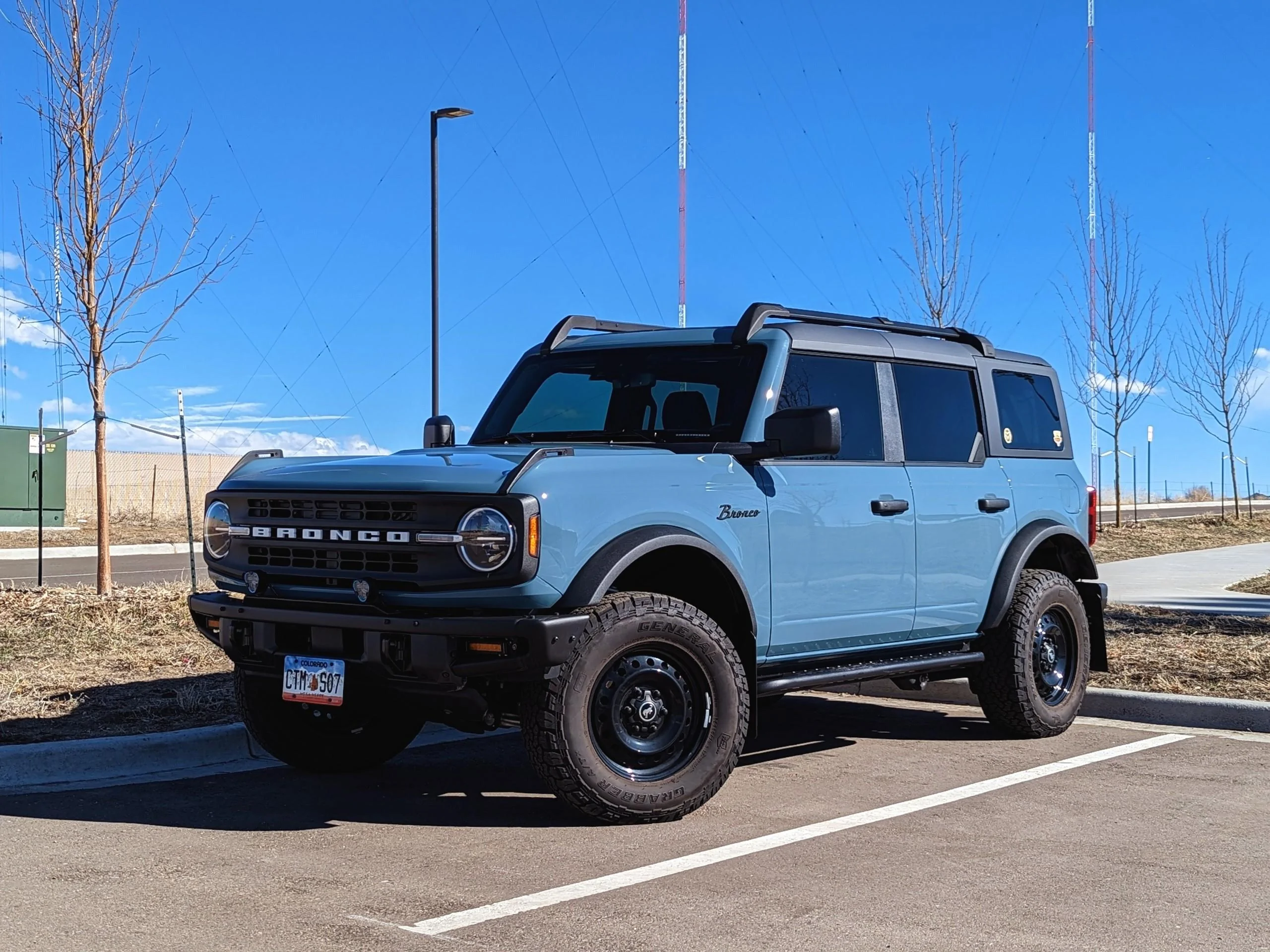

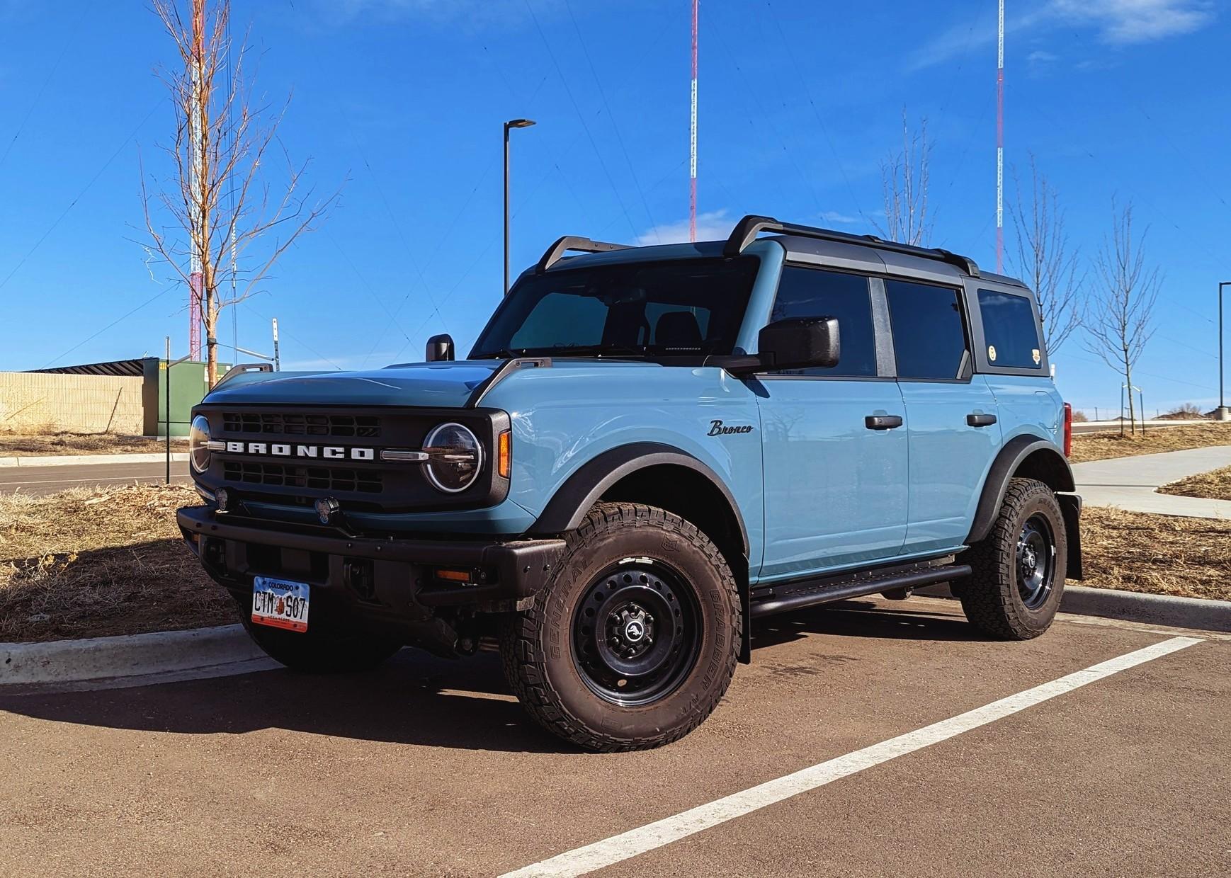

Front 3/4 view Before and After:
Ford Bronco Black Diamond Hitachi to Non-Sasquatch Badlands Bilstein Swap Impressions Comparo 1 (2)
Ford Bronco Black Diamond Hitachi to Non-Sasquatch Badlands Bilstein Swap Impressions Comparo 1 (3)
Impressions:
- Ride control is much better. After now having the Bilsteins, the Hitachis were possibly underdampened. Huge improvement/reduction in bangs over road imperfections and the ride is much smoother overall.
- Highway ride is the city driving improvements, but to the next level. Much nicer for a long drive now.
- Noticeably less nose dive and more body control. Feels more "planted" while driving which has been a big bonus.
Yep, we're gonna ago with 33s or 34s when the Grabbers wear out as well, but they will have to do for now. But overall, If anyone is thinking about doing the swap, I wouldn't hesitate. I was looking for a simple upgrade to the Hitachis, and I am more than happy. I'll definitely report back with some off road impressions this summer as well, but I figured I would at least give everyone my initial impressions.

Interesting that the shock swap appeared to take away some or all of the "rake". My stock BL had the typical rake or stance before I lifted it.

rake reduction could be from the Bilsteins coming from a V6 or Auto bronco and this BD may not have both.
Yeah, still trying to figure it out, but I'm going to roll with it for a while.
Yeah, that's the odd part. It took me months to find this set that was off of a hardtop, V6 Badlands (most the sets available were coming off if 2.3s) so it would be most closely matched with mine. Only difference between the two vehicles (besides the model of course) is the tow package, and that doesn't make a difference in the shock or spring model numbers on the Badlands. Who knows. Since it doesn't have a noticeable "squat", I'm just gonna see if it changes over time.
