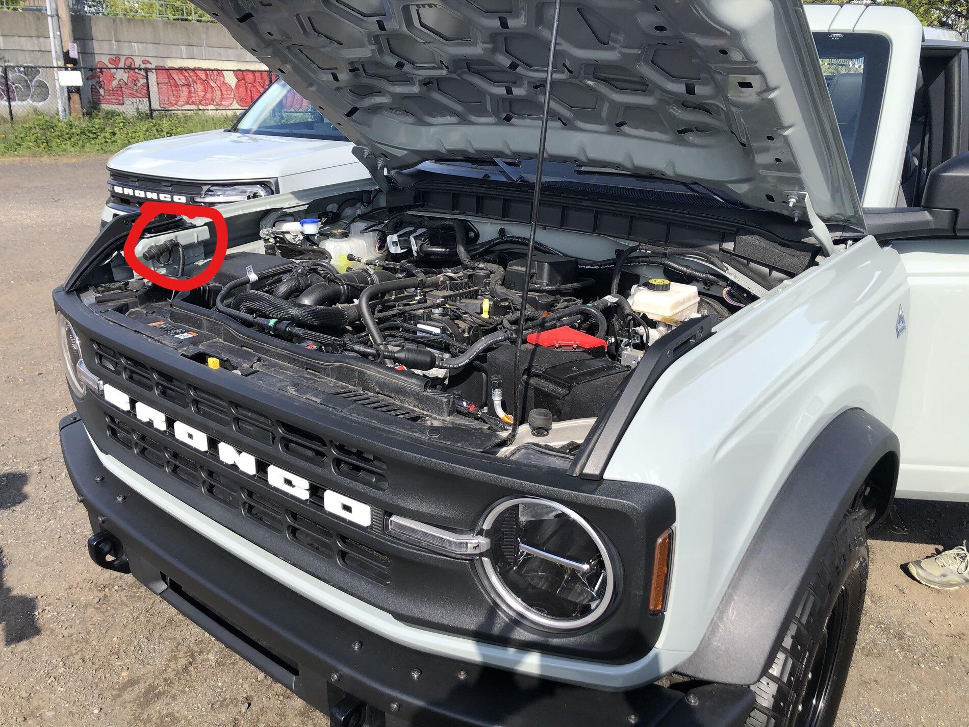

I'm guessing the block heater plug will come out of the bottom of the grill, but has anyone actually seen it?

Someone else posted pictures from a dealer event. I happened to notice this for the first time. Looks like the block heater plug
It looks like you're right. My F-150's plug comes out from behind the bumper, this location looks like you might have to pop the hood to use it. I'm not a fan.
I'm not a fan of the pop-the-hood to use the plug either. But a popped hood might be a reminder that it's plugged in so I don't forget and drive away.
I imagine a short extension could be rigged up in there.
That is a good point. I may have destroyed a few extension cords over the years when I drove off while still plugged-in.

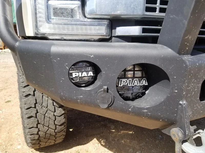

I've noticed on newer vehicles the cords come coiled up near the battery. I live in a cold climate and work in even colder some times. I also add a battery heater/blanket and silicon pad heaters on the oil pan and trans pan, if an auto.
I relocate the wiring to the bumper using a suitable inlet and use a cord with a lighted end. The glow gives you a warm feeling when it is -20 out there.
https://www.amazon.com/gp/product/B074T57WS6/ref=ppx_yo_dt_b_search_asin_title?ie=UTF8&psc=1
That’s a nice, sano setup you’ve done. Do you get corrosion around the hole you bored in the bumper?
A few dollar’s worth of wire and connectors, some Marrettes and heat shrink and you can in a hour’s time put your extension cord plug cap wherever you want it to be.
I used a hole saw, and spray painted before I installed the plug. It is 3/16 steel, so even if it does corrode you got years before it goes deep.
