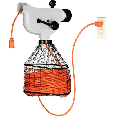

Ford Bronco Engine Block Heater 1605793294714
Will this help? I have two, but not for my car, here in the land of always summer.
