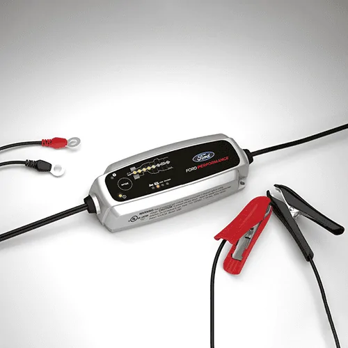

I live near Boston. You'll never use it. A diesel? sure. Maybe 10 times a year. For use in North Dakota upper Michigan area.
Spend the dough on:
Ford Bronco Engine Block Heater value? 1611625865856
