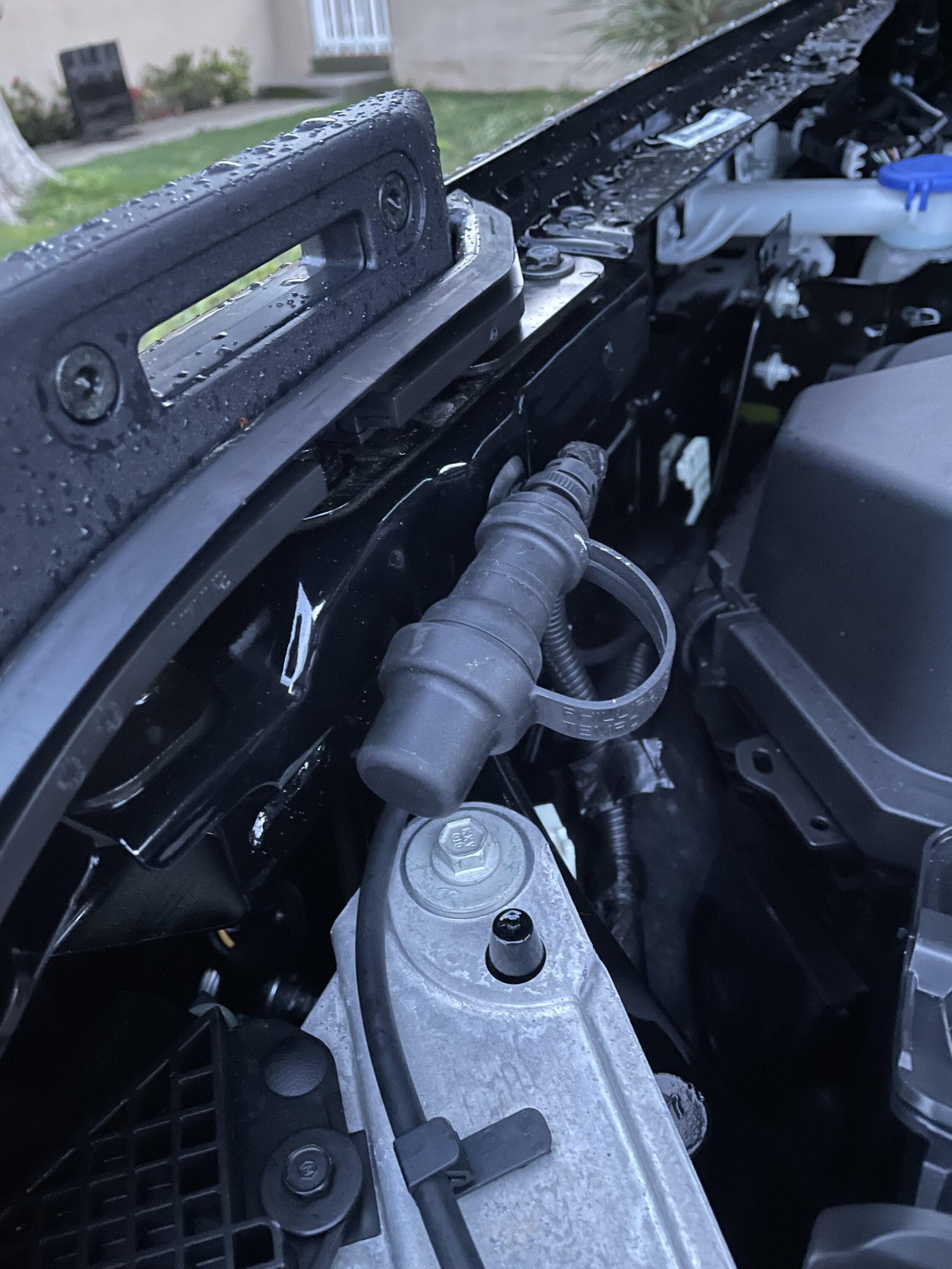

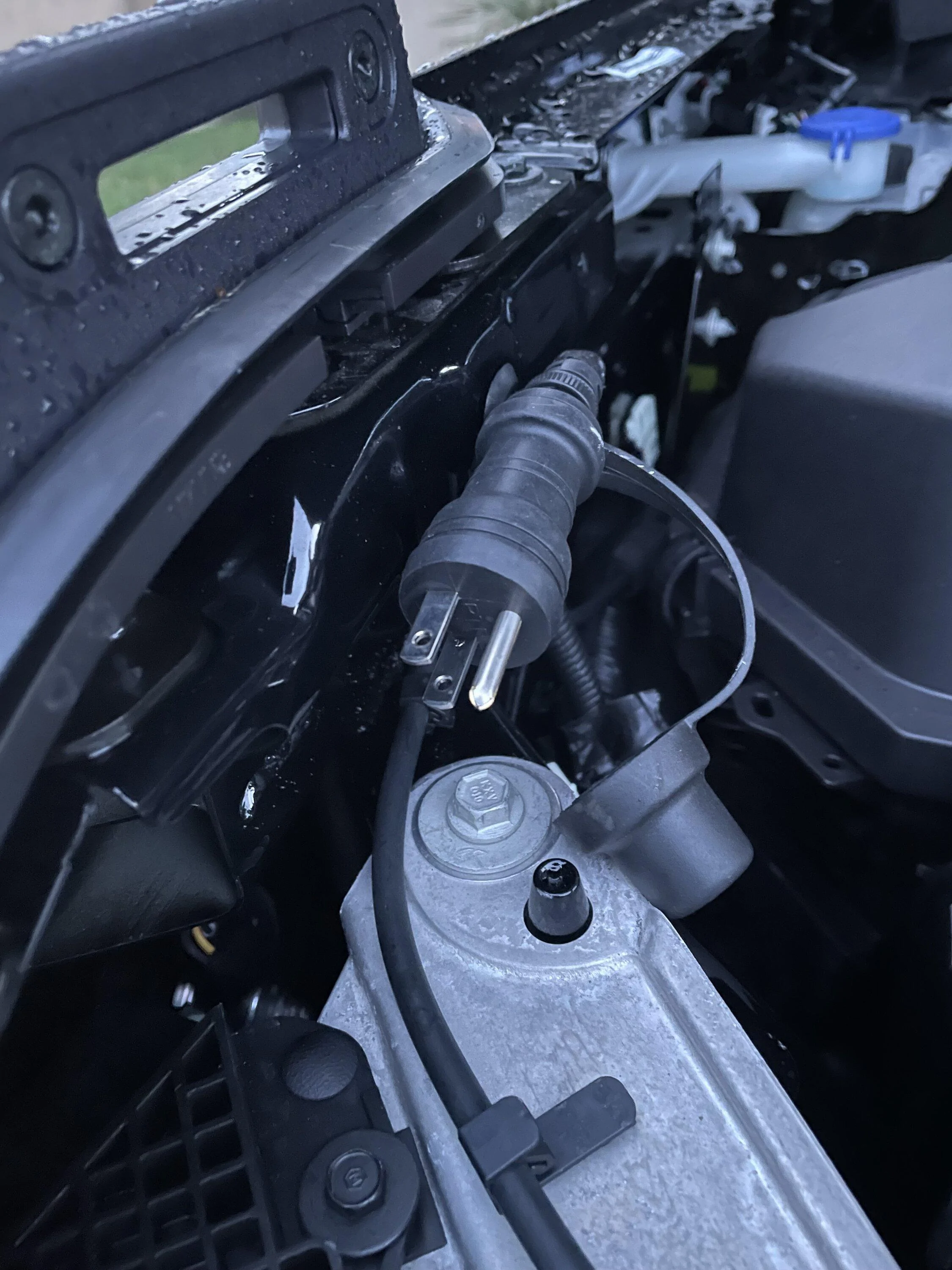

How does it plug in? I have one but forgot to ask my dealer how it works.
Pop the hood, on the left side near the radiator you should see the plug. Plug in your extension cord and you are done.

I see a plug there but it looks like the male end, I expected something different. Maybe I’ll take a photo tonight and post it.
