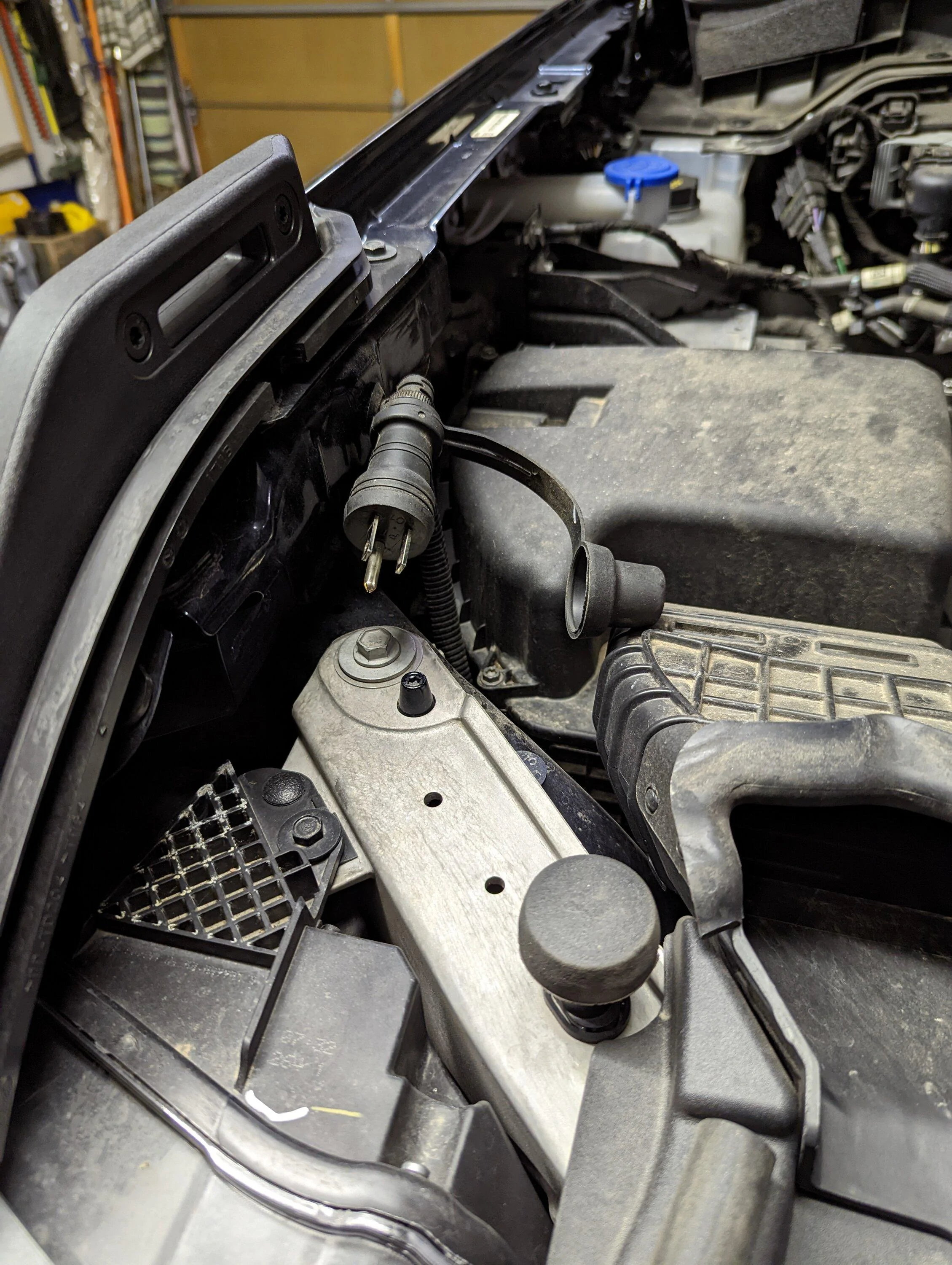

located under the hood passenger side by the hoot sights.

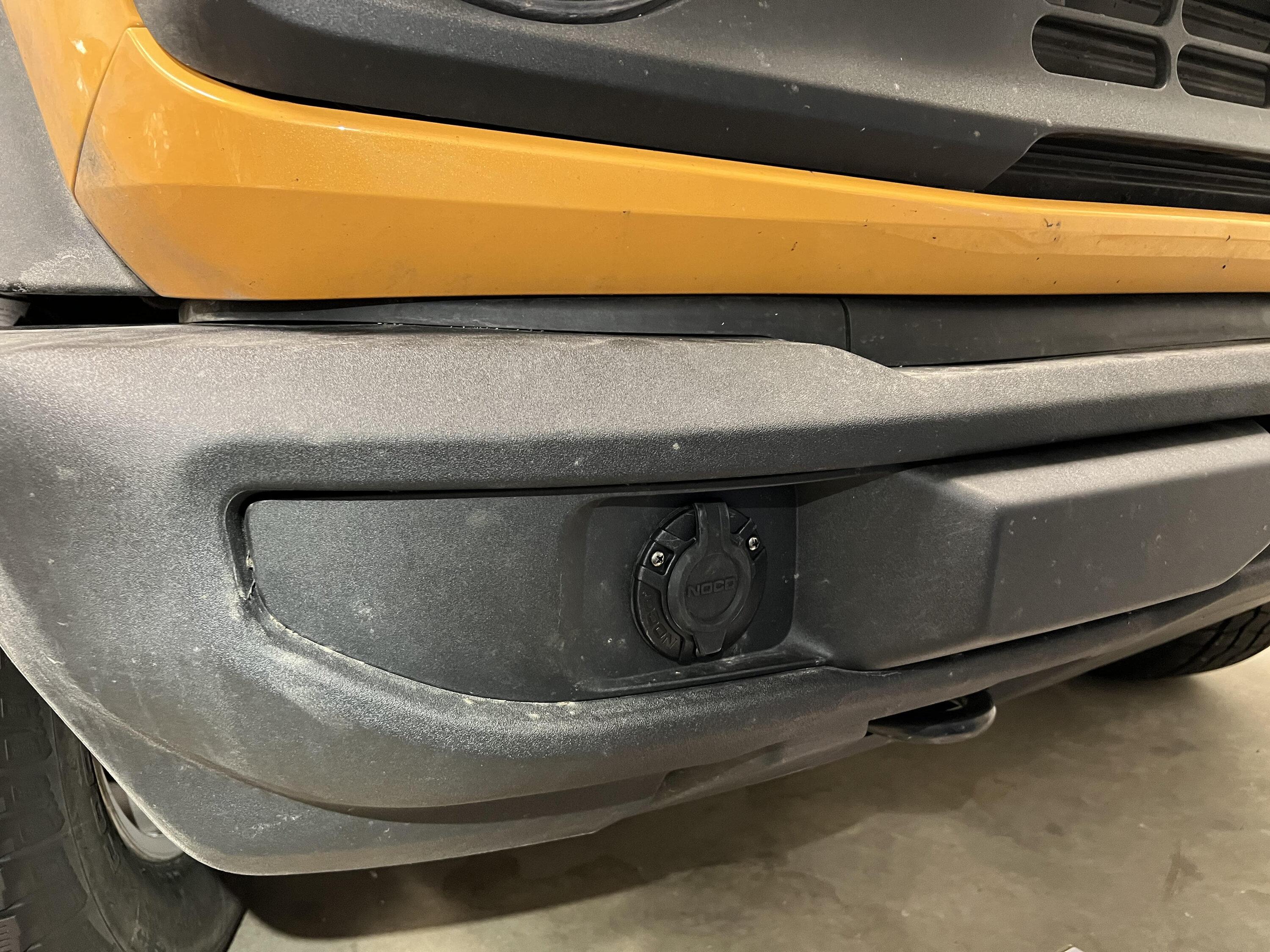

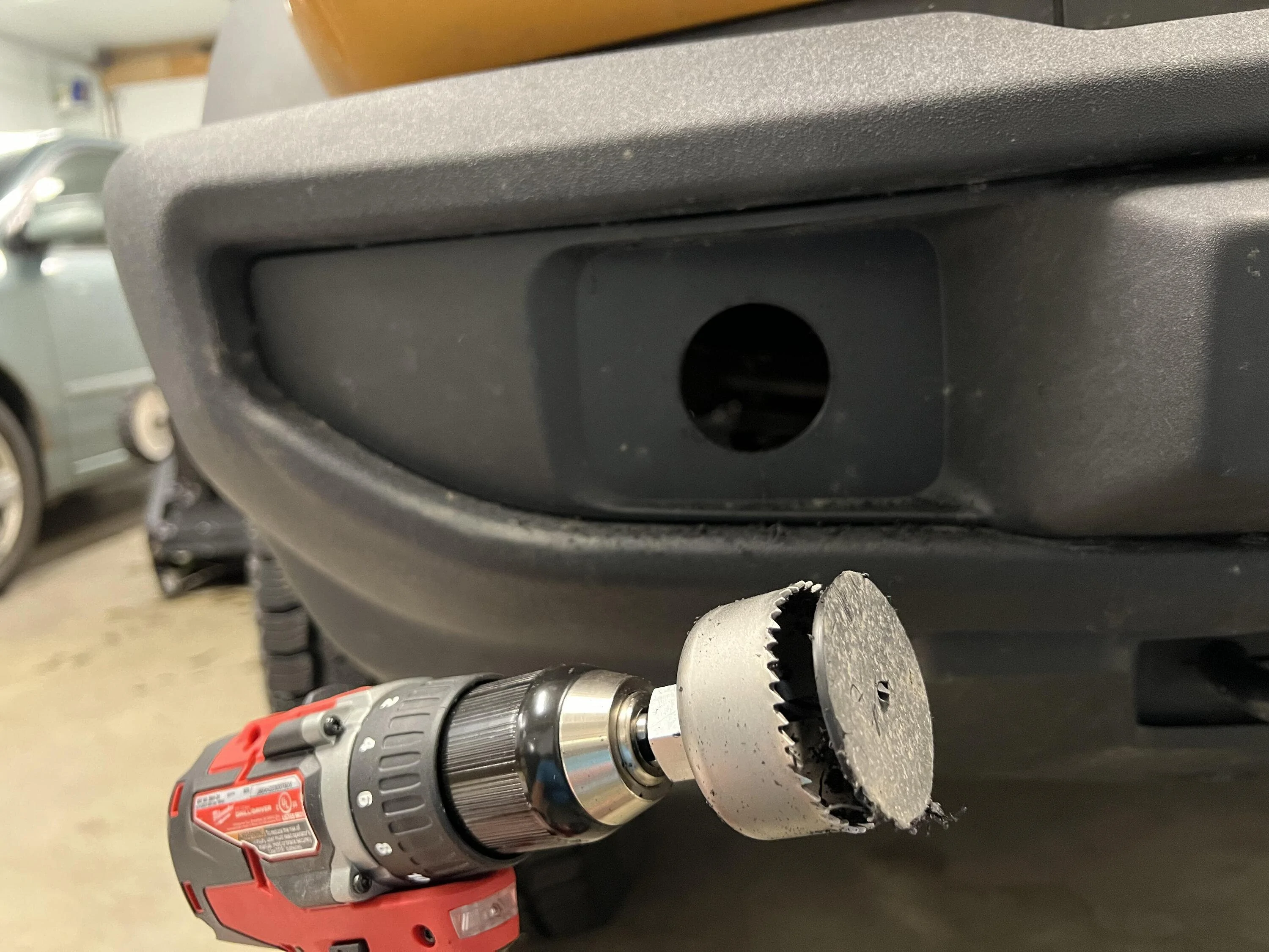

Decided to go for it in the bumper
How do you go about extending the cord? I've never had a vehicle where the block heater cord was only accessible with the hood open.

As mentioned, the plug is under the passenger side trailsight so your hood will be cracked open or you'll need to rig a short extension cord to hang under the bumper.

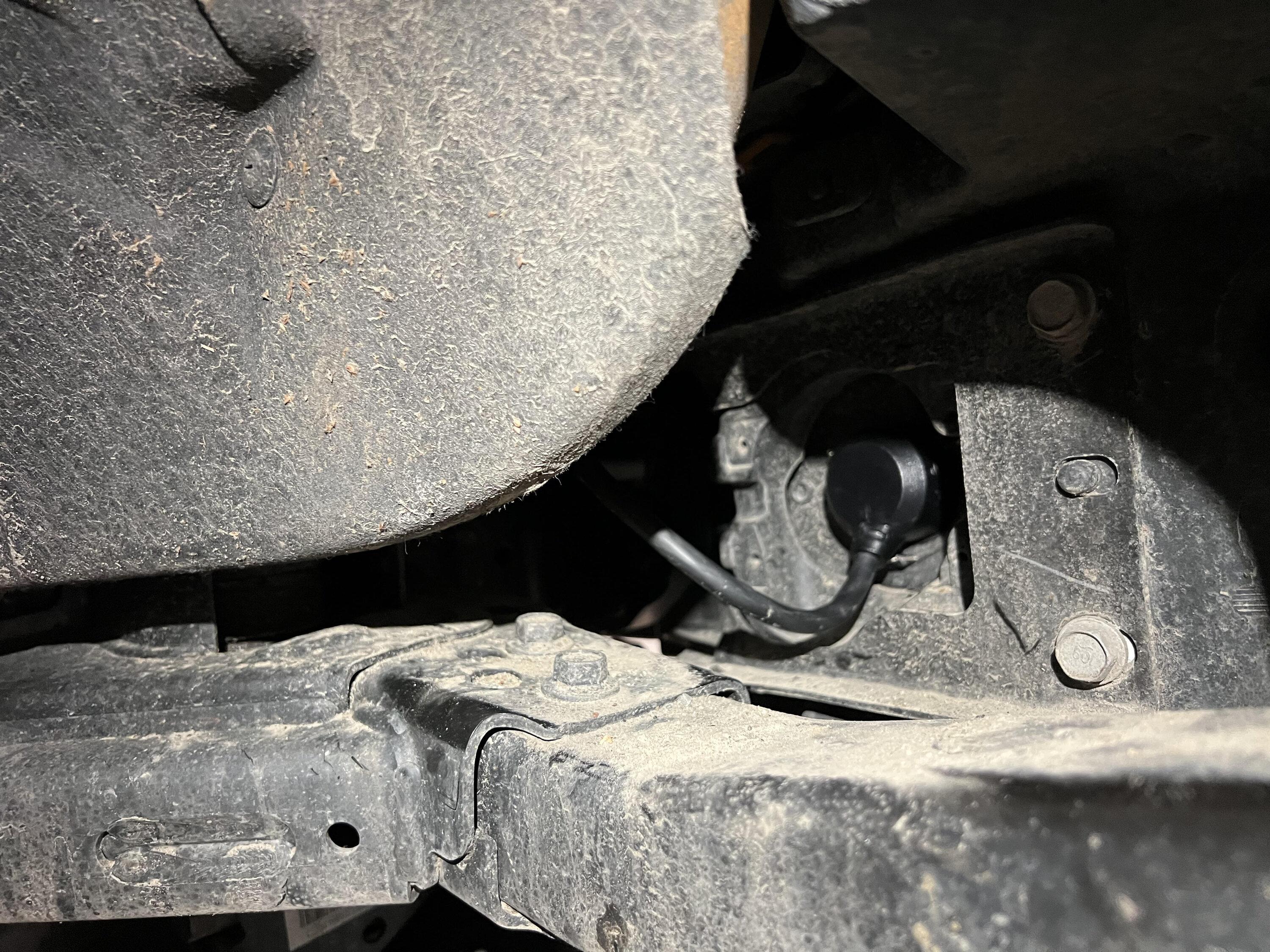

Yeah I didn’t want to open the hood to plug in or unplug. I added a short (36”?) extension cord I had and ran it basically straight down to the area in front of the tire, behind the bumper. Secured with a couple zip ties. Very easy.

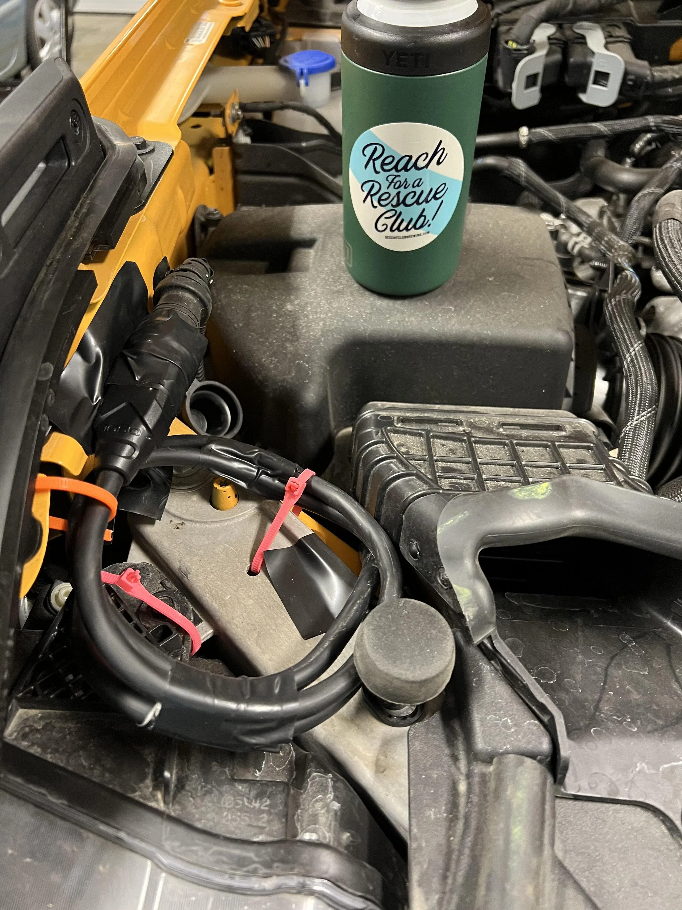

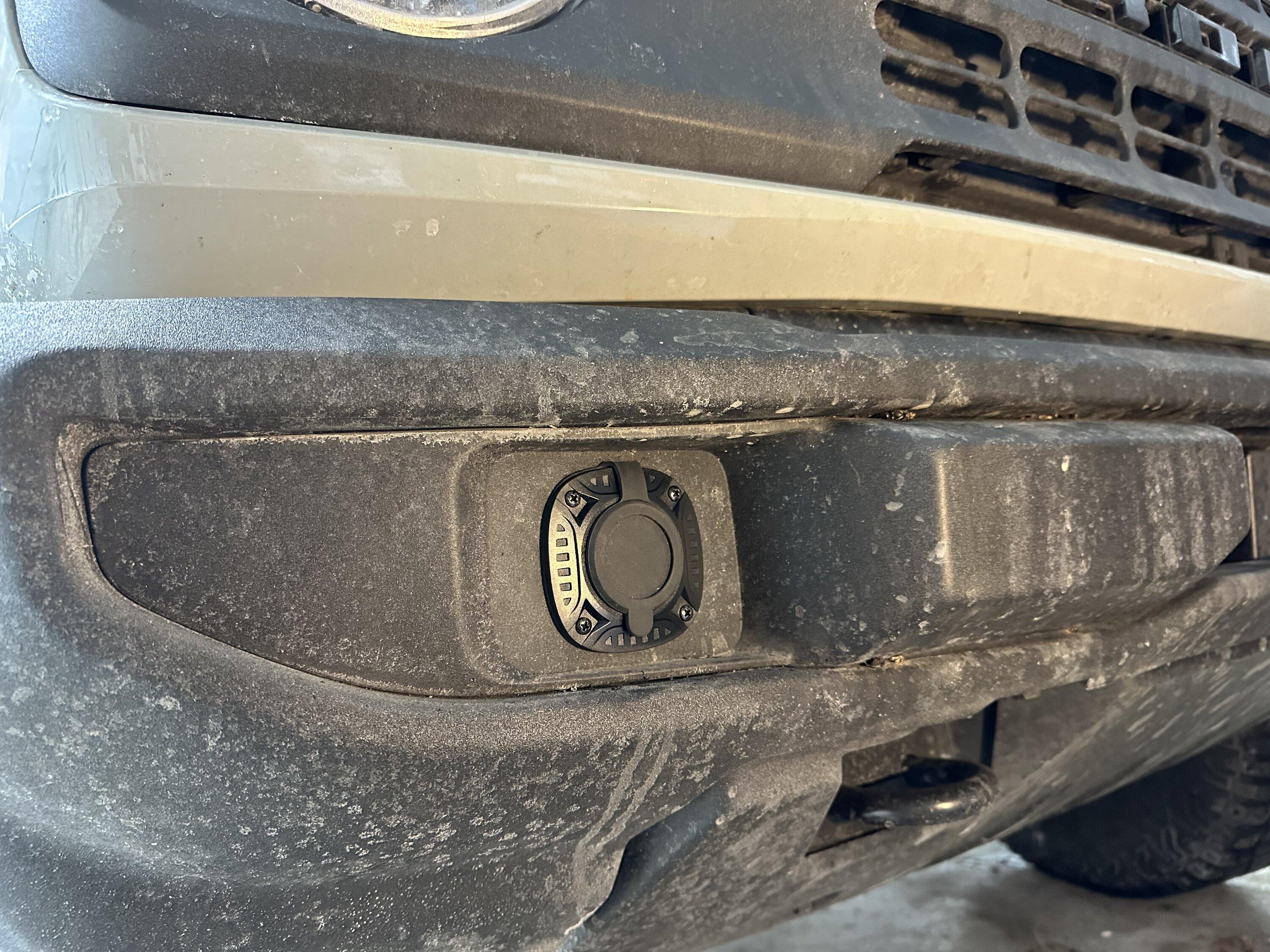

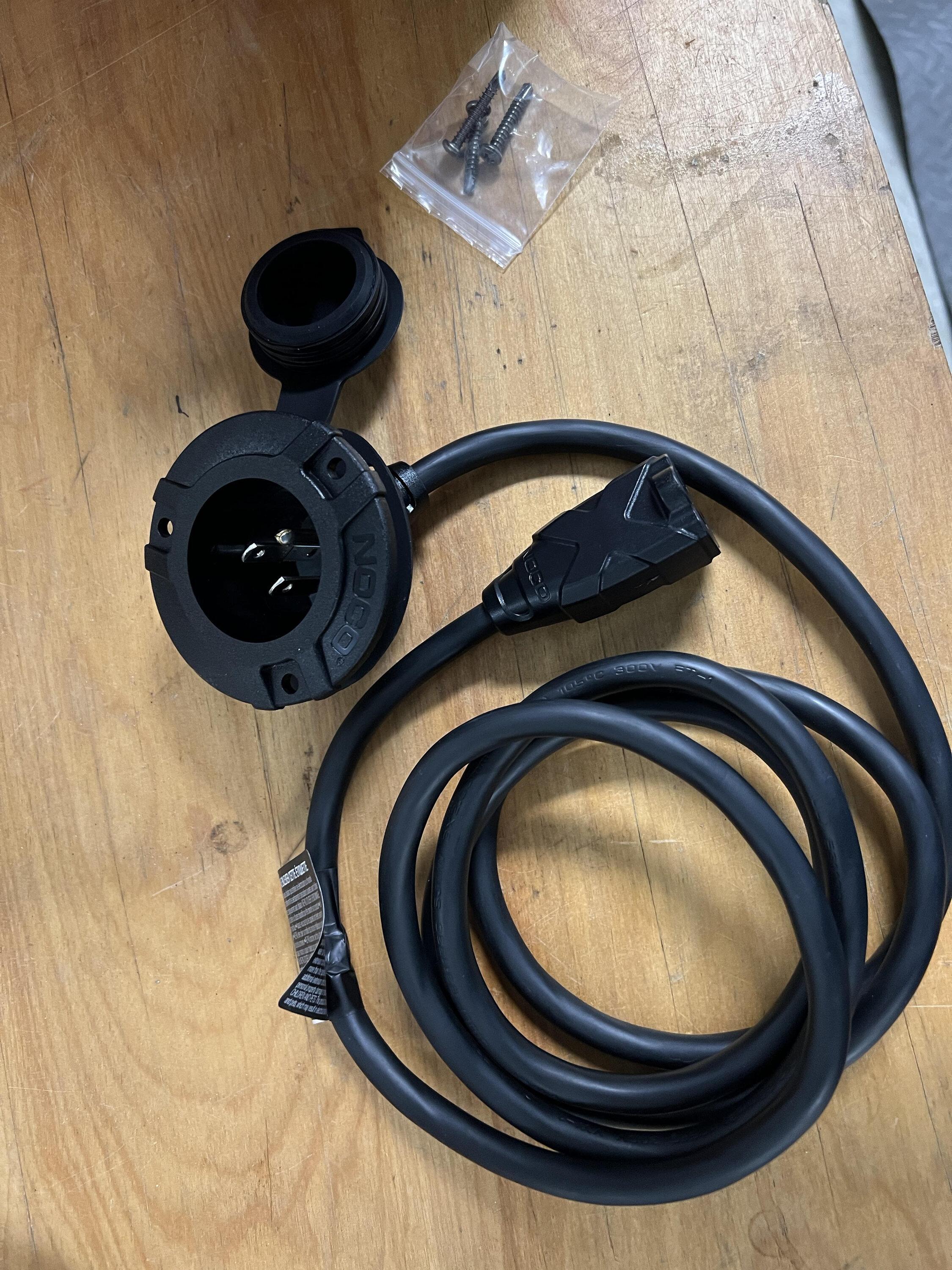

Same here, thanks to inspiration from this post - good looking mod! This is my version, I used a NOCO branded extension with a built-in receptacle. Wiring at the stock plug is kind of nasty looking but it seems I've achieved my goal of having it not move around much.

Nice work! That looks clean.
I’m pretty annoyed at myself that I didn’t tackle this project at any point in the last 8 months…now it’s in the teens each morning. I’ll have to do it after the holidays. I gotta figure out where I’ll mount the plug since I have the modular bumper.
