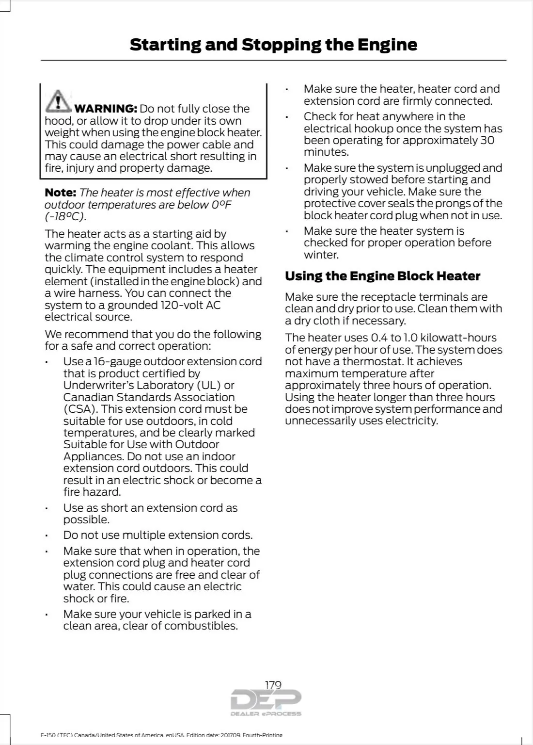

Interesting, I didn't know all that. I've always just had a block heater but they were older cars. What design considerations went into using -18C as the threshold? Is anything warmer than that considered acceptable to not have an engine heater/anything colder than that it's recommended to have one? Or is it related to the sensor faults going off and they're just trying to avoid that?
They probably just picked -18*C because it was an American engineer and they were shooting for 0*F
True, but I still question the significance of 0*F. I wonder if it's a threshold temperature for coolant or oil

Info from a dealership
Looks like something to consider, but I did find the length of time needed or recommended for these interesting. It states 2-4 hours time is the recommendation. Uh... I won't be interrupting my beauty sleep, to plug this bad boy in, before I go to work. I know it says recommended, so longer probably isn't an issue and just wasting electricity.

regarding the -18C point, apparently some people were cutting off the end of the block heater cord (the part with the temperature sensor in it) and replacing it with a simple plug. This lets the block heater work at any temperature, however after a number of hours one of the engine modules looks at the ambient temperature and says, it's not cold enough for the block heater to be on, but my coolant temperature is warmer than the outside temperature, therefore there is a problem with the engine, and turns the engine light on.
Anything that heats using electricity isn't very efficient. So you'll be wasting a fair bit of power if you plug in after work and unplug in the morning. That's probably 12 hours or so.
There are a number of timers on the market. Either straight timers....just set the hours....or....some with a thermometer in it that will come on depending on the ambient temperature. You set when you want your vehicle the warmest. So if it's warmer they will come on later. Some also cycle the power so it only comes on for certain intervals. Lots of power parking lots do this do this as well.
Thanks! This is all new to me. Currently in Chicago suburbs, I don't have one with my f150, but there are many times we get a cold burst that I wonder if she'll start. The f150 (2004) has started every time, but she doesn't like it. LOL.
