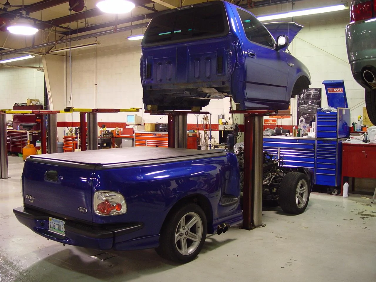

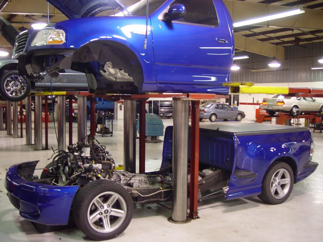

Seems like a lot of extra unnecessary work for an engine replacement. He must not be flat rate.
While I’ve not done one on a Bronco and I agree that it’s probably unnecessary especially on a 2.3L, it’s not always as much work as it might seem.
I used to pull cabs on my and customers F-150’s regularly years ago in my Lightning racing days even just for a cylinder head repair or replacement.
This 5.4L engine can also be pulled through the hood but pulling cab only takes an hour or two and makes the rest of the job so much easier.

Um has the owner of several big ford diesels the last thing we want to see is a ford tech that prefers or requires the whole body to come off! I get it fine under warranty but ask us supurduty owners how much it costs after the warranty runs out? Let us know what the total payout is from ford and good luck!
Sadly, most dealers pay techs flat rate. This means they get paid the same amount for the job regardless of how they approach and complete the task.
I left the industry in 2020, but pulling cabs off F-150’s on up was becoming the preferred way for the flat rate techs because it was quicker and allowed easier access. I’m not at all surprised to see it on a Bronco.
That frame is a thing of beauty, looks massive compared to even most truck frames.
Most techs I knew were happy to be flat rate and bill 150+ hours per 80 hour pay period. The problem came when the OEM compared warranty time to actual repair time and saw there was a faster way causing the OEM to investigate and cut warranty times. Techs are always finding the faster way to complete the task. They usually lose their shirt the first couple times doing a new task, then they get faster and more profitable.

Question...the "truck" Frame is where the strength comes from right? So when you remove the body, isn't it "weak" meaning can it actually support everything without stressing or twisting metal, plastic interior parts, etc?
I mean I've seen people pull the body off, but a lot of times they've stripped out most of the interior.
When Ford builds them, do the place the body on the frame before or after adding all the interior weight?
SuperFord
SuperFord
Feb 7, 2021
515
1,839
2013 Ford Fusion
The interior doesn’t weigh much (relatively speaking).
On the assembly line they install the seats, instrument panel (dashboard), etc. into the cabin or body after it has been painted and installed onto the frame.
the metal body is plenty strong enough to hold those parts (ex. Your seats and belts that hold you in place are bolted to the floor pan and body panels, and not to the frame itself.
there is also little or no twisting or torsional stress on the body in this example. The body is just lifted straight up and is “resting” on the lift arms instead of on the frame rails.

Working in a dealership we remove cabs alot just gives better access to all the stupid harness clips ford loves using and better for torqueing bolts properly.
Thats it you’ve sold me! Im skipping the pool this summer and buying the wife a lift for my garage with 9ft ceilings! Happy Birthday Dear! 🚨🚨🚨
