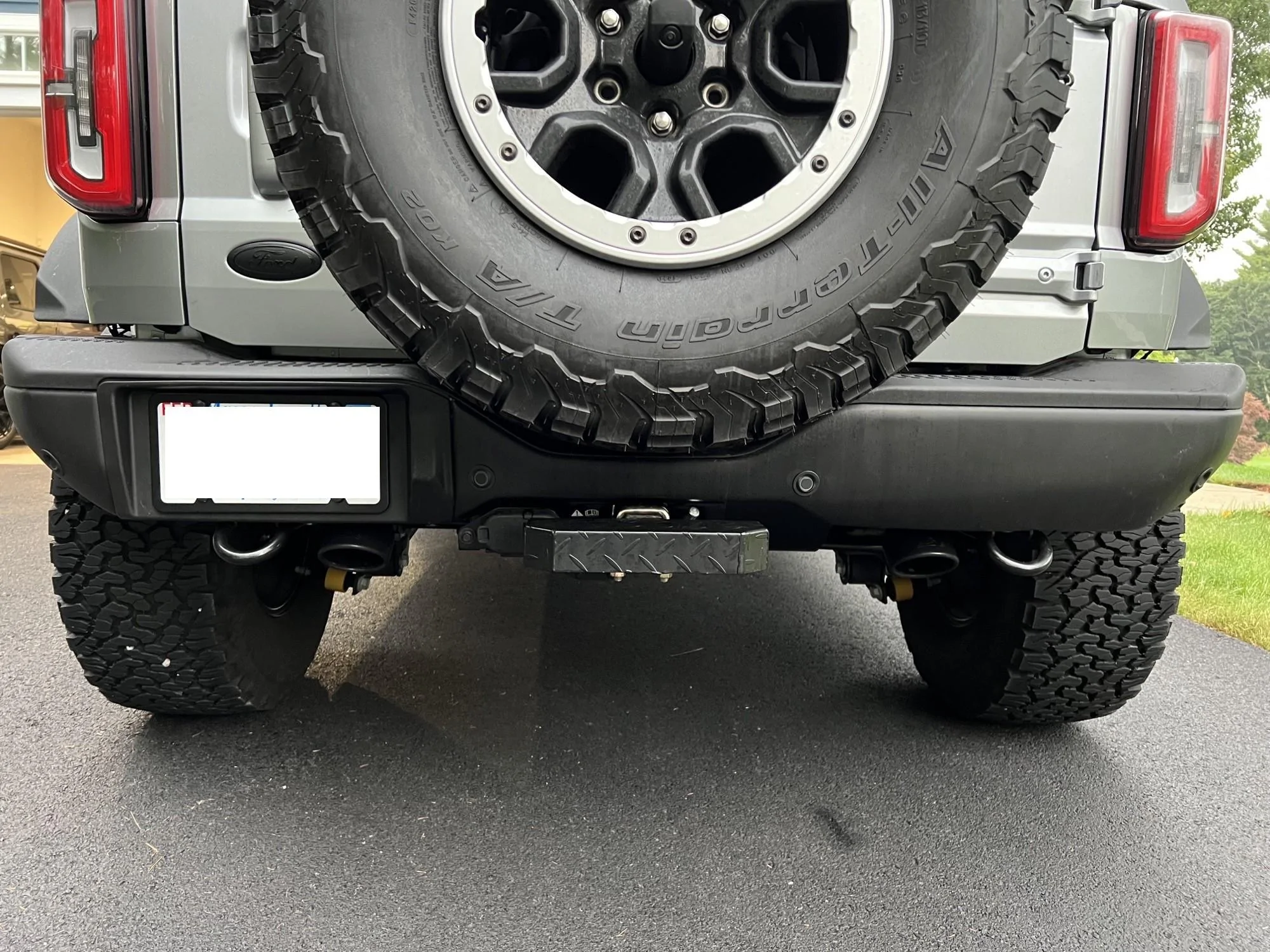

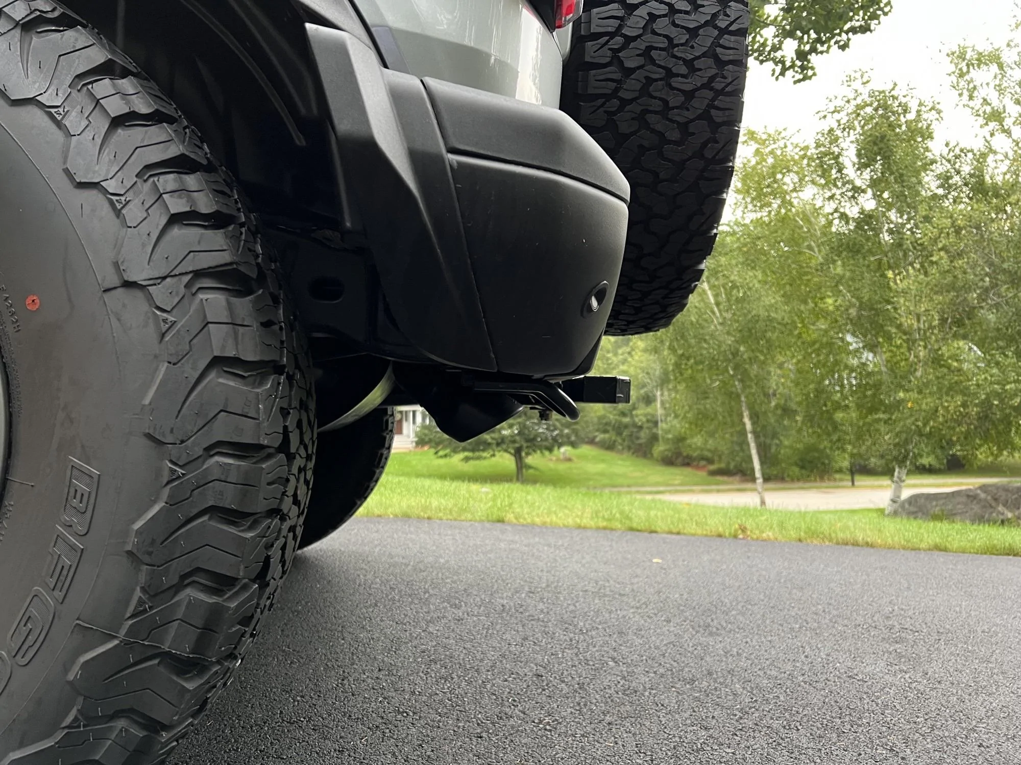

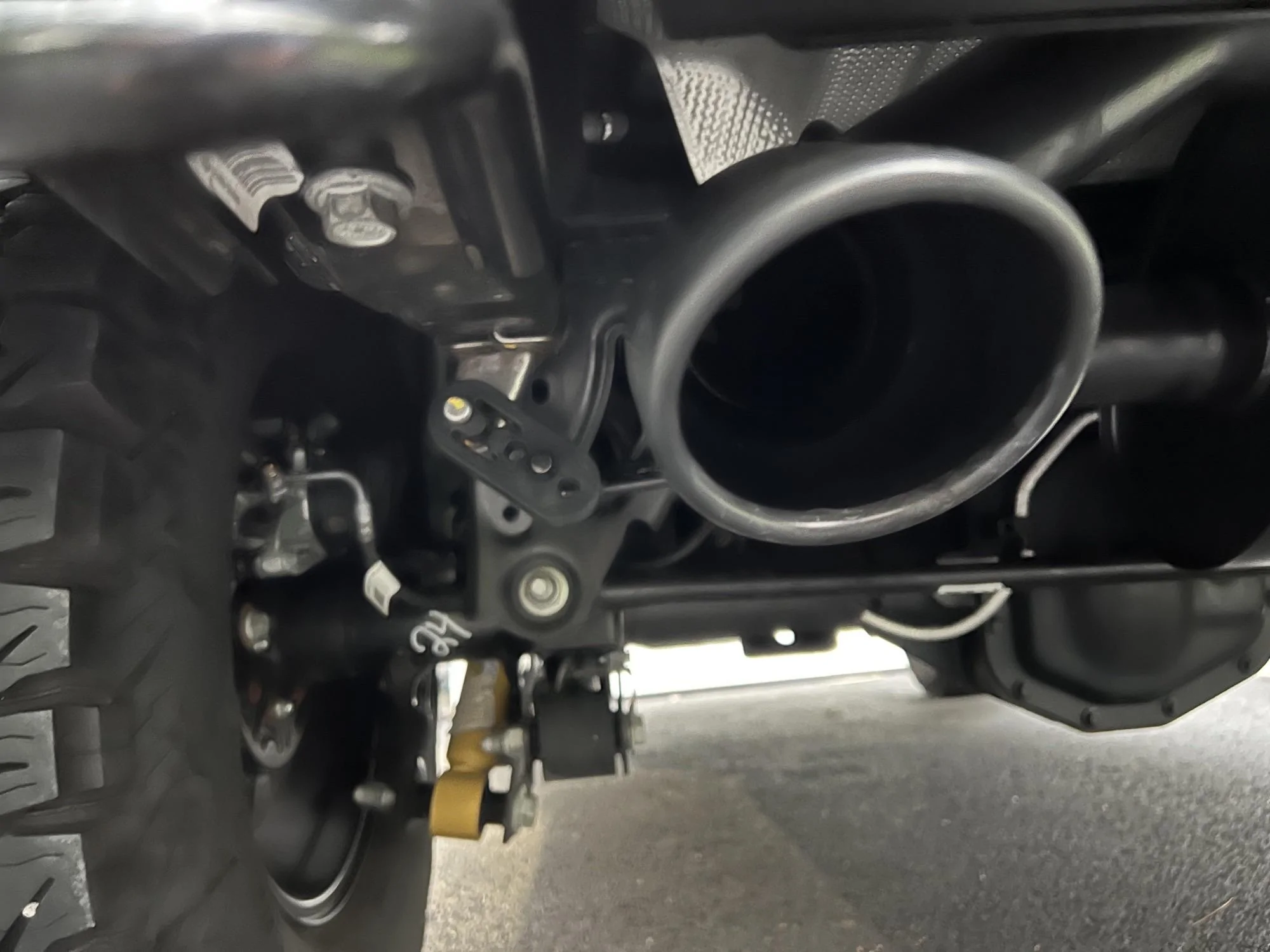

It took about 3 months to get to me, but I put it on over the weekend and its perfect for what I'm looking for. Not too loud (V6 engine just should never be that way!), no drone, and mas a good fit (minimal amount of tweaking to get everything to fit right. You can see from the picks the dual exhuast tips are tucked in pretty good - the one thing I'll give folks a bit of forewarning is that when I used the factory muffler hangers (the rubber donuts) the muffler is so high up that the tips hit the bottom of the bumper. I don't know if thats because I swapped my Wildtrak to a steel rear bumper - but I purchased longer hangers to give me at least 1/2 inch of clearance. Overall easy install, fitment is good, and its a little louder enough to know it doesn't sounds like a stock one!!!

@WillinMA - Did you have any issues of the dual exhaust tips looking uneven? I know this can be a common issue on vehicles that don’t typically have dual exhaust, so was just curious.
@Toccoa - Do they look even to you? ;)
