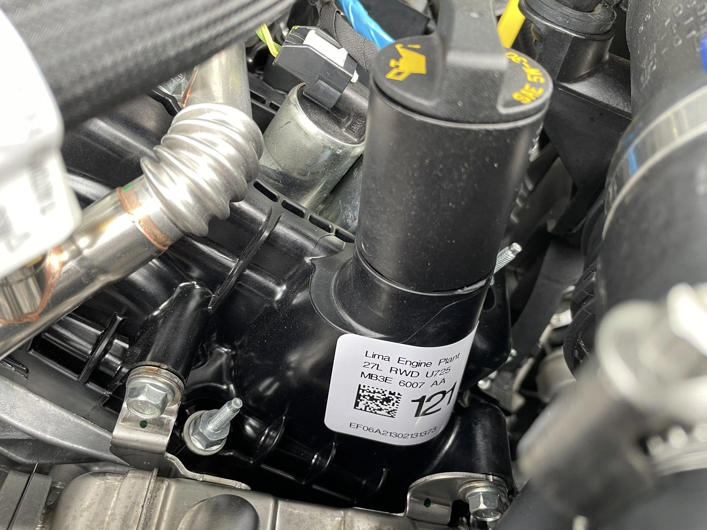

@Lance103222 pls use this post to determine your engine build-date. B6g can then add to the range of known build-date failures -
