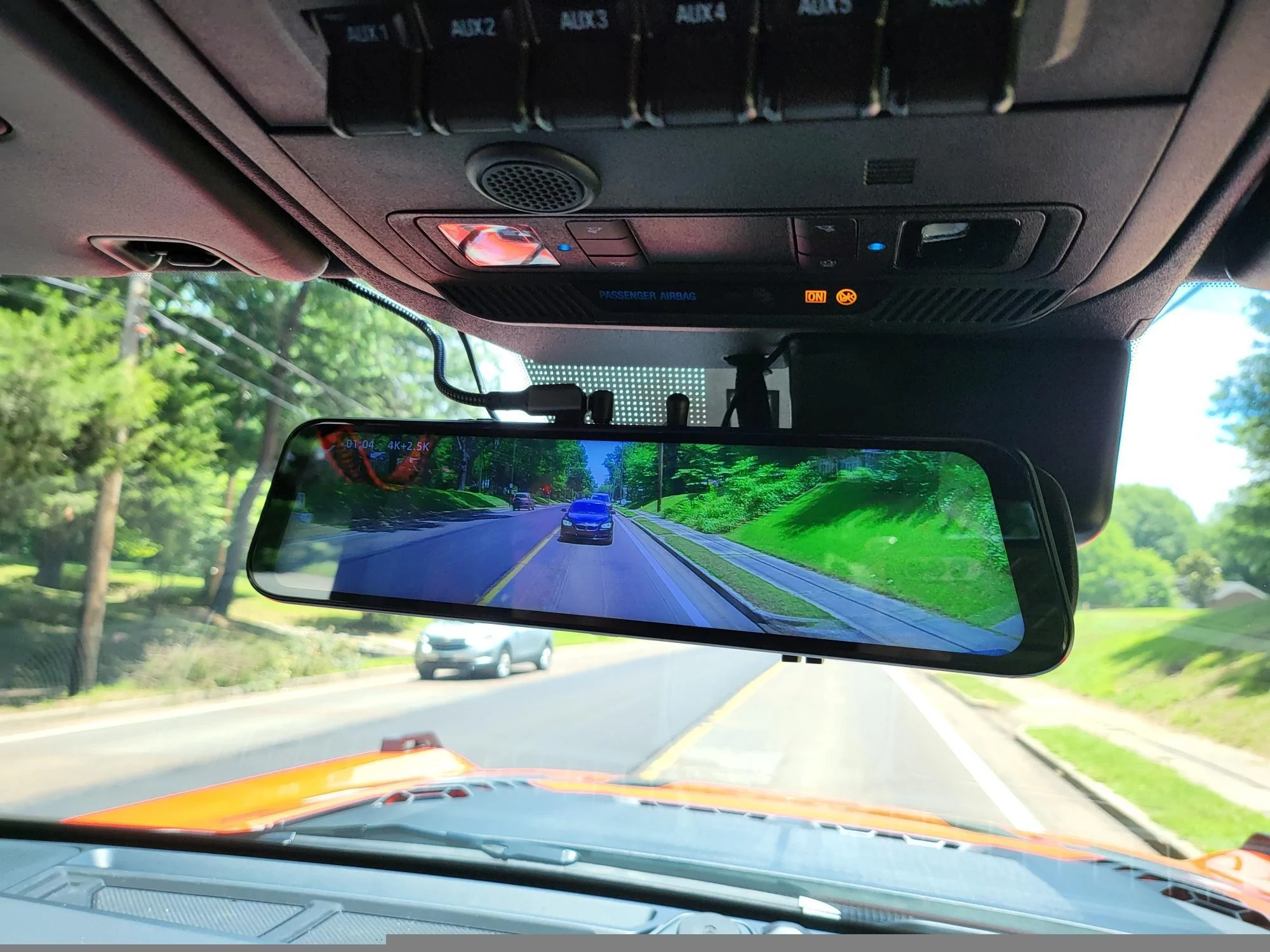

I couldn't stand the lack of visibility with the stock setup. Bought a Wolfbox 900 dash cam that uses a rear view mirror as a video screen. The view is adjustable from extremely wide to stock like. I have the camera mounted to the rear window. Others have put it on the third brake light above the tire.
It being a dash cam is a bonus.

Install is just running the power wire and the rear camera wire. I ran those up to the trim along the windshield and along the driver side. I went easy/lazy and ran the rear camera wire along the roll bar. The power went under the trim then under the floor mat and up into the console. I might at some point run power from the fuse box. Also there is GPS dongle I ran it along the trim above the windshield on the passenger side and down to the dash and just sat it there on my silicon dash mat. It hasn't moved.
It is full time rear view for me. You can turn it and and use it as regular mirror. Because the field of view is much taller and wider than the mirror allows you can adjust the view wider and up/down.
This easy as the it is a touchscreen and you just drag your finger. You can turn on or off features like clock, compass, speed that display on the mirror. You full screen front or back view or split screen them both.
As a dash cam, disclaimer I'm a noob at this, one weakness I see is that it does not have wifi to use to download files. You will have to pull the memory card and put it into pc for that. The recording can be viewed one the mirror. Recording is advertised as either 2k or 4k front and 1080 back. Night video through back camera is grainy but if you used the mirror at that point you would not have enough light to see regardless.
Adding pic of mirror camera in action.

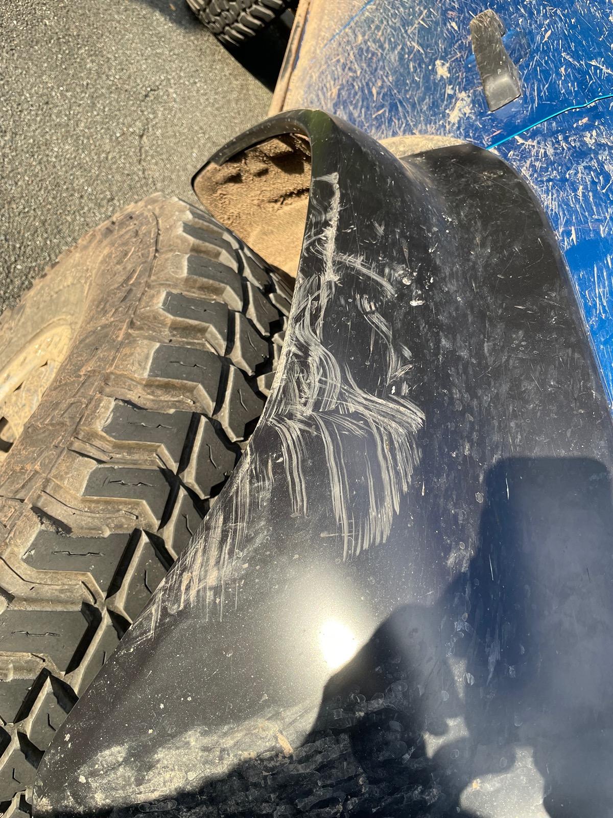

The Raptor's flares look beyond silly. It's ridiculous. Perhaps, new fender panels could make for a reasonable appearance.
They are not even big enough for my 40’s
I wish someone made metal fenders because I keep hitting them on trees
and having to pop them back on 🤣🤷‍♂️

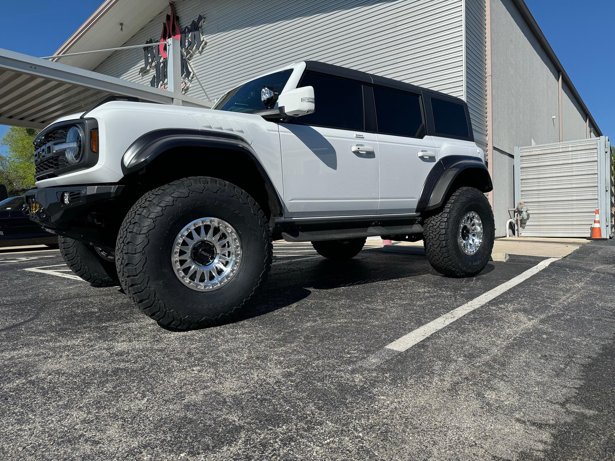

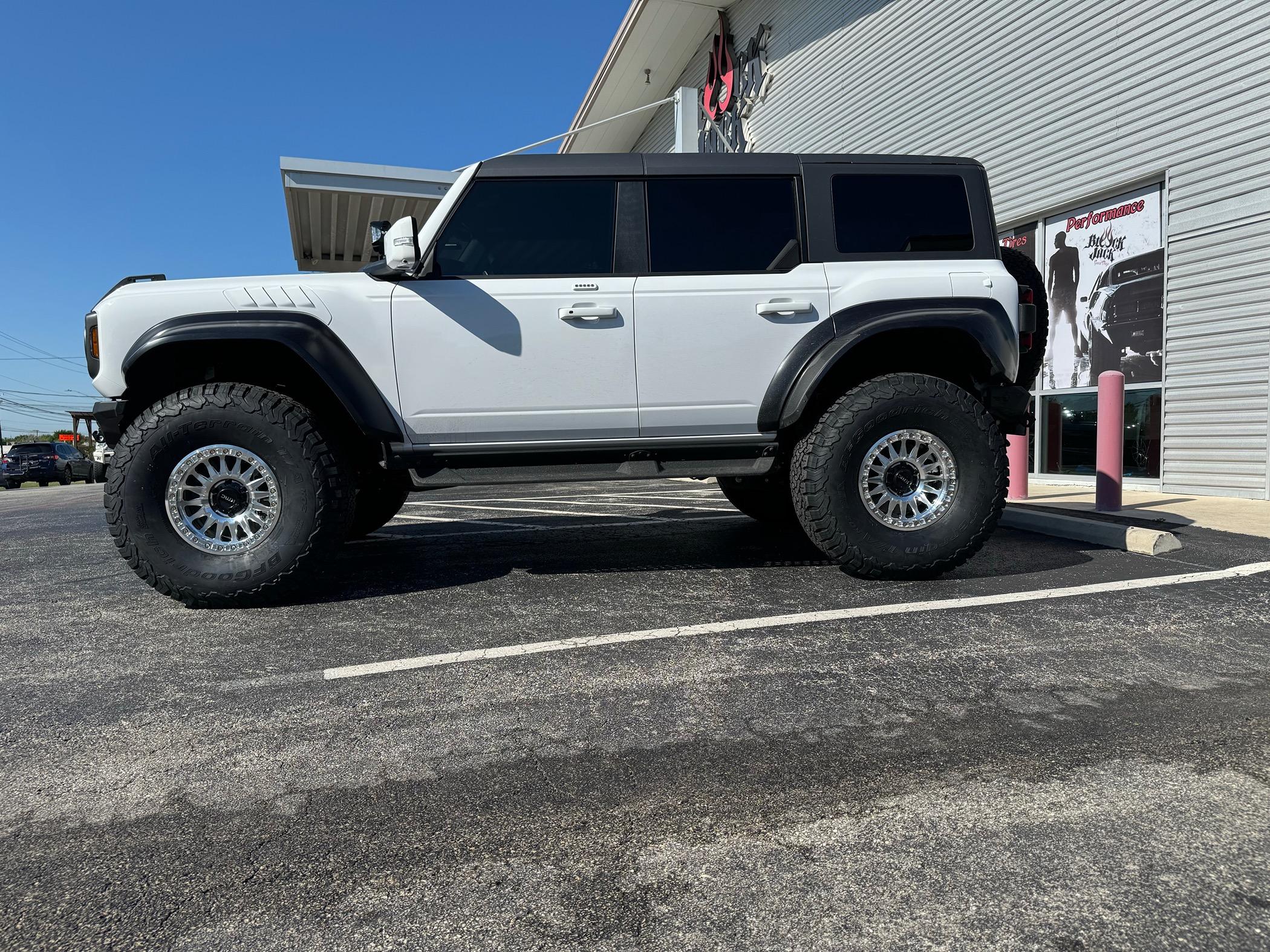

I almost feel they should have come with 39’s from Ford :)
