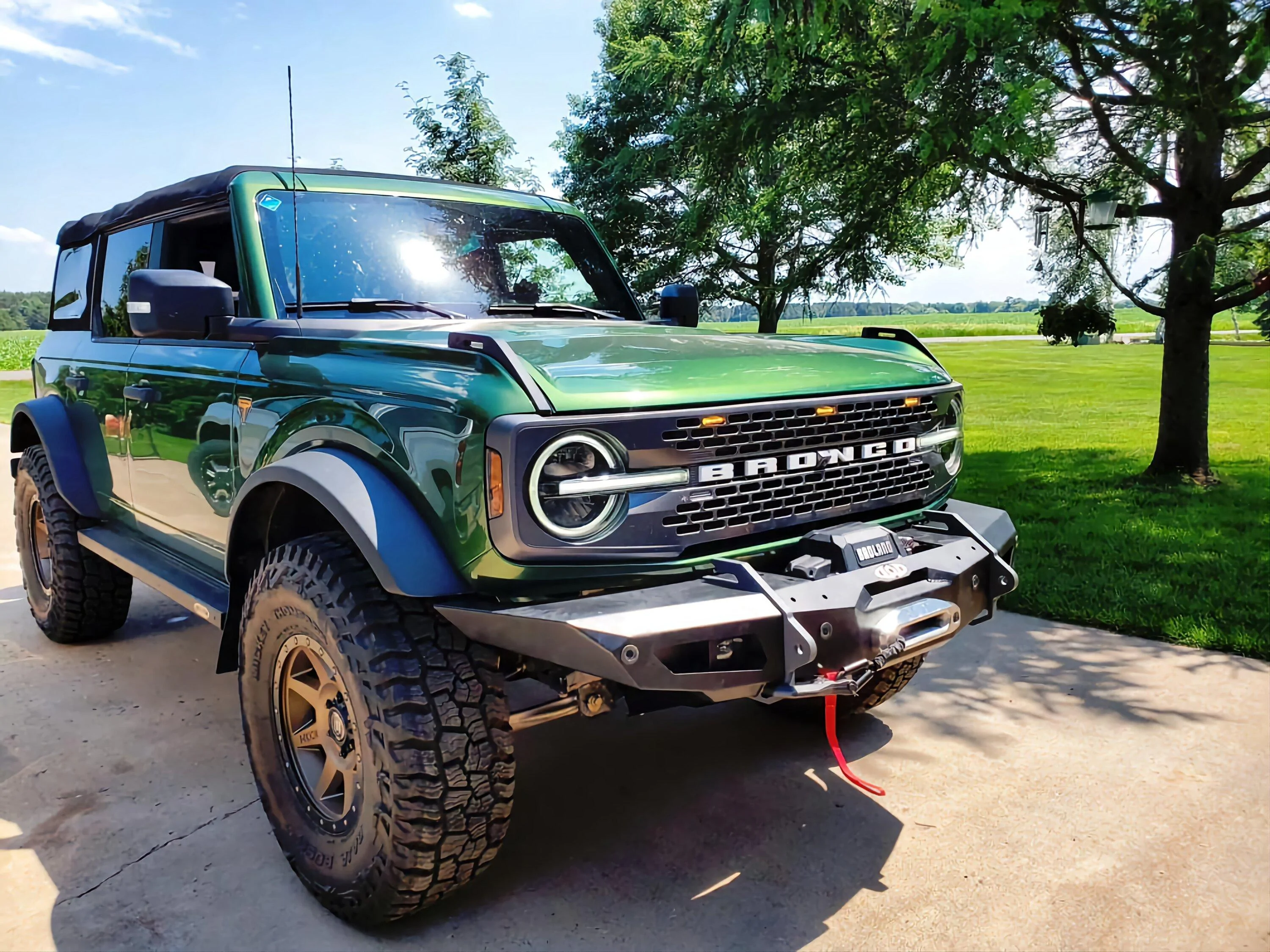

Have you loaded the bronco with all your gear and measure with you in it? My rake is also significant with a bumper and winch but rides level when ready for travel.
what I do lose is the ground clearance and want to get the heavy/heavy spring setup from EMU but they don’t have a sku for the 2 door and no eta.

I installed the Heavy springs and struts from old man emu with top spacer, brought sas back to ride height and no nose diving while braking.

I used the OME struts and springs. I used the spacers because I am running 37's. So it ended up level with my 2 inch SAS lift.
