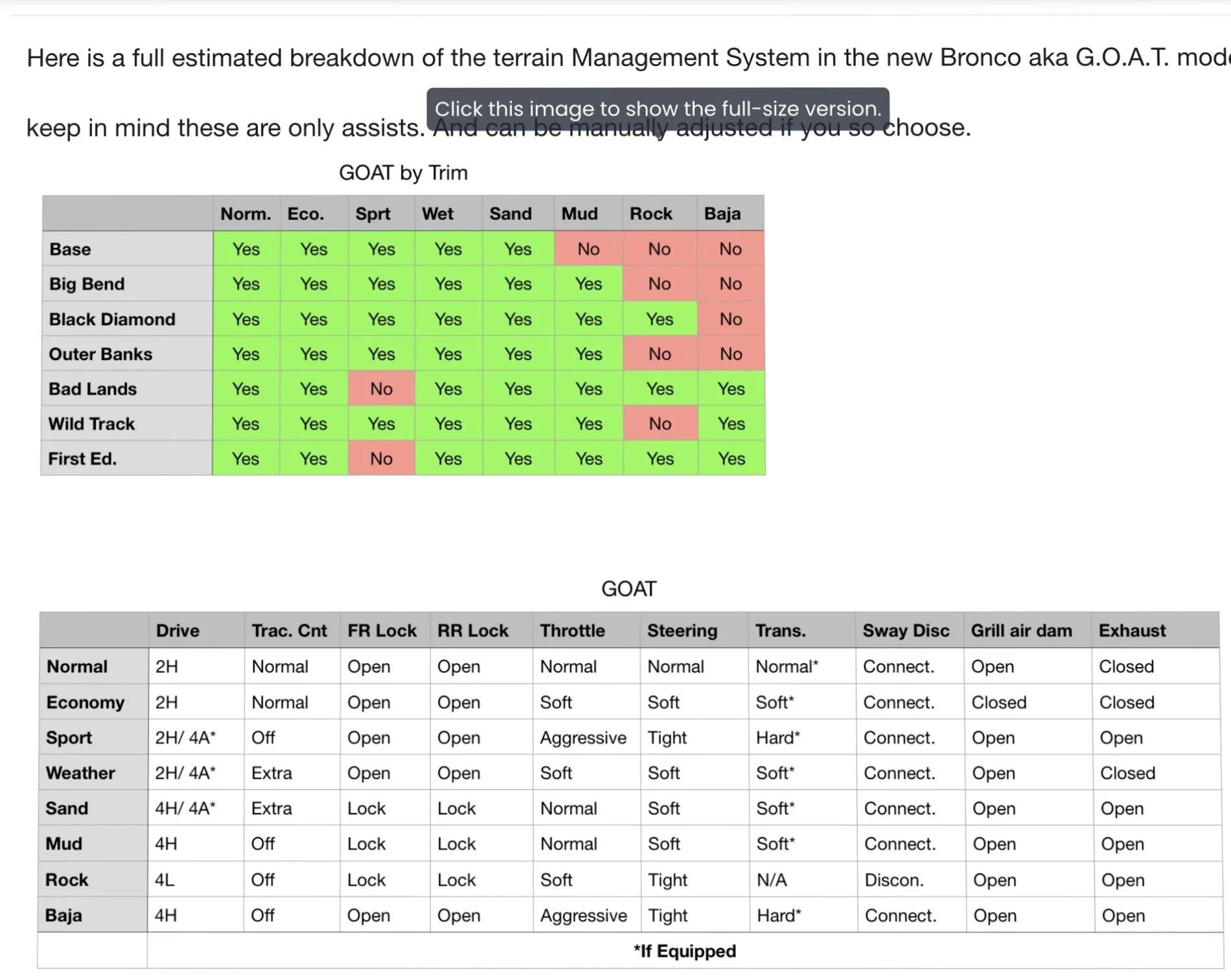

This was in a recent post; you can get most of the features out of a couple of the modes.

Ok this is a good example of what i’m getting at. Since sport and baja are almost identical. Could I put my car in sport mode then put it in 4H and boom I have baja (assuming my trim doesn’t come with a baja goat mode)
Yep, I plan on using Baja mode as Sport mode in my FE

Traction Control is NOT turned off in sport mode AFAIK. That chart is misleading, however it does deactivate auto stop/start which is missing from chart
Yup. It's one other reason to pick the BD. Setting for Baja is as easy as "Sport" + "4H". Now, I just need to move to SoCal so I can use it... :ROFLMAO:

What does “open” and “closed” exhaust change? Wastegate?
That chart was a very early guess by a forum member to what they expected Goat modes to alter based on other Ford vehicles. (Hence the exhaust toggle, which the Bronco doesn’t have.)
We should be careful not to take this with any sort of authority.
To answer the OPs question, Goat modes seem to do two different categories of things:
1. Auto select user modifiable things, such as locker, sway bar, 4WD mode, etc.
2. Change mapping and thresholds for things like throttle response, shifting, TSC, etc.
In the case of #1, if your Bronco doesn’t have a specific goat mode, you’ll be able to mimic it by just select the same combination yourself. It appears you can still select all these options yourself at any time in any mode... any changes that automatically happen when selecting a new goat mode are just a convenience thing.
In the case of #2, you won’t be able to change any of that yourself without the goat mode (or a programmer), but for all we know all Broncos have the same options just with different names. I.e. if my Bronco has Baja but not sport, maybe I can select Baja and then by putting it back into 2H, you’re achieving the exact same thing as sport.
In this way, maybe every Bronco has every goat mode combination possible, but they just decided to list a subset for packaging and figured we could always just toggle the #1 options as we see fit.
