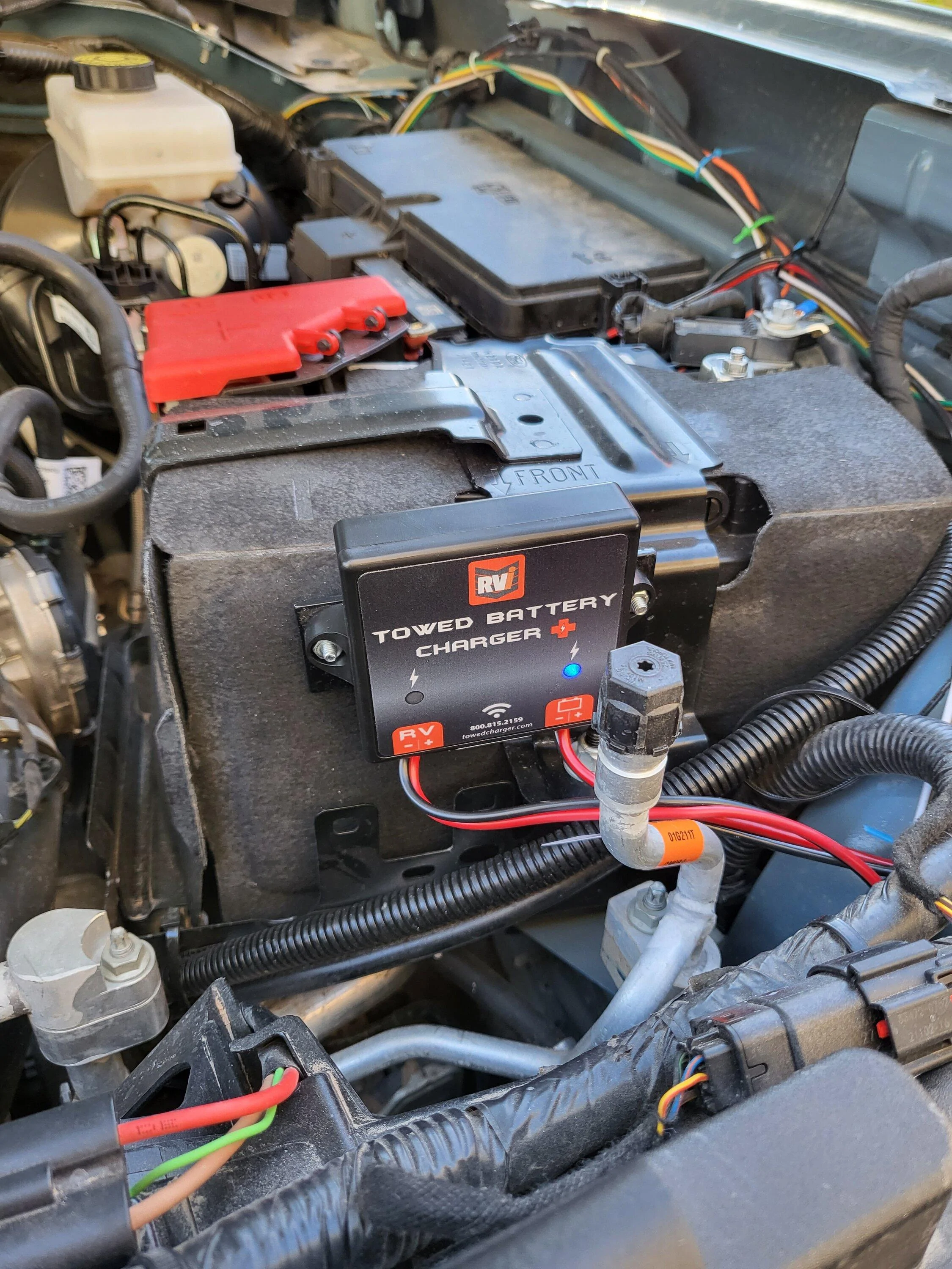

I wish we had actual verification this is the problem...but in the vain of better safe than sorry I'm adding a charge line to my set up.
[/QUOTE
Done
