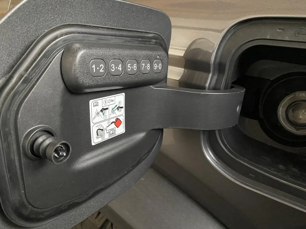

I don’t have a keypad because they look too dorky for life.
I completely agree! That's why I asked my dealer to order it, and just throw it in the glovebox so I can apply it to the truck myself.
The Forscan double-honk elimination took all of 5 mins! Spent way more time researching it than executing it.

God forbid if you've got your fob on a keychain or you didn't option for a big black Tic Tac.
They're no longer black and can also be relocated inside the gas door if they're that offensive.
