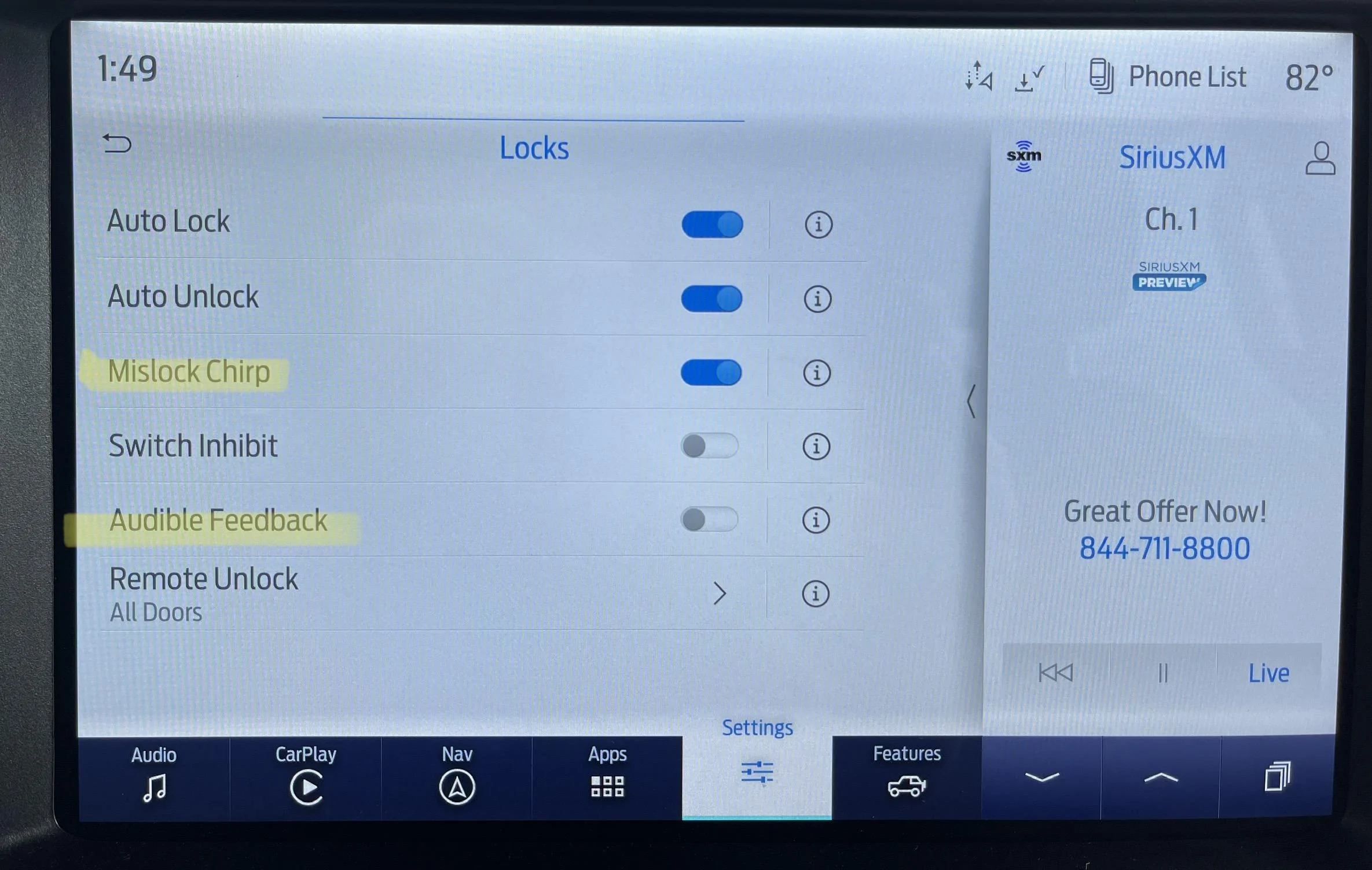

I’ve read so many compaints about the double honk here, and I’m really baffled when you can simply just shut it off in the settings, without Forscan. Maybe I’m missing something. 🤷🏻‍♀️

Those settings will not disable the double honk.
It's a non issue if you change your behavior just a bit. Just don't leave the key in your pocket when you get out of the vehicle with it running. If you want to secure the vehicle while running, use the keypad to lock and unlock. It is quite simple.

Neither of those settings control the double honk which occurs when you exit the vehicle while running without leaving the key inside, which is where the complaints stem from.
Mislock chirp alerts you when you try to lock the vehicle when a door isn’t fully shut. Audible alert is for when you press the lock button on the fob twice.

I don’t know what I’m missing. I disabled something the first week without any special tools. No more double honk. 🤷🏻‍♀️
My vehicle is 2023 btw. Not sure if that matters.
So if you go outside right now, start your Bronco, exit said Bronco while it is still running and with the key fob in your pocket, close the driver side door upon exit, your Bronco does not honk the horn twice?

Hmm, I’ll try it, but by the hell are you doing that? Lol
