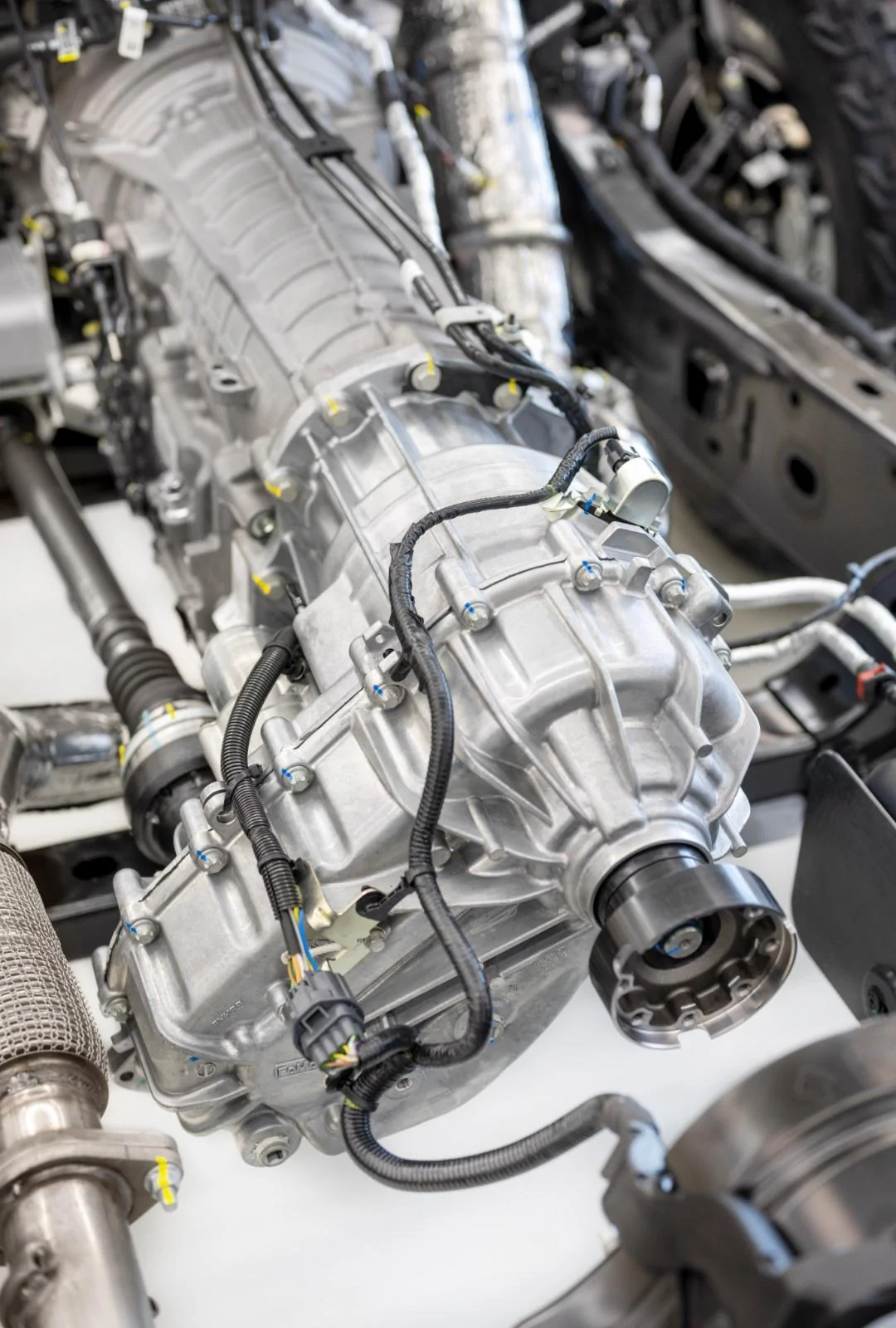

Any one know what BW T-Case number this is; hoping it’s new and close to what the raptor has but probably the 4417

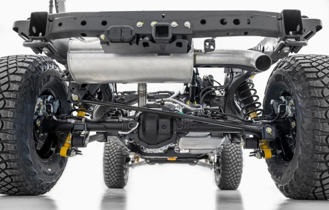

Ok, who else jumped immediately to the second pic to look at the tire/wheel? I did.

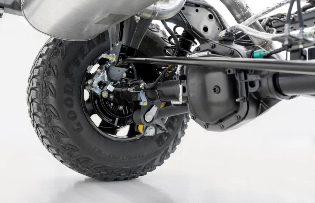

ok nerds, did you notice the rear diff cover? It looks like the edge of the cover is a couple mm away from the housing edge. It’s smaller than the machine edge it is bolted to. This will help to prevent the dreaded Oops of peeling back the diff cover when it drags on a rock and dumping all your diff oil on the trail.
Many off-roaders invest in a thicker iron aftermarket cover to prevent the peel back possibility.

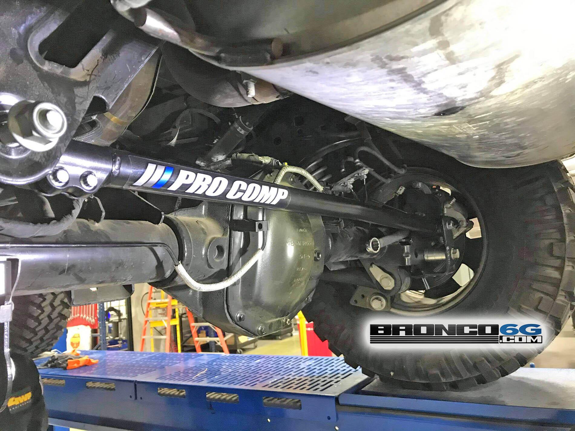

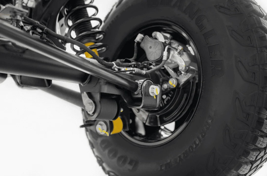

So, let's talk pan hard bar and lifts. Is there a difference in the bar or mounts on the squatch vs standard suspension? Is this new bracket to run 37s welded on? I understand all the up front stuff I need to do in a lift, but am not as well versed on anything not a leaf spring rear setup. What will need to be done to lift a couple of inches to keep the rear axle centered?

not sure on the factory differences. that procomp one looks to be adjustable and have a raised bracket on the other side. you won't need to weld anything on

So the new bracket on the axle is bolted to the existing bracket? Just hard to tell what’s going on in that picture.
