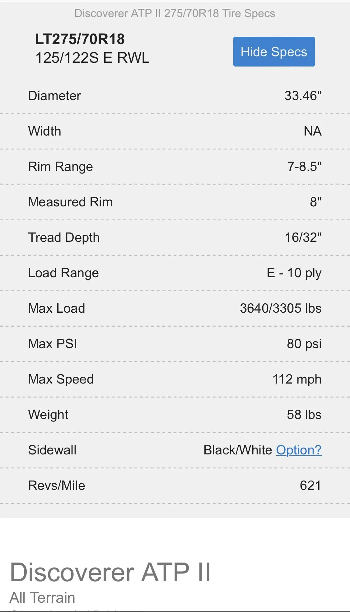

These are what I’d like to run as long as they wouldn’t feel like bricks. Anyone got ideas or experience with these?

that is the exact tire im running on my 2d BB with 4.27axle . I am really really happy with the ride and low noise , every passenger that has been with me I ask it they can hear the tire road noise all have said it is pretty quiet , I agree. I run 35psi but if you want a very smooth ride air down to 32 or a little less . 35 psi on hi way I getting 19mpg @ 69-70 mph which I think is great for a brick with heavy tires compared to the lite Bridgestone it came with.
a pic for reference . I have true 33's now and love the stance.did not have to remove crash bars.
Something to keep in mind is the shorter the sidewall, the stiffer the tire, regardless of weight rating. That size is going to be stiffer than say a 285/75/17 due to almost 1 inch shorter sidewall, regardless of weight rating. There is just less sidewall to flex and absorb the bumps. So if you start with a shorter sidewall, and then get it in E rating, you should expect a harsher ride. It just depends on what you consider too harsh, as that is very subjective and why you get so many different answers about E rated tires.
In my experience though, most complaints about E tires come from over inflation. Tire shops love to fill an E tire at 65psi for some reason and then that's what people think they need. Run them at the correct pressure for the correct application and they are usually fine. Usually.

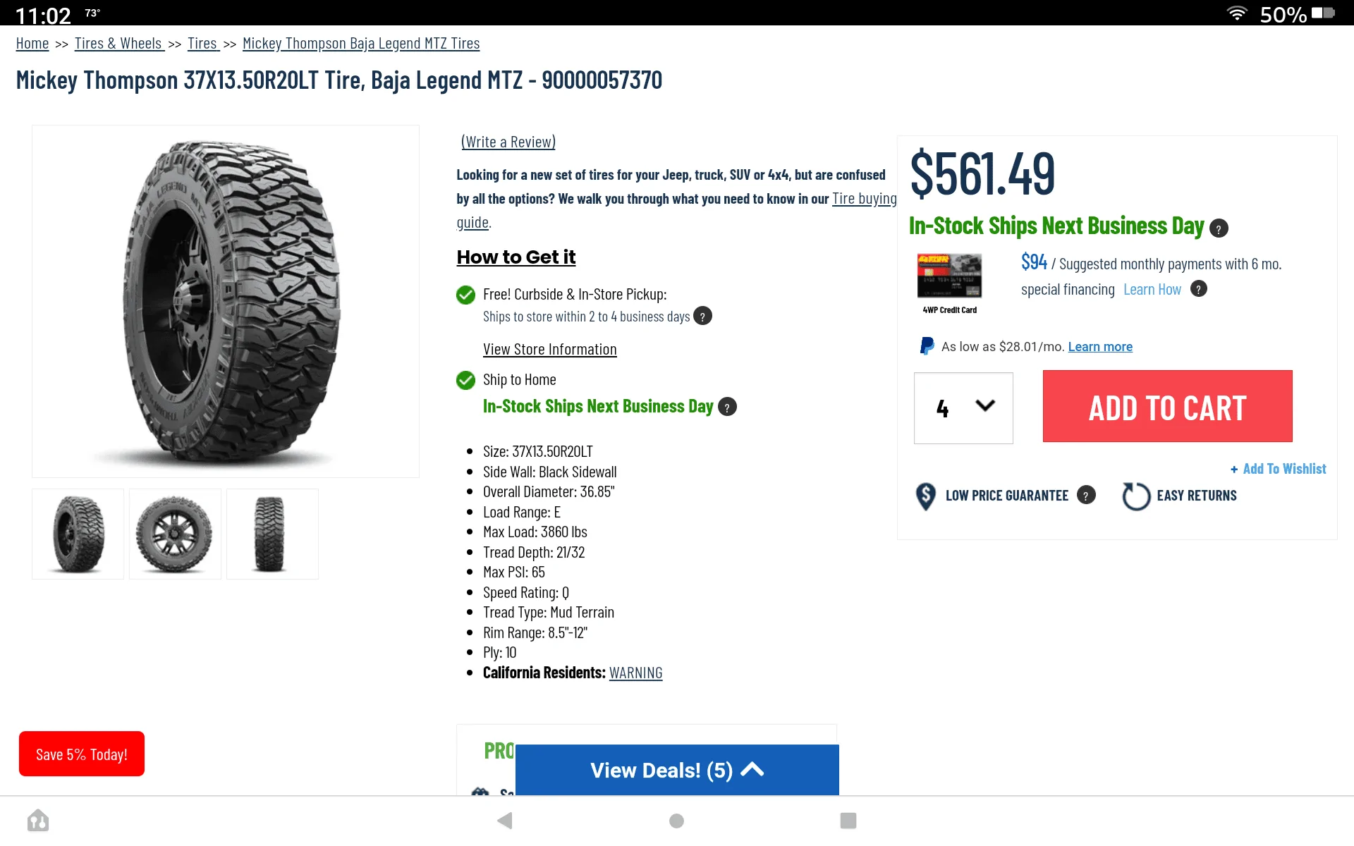

Here is my tire size and under the description second from bottom it says 10 ply. Just saying it still is as advertised. Most tires online include anywhere from 6 thru 14 ply.
yep, 10 ply description is for those of us who have heard of bias ply tires ;)

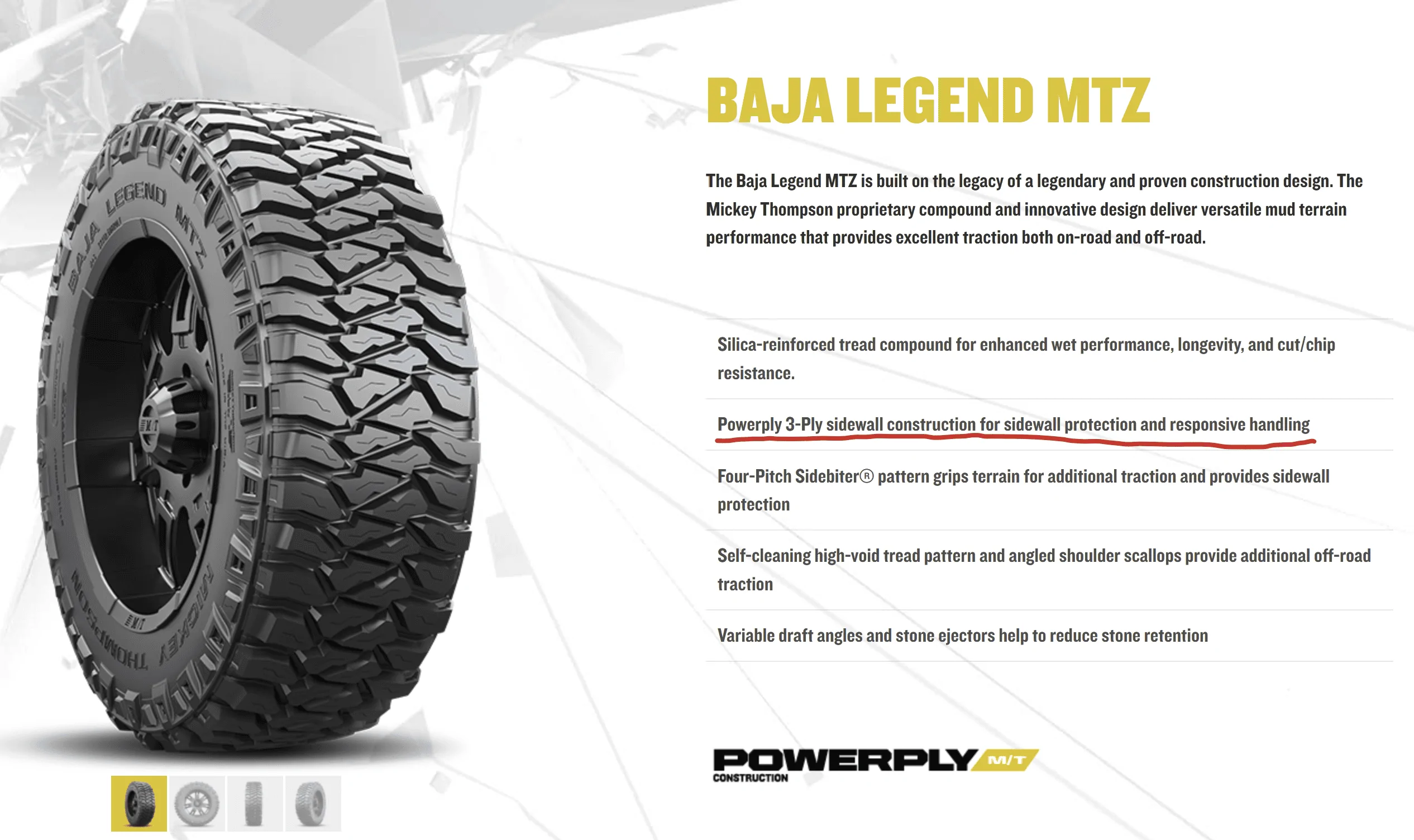

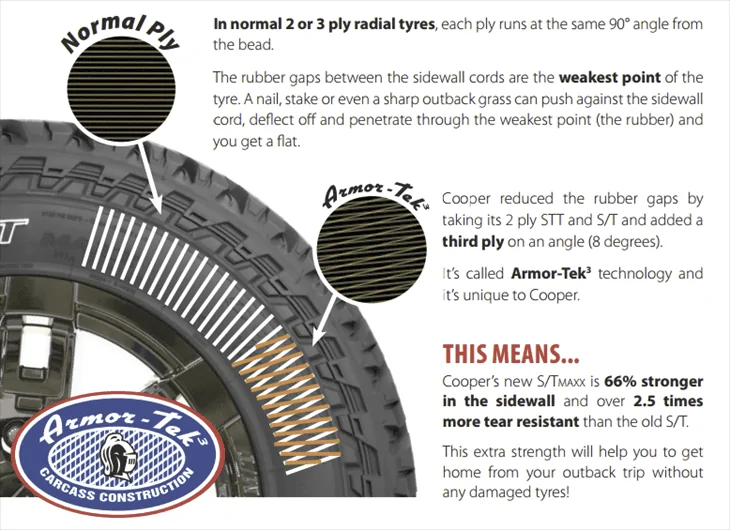

The MT MTZ (made by Cooper tires) uses a 3 ply sidewall where the 3rd ply is oriented at an angle to the other 2. Offers greater protection then orienting all plys in the same direction.
It was one of the reasons I went with the Cooper STMaxx on previous 4x4 and am looking at the Mickey Baja Boss AT for the Bronco.
