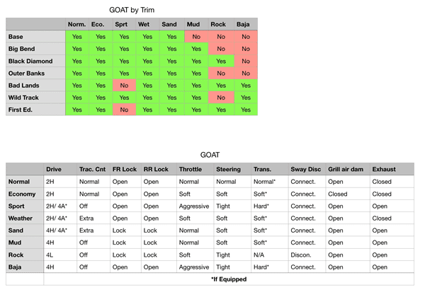

What's the exhaust column about?
Probably fake “engine noise enhancement” like on the Bronco Sport - there was rumor about a resonator though - idk if it actually went on or not

I assume that "Wet" is "Slippery", because my 2022 BD doesn't have wet!?
Yeah - I think they just threw the chart together and figured it would make sense. Mine is also Slippery, and Sand is Sand/Snow - but I think I can kinda figure out what they are getting at.
I shamelessly stole this chart from an old post around here somewhere, so I can't take credit for it's creation or original posting. I don't have a link to that post right off hand, I had saved the graphic so I would know for my own knowledge.
Well, it IS ford, so maybe wet=slippery to them (slippery when wet), and thanks for the clarification!
True - I know it threw me for a loop seeing Slippery, then seeing Sand/Snow thrown together. I think it's different on the Bronco Sport - where "Slippery" is a picture of a snowflake, and Sand is just Sand.
If ford thinks that driving in snow is the same as driving in sand (I guess there are some similarities) that explains a lot about ford!
