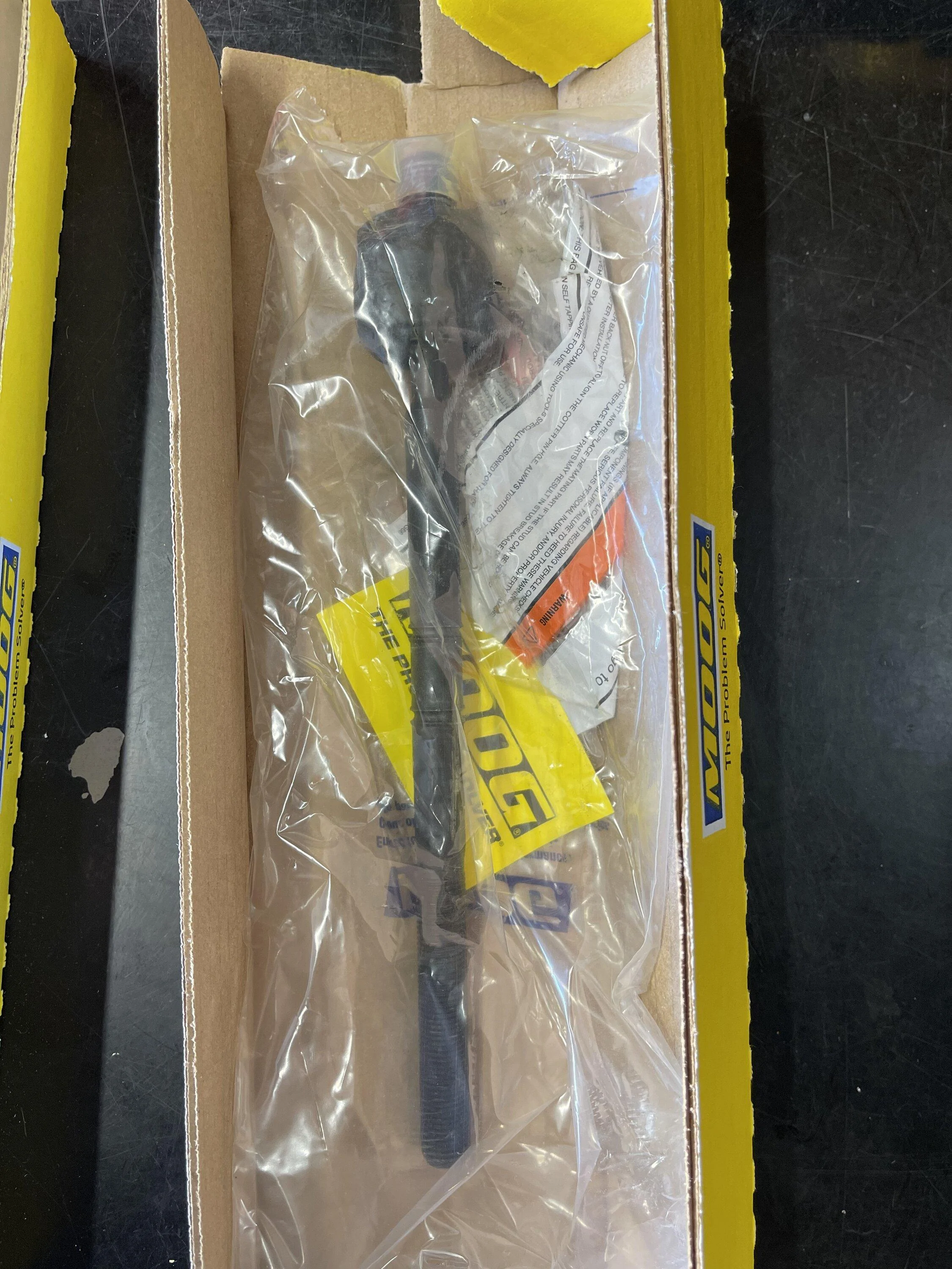

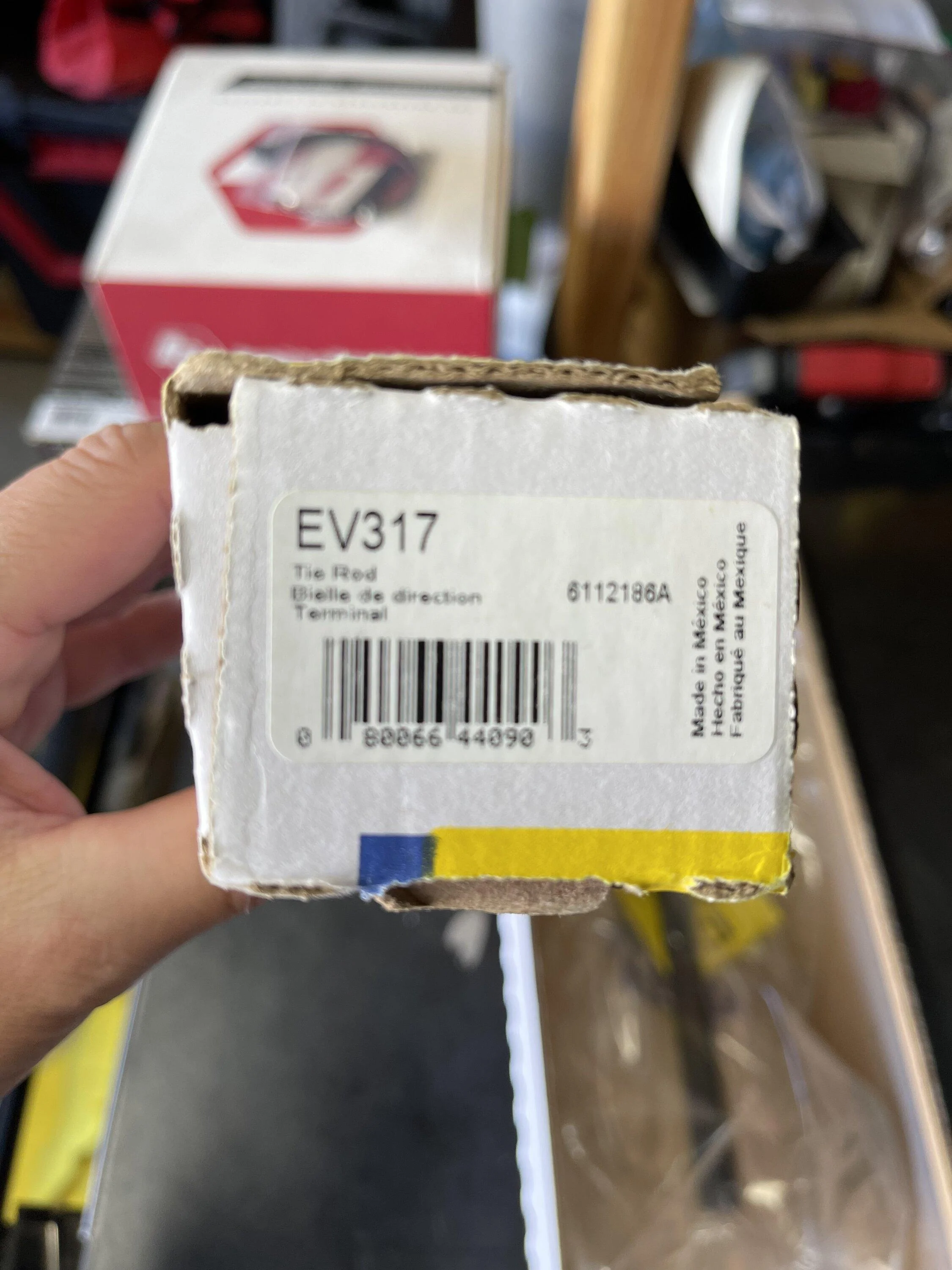

So I got these Moog EV317s off of Amazon. Can you confirm if these will work as a good on the trail backup? Thanks for your help and sharing your knowledge.
Tricky Dick
Dick
Apr 12, 2021
88
7,503
25,546
PNW
www.TD-Distributing.com
Ford Bronco Exploring off-the-shelf tie rod upgrades 4AEAA85B-9F3C-466A-BC99-C09FC842F783
That's exactly what you want.
