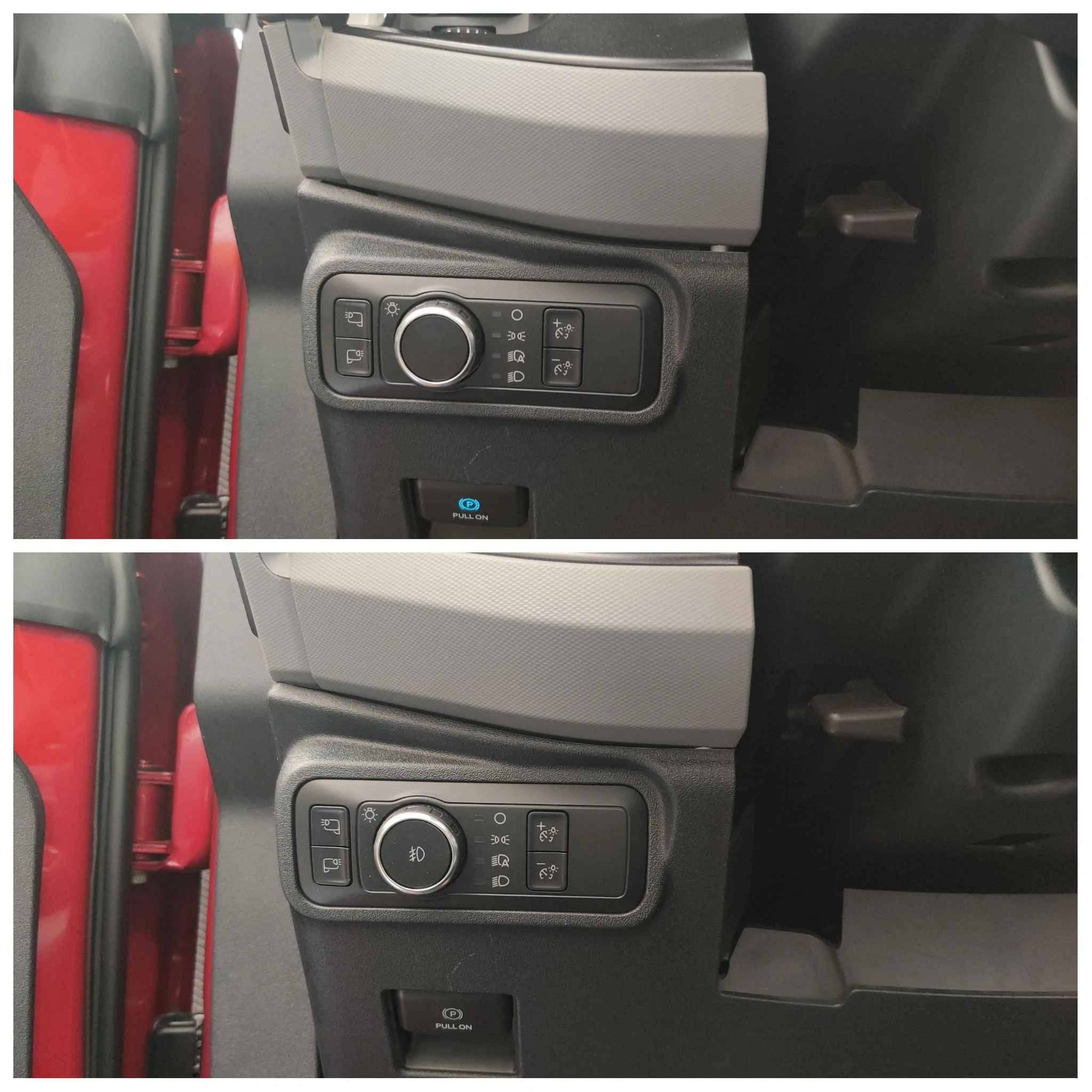

Took literally 50 seconds. Lol. All functions work seamlessly. So we'll see in a few days of it throws a code. By the way, perfect replacement. Even had the mirror light buttons vs some that have gotten the gas and trunk button. So I didn't have to switch out the buttons!
I think it you run a diagnostic scan, it'll mention the fog lights to electrical to ground issue or something, but you don't get any MIL's or anything.
