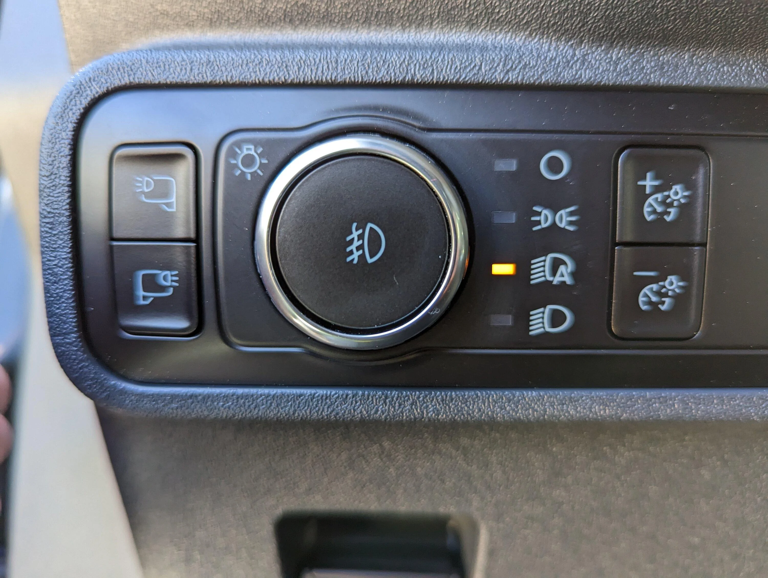

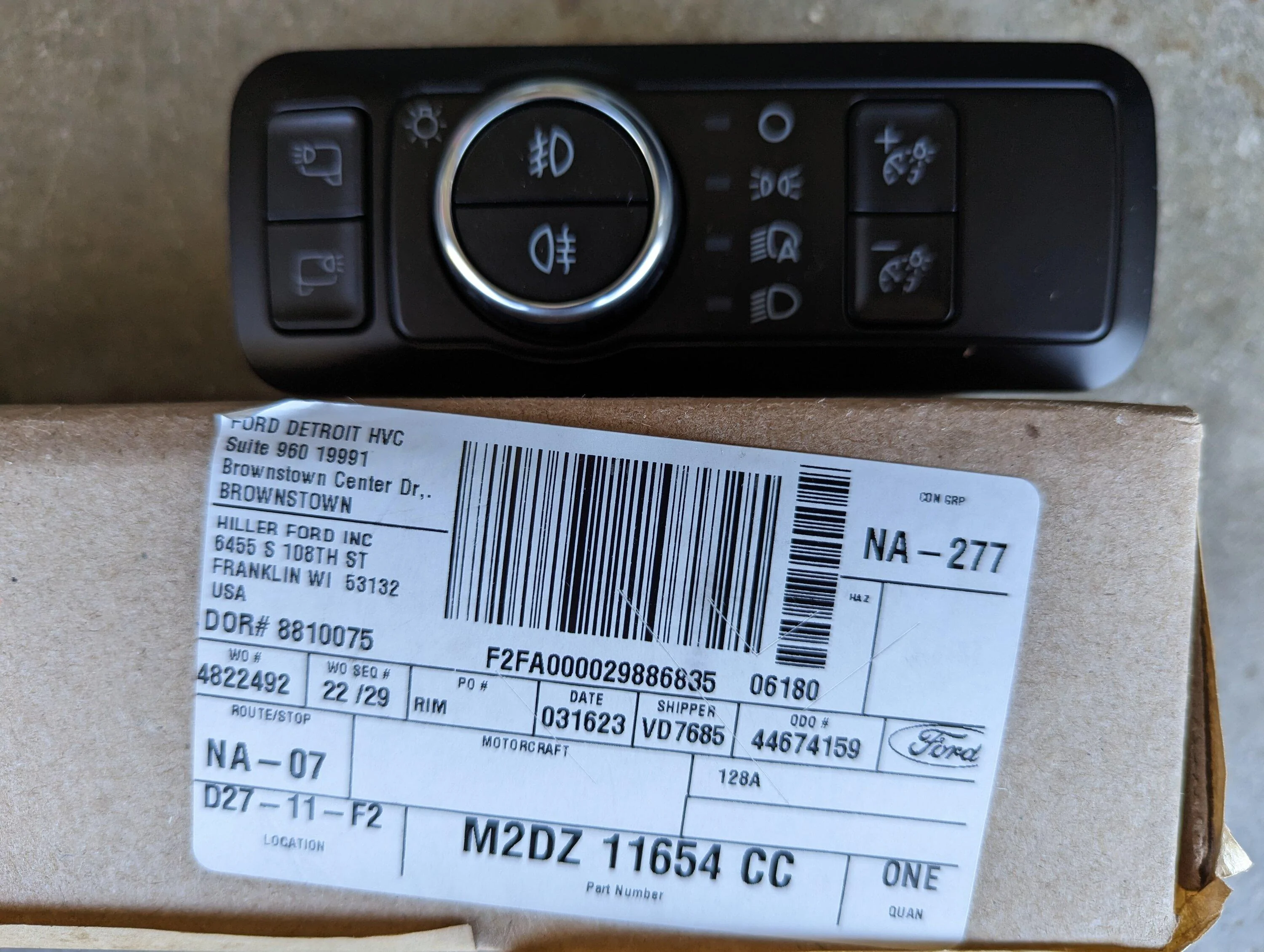

If you have a fully loaded wildtrak, and you wanted rear and front fogs, would you use this part?
M2DZ-11654-CC
Yes.
I have a Badlands, high trim with front fogs, puddle lights, etc. This is the right switch to order for going from front fogs to front and rear fogs. I have one on the shelf that I ordered a few weeks back.
In the second picture below, You can see the dealer I ordered from where I was able to purchase w/o being required to provide VIN.
Original in dash front fog only switch:

Replacement front and rear fog switch - M2DZ-11654-CC:
