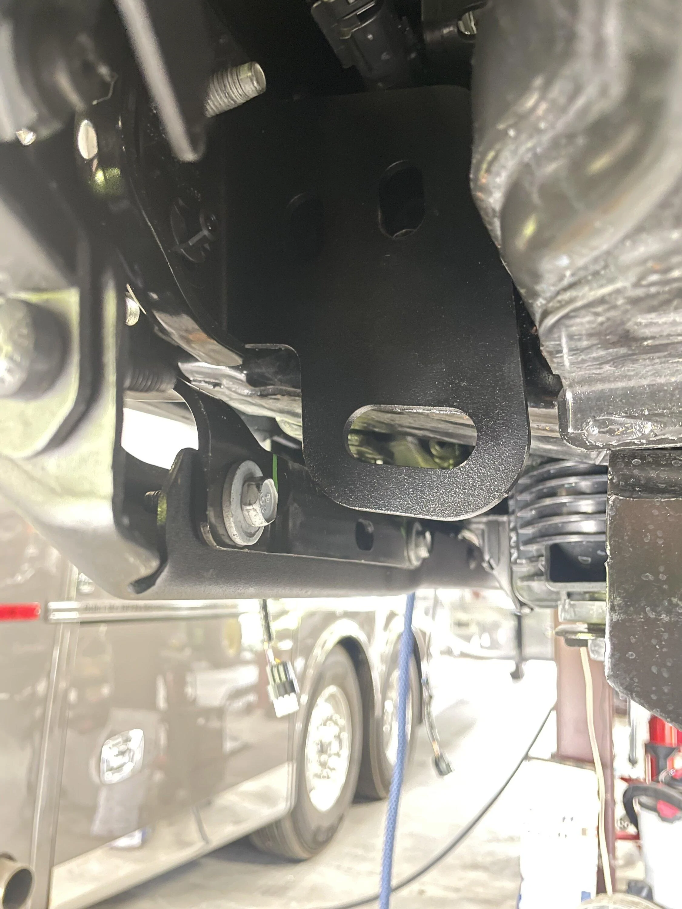

Is anyone using the LOD Offroad front bumper frame tie(bft2101) with their mod bumper? I do like that it gives a place to hook safety cables. Just got my new 23 WT and itching to get it hooked to the motorhome.
yep worked good added couple rings to extended down on raptor due skid plate
Post #526, I had to cut notches in the bumper of my OBX to accommodate the LOD brackets. But it looks like different trims have different bumper clearances.
