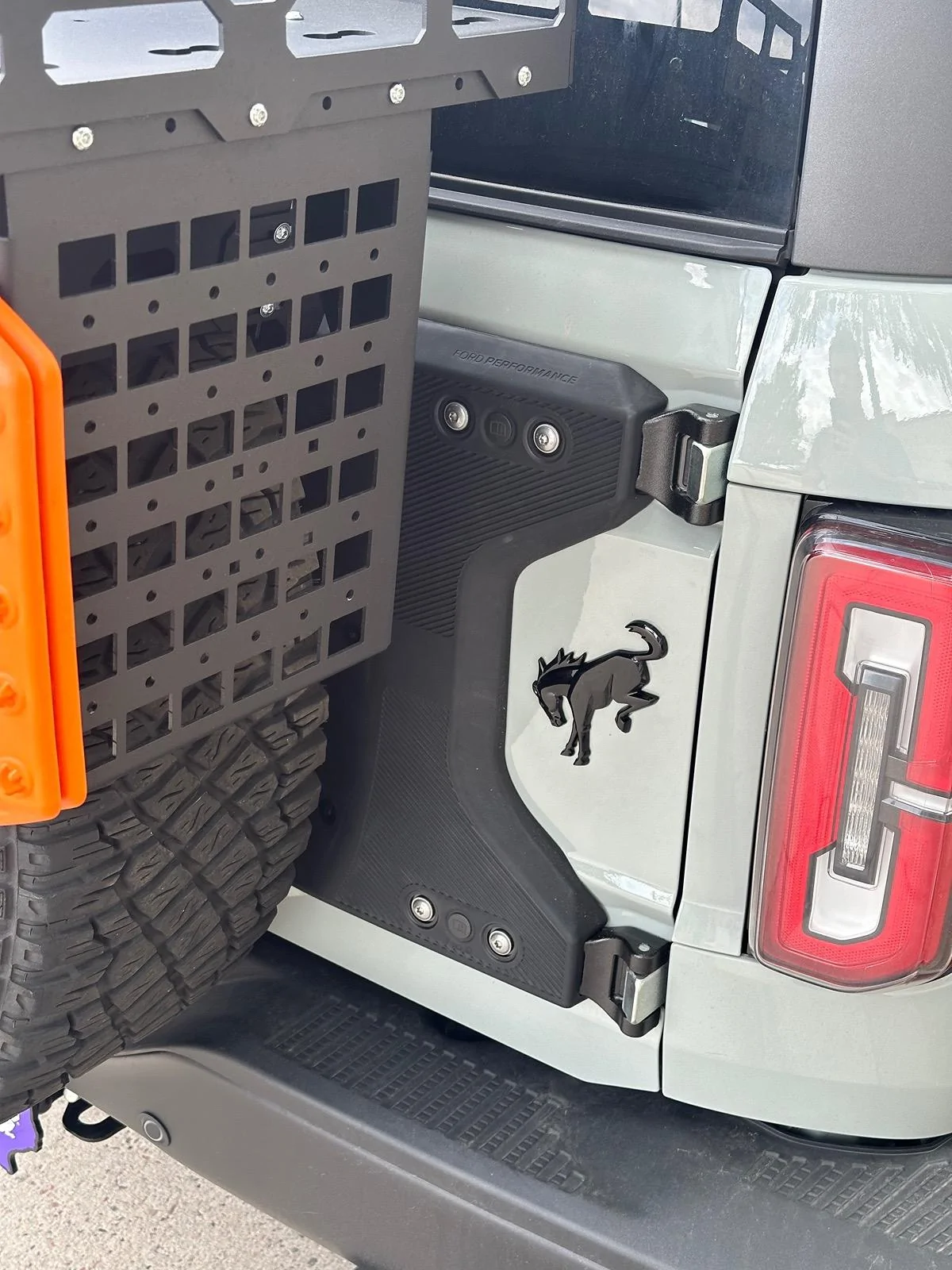

Is Buckleup off-road selling yours but rebranded? It looks identical and works on non squatch and sasquatch.

Oh wow... Just noticed that it states "non-Sasquatch"... I wonder why?
I'm pretty sure I've seen this installed already on Broncos with Sasquatch and even aftermarket wheels... 🤔
Several guys with SAS packages have reported to me that it didn't fit SAS.

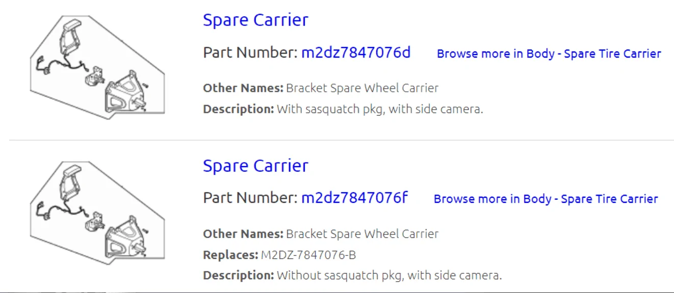

FYI, the spare wheel carrier is shorter on the Bronco SAS models due to the SAS wheel backspacing. So OEM SAS wheels probably can't be used unless you add additional spacer to the carrier mount. But +0 offset aftermarket wheels might be OK.

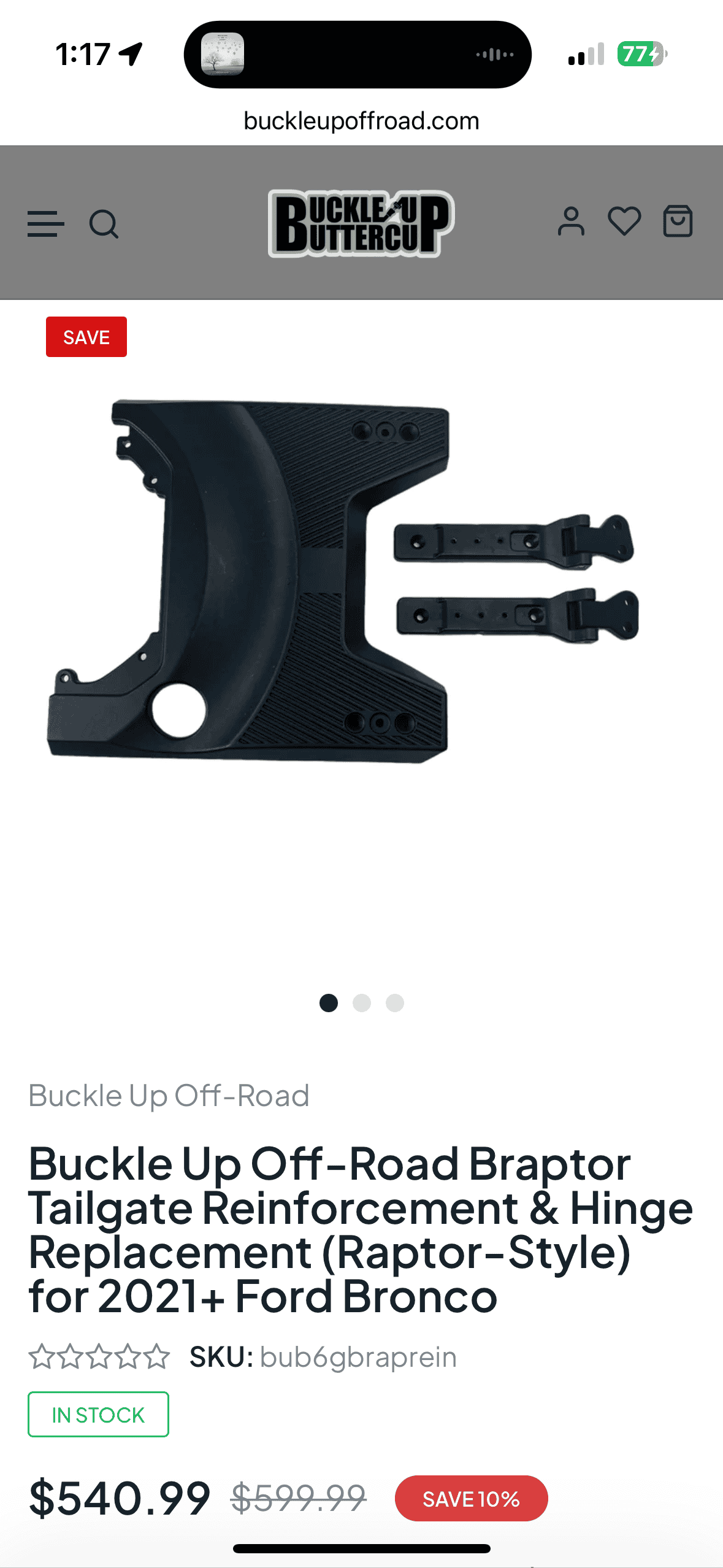

Mabett is just a white label reseller not a designer, so it is very likely that BuckleUp is selling the exact same thing. And it is likely that in a few months there will be a few other sellers on Amazon selling the exact same thing and undercutting Mabett on price. Anything that he sells that has been on the market for a few months is usually available from a few other sellers at lower prices. This is not meant to be a ding on Mabett, he is usually first out of the gate with these products, offers decent intro discounts, and supports his customers. That is worth a bit of a premium. And at the moment Mabett sells at $150 discount relative to BuckleUp (for as long as the $100 coupon remains in place).
Where did you see that the BuckleUp one comes in SAS and regular versions? I see nothing on the product page.
I’m a fan of mabet for a lot of their stuff and I agree.
Buckle up only makes one version and it works on both styles.
That was one of the main reasons for my question. I’m sure both carriers come from the same factory so are we sure the Mabett version doesn’t work or was it just user error?
