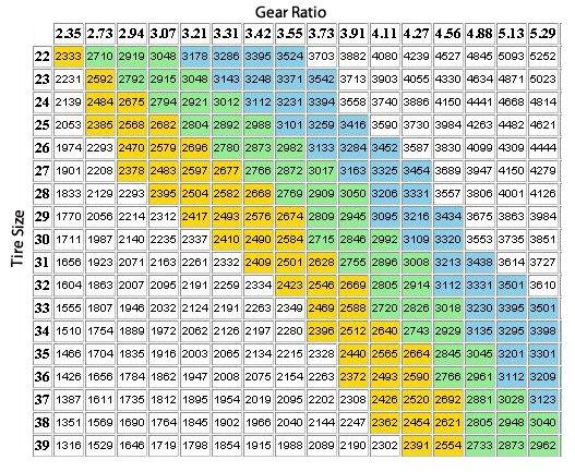

In reading through the forums I've seen a few comments about the 3.73 gearing and stock tires (in my case P255/75R17) that sound like if you go with 4.27 that you'd actually be better off with slightly larger tires for power, MPG, etc. Is that correct? When I eventually get my Bronco my original plan was to switch out the 255/75R17 tires for 285/70R17 and stick with 3.73. Having the locker would obviously be handy when off-roading but from a gearing standpoint would it make much difference in MPG if I went with 4.27 and the larger 285 tires? Thanks!
