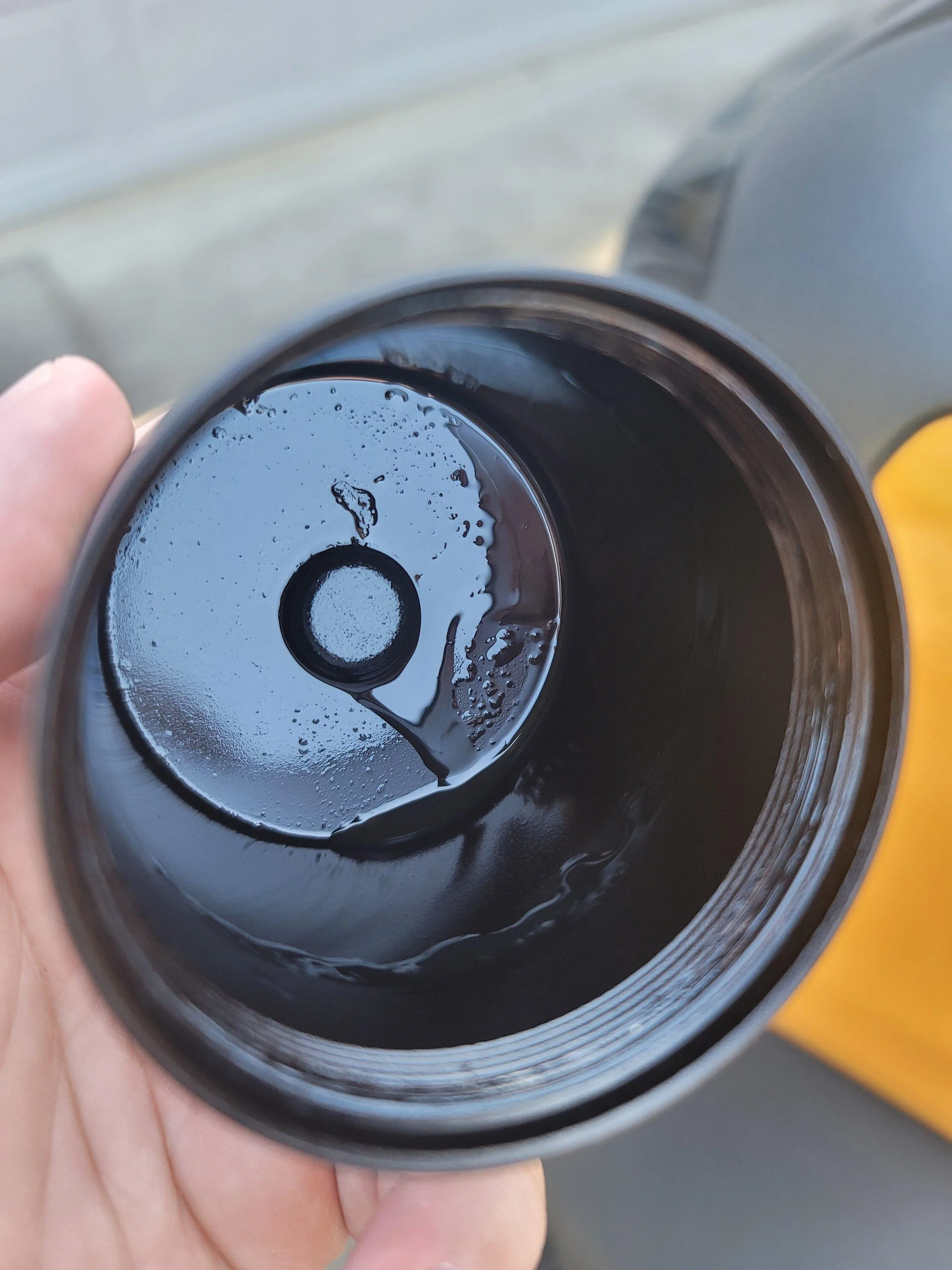

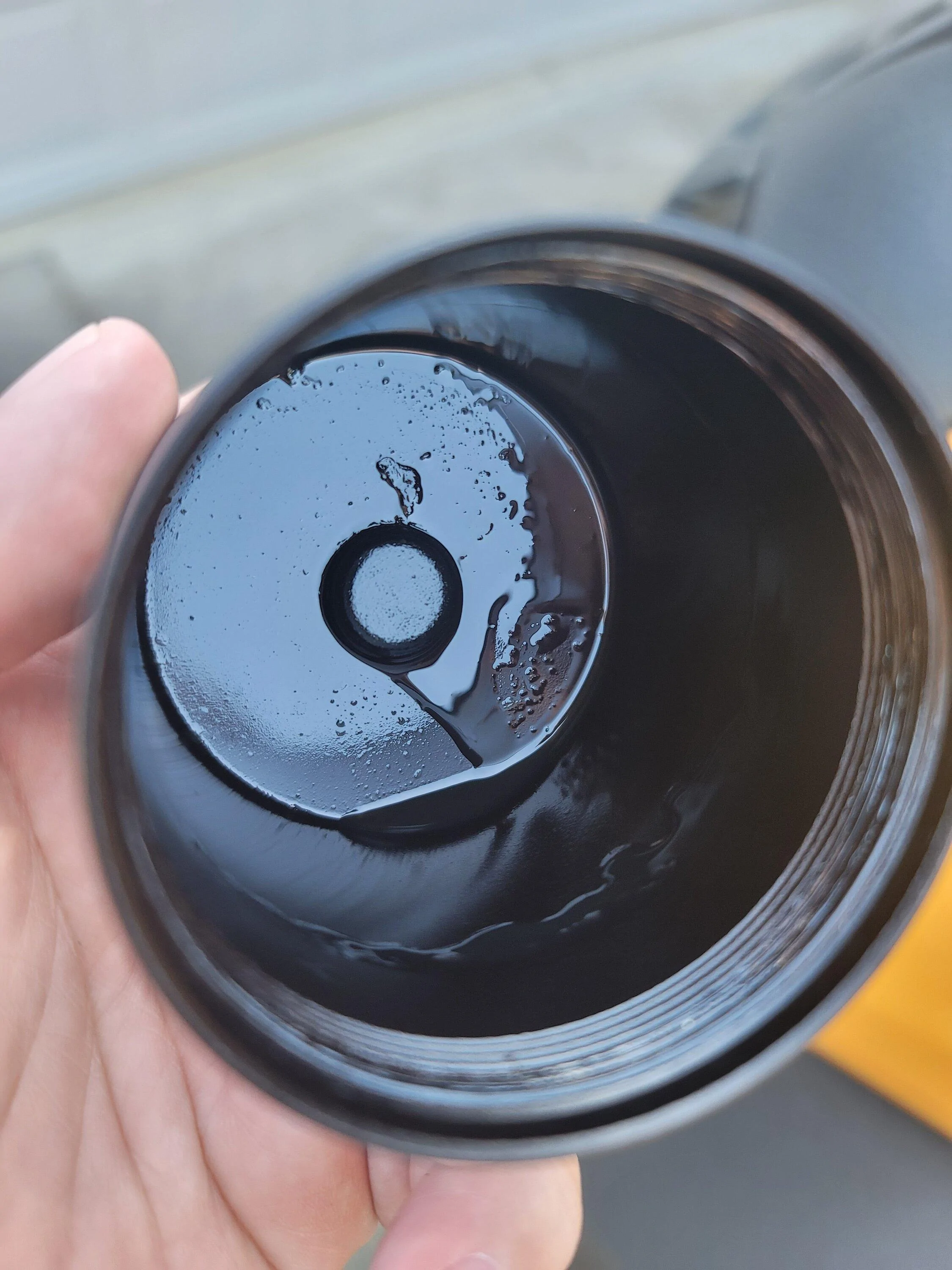

So I pulled mine off to make sure I wasn't an idiot (which is usually the case) and found this after about 2500 miles. I guess it goes to show they do work on the 2.7L if anyone is questioning whether to use them or not. Oh and I am an idiot as they do have a drain plug in the bottom and I just hadn't remembered. Lol

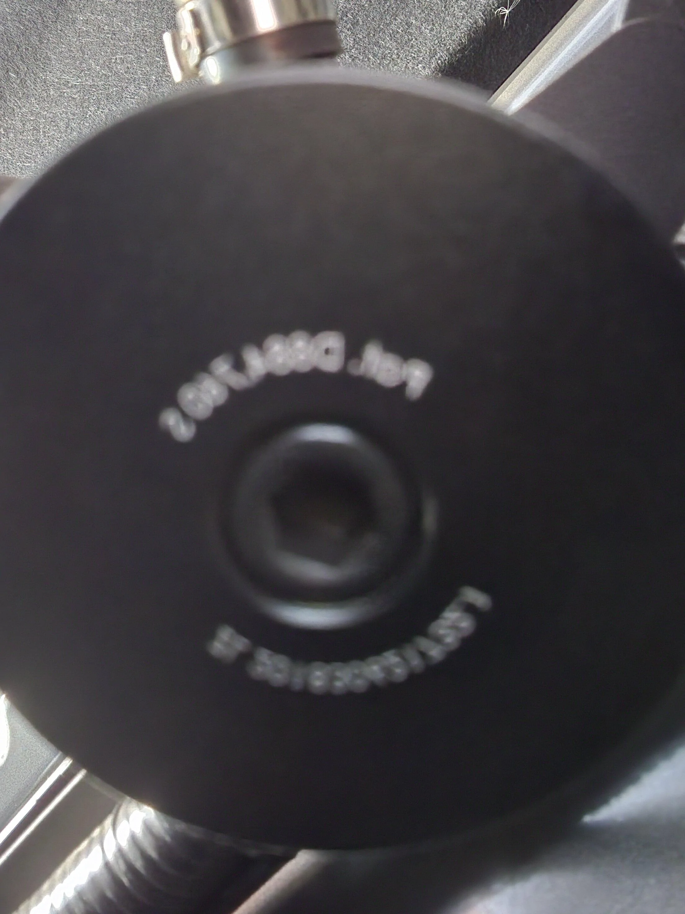

Ah ha...I am not crazy... I just checked and yes both my Mishimoto cans have drains on the bottom.
Blurry pic for your review...
Ford Bronco HELP!! need to remove the CCV line to  double oil catch can 20230429_130132
Mine also has those hex drain bolts. Mine are tight.
Just checked both can drains
Both tight
Still have CEL
P051B
