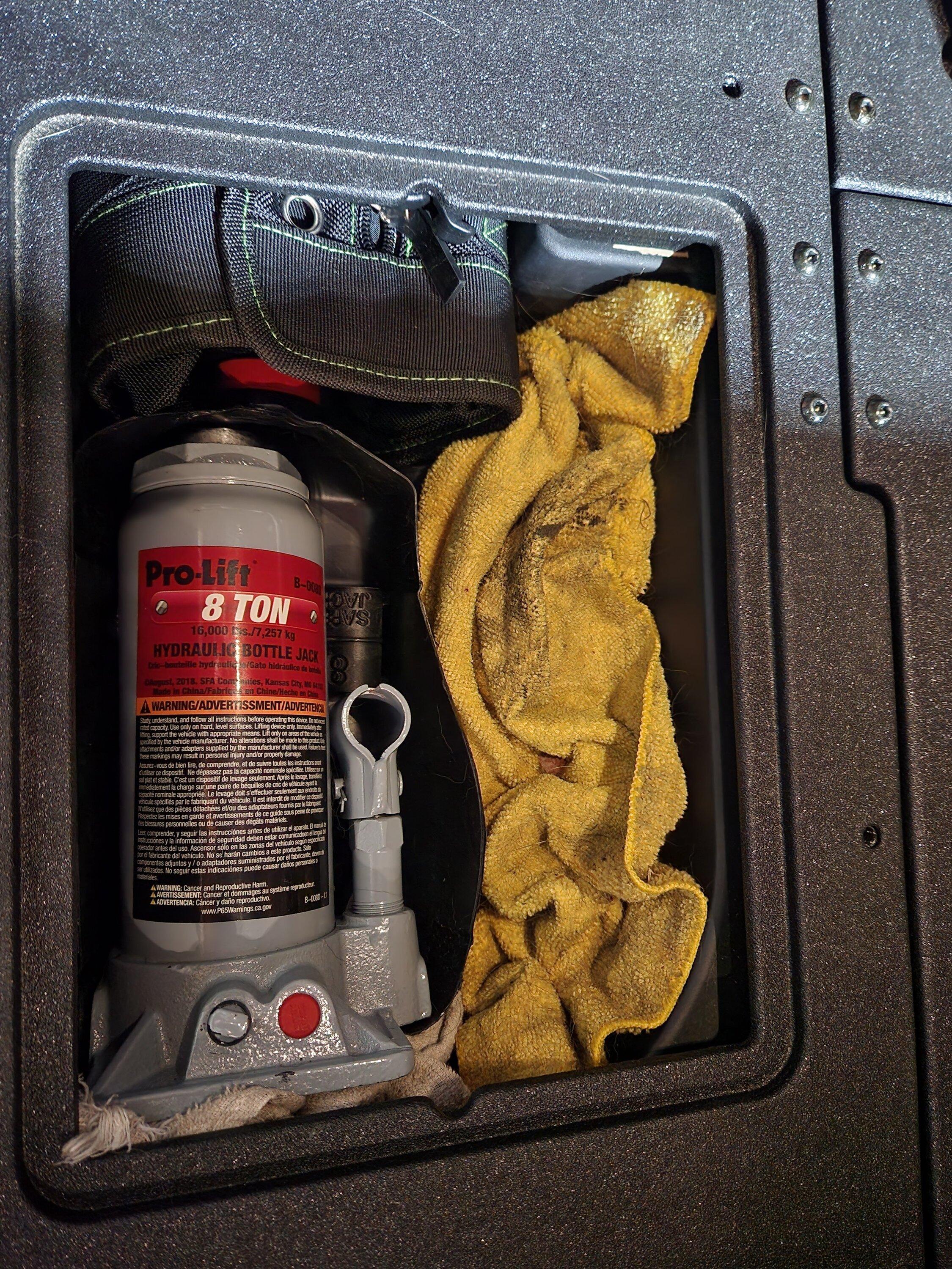

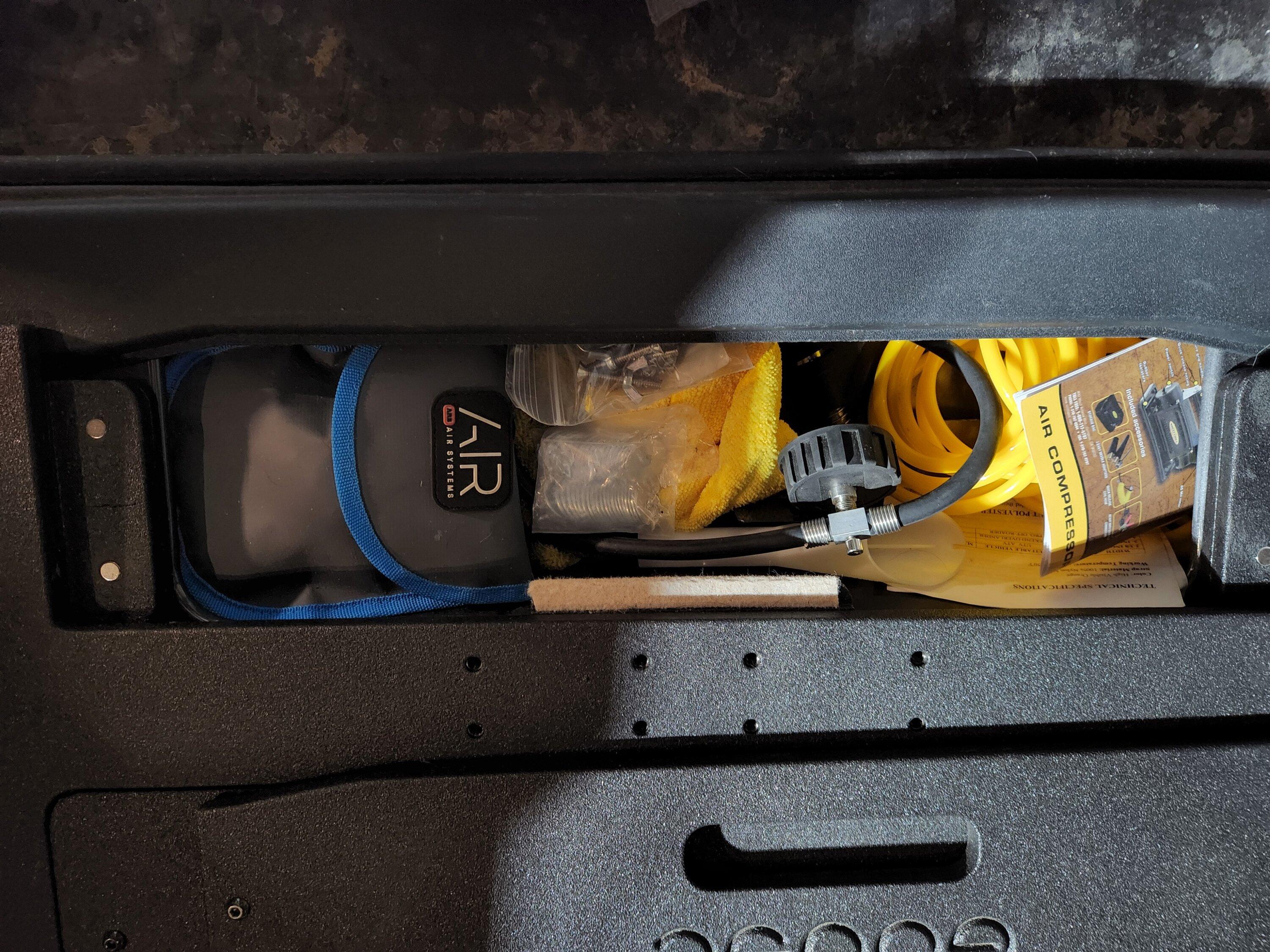

I have the GooseGear platform which gave me about an inch or so of additional height from bottom of cubby to underside of cover...with that, it is a perfect fit in the front cubby. The extensions all fit (along with my tire wrench extensions and sockets) in a roll up Rhino bag to the driver side of that cubby. I cut out a section of an Amsoil container in which the jack fits closely in case of any leakage.
I now use the rear cubby for my air hose/deflator/etc. The rear cubby has wonky brackets in it for the OEM jack that make it tough to fit much of anything else in there.
