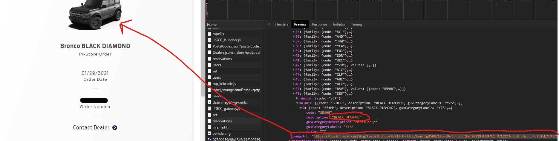

Checked it out, all my details are there, which is reassuring. However, it's been bothering me that the vehicle pic is still a BB, when I'm ordering a BD.
Looking into the code, it would appear all the details are there for pointing to a BD, however, the image URL is pointing to a BB.
Does anyone have a pic of a BD? What's the URL for your pic? (right click on image and select 'Copy image address' in Chrome)

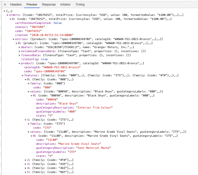

The same way you can look at the source code of your Ford.com Order/Reservation page to find your exact timestamp, you are also able to dig into the code and see what your order is.
::UPDATE::
It appears people are having mixed success with this working. One theory is Ford.com is being updated on the backend, and this trick is not available on everyone’s profile (yet?).
Additionally, this code may only represent what the initial reservation/order was made for, and not what is actually in the order system after a change or update... though some people are reporting their updated orders are accurately reflected.
What your dealer provides you from their ordering system is always the GOLD STANDARD and you should communicate with them to make sure they have submitted what you want.
It's not pretty, but here's an example from mine showing the tree:
Ford Bronco Look up your order details through the Ford.com website code. 1616000510500
The process is very similar to checking your exact reservation timestamp as explained here: https://www.bronco6g.com/forum/threads/timestamp-timezone.12533/post-457542

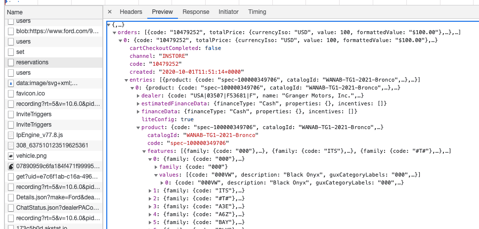

Heres's the directions:
1. Login to your account on Ford.com using the Chrome web browser.
2. Navigate to your Bronco reservation.
3. Hover the mouse cursor over this screen, then right-click and select "Inspect".
4. Select "Network" in the inspection pane that opens to the right.
5. Hit CTRL+R to reload the page.
6. Scroll down through all the "Names" under the "Name" column, until I came to the third "reservations". (the first two didn't have the information that I was searching for)
7. On the right side of the screen, select the "Preview" tab.
8. Open all the carrots carets (little triangles) by clicking once on each one - I found the information embedded under "orders" - then "0" - then "entires" - then "0" - then "product" - then "features" - then open all the numbers below that list a "value" for each item... there may be some sub triangles to open that reveal more specific info.
Here is the tree:

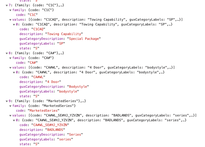

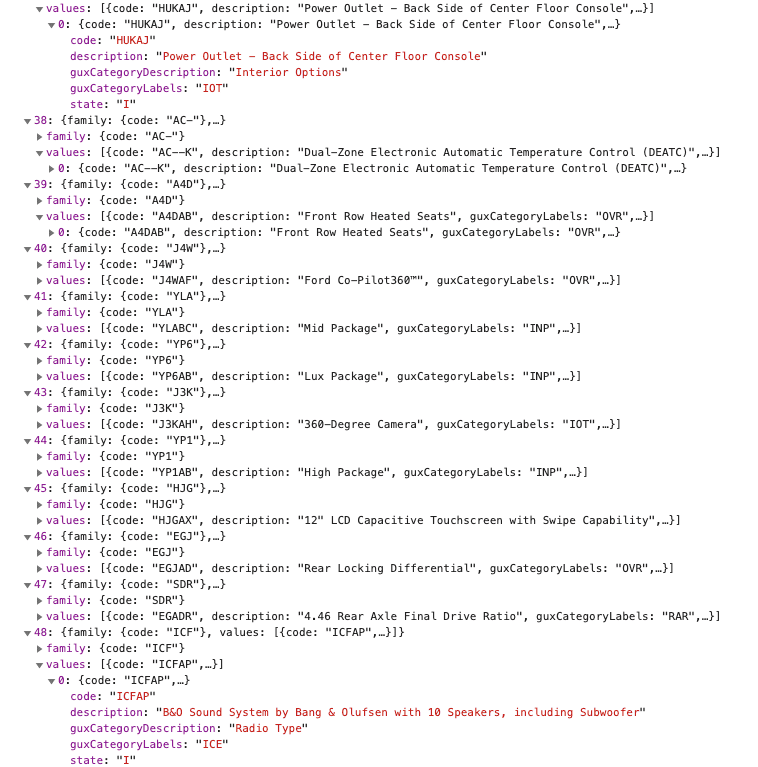

Each one of those numbers lists a different line item. Click on the number and then on "value"

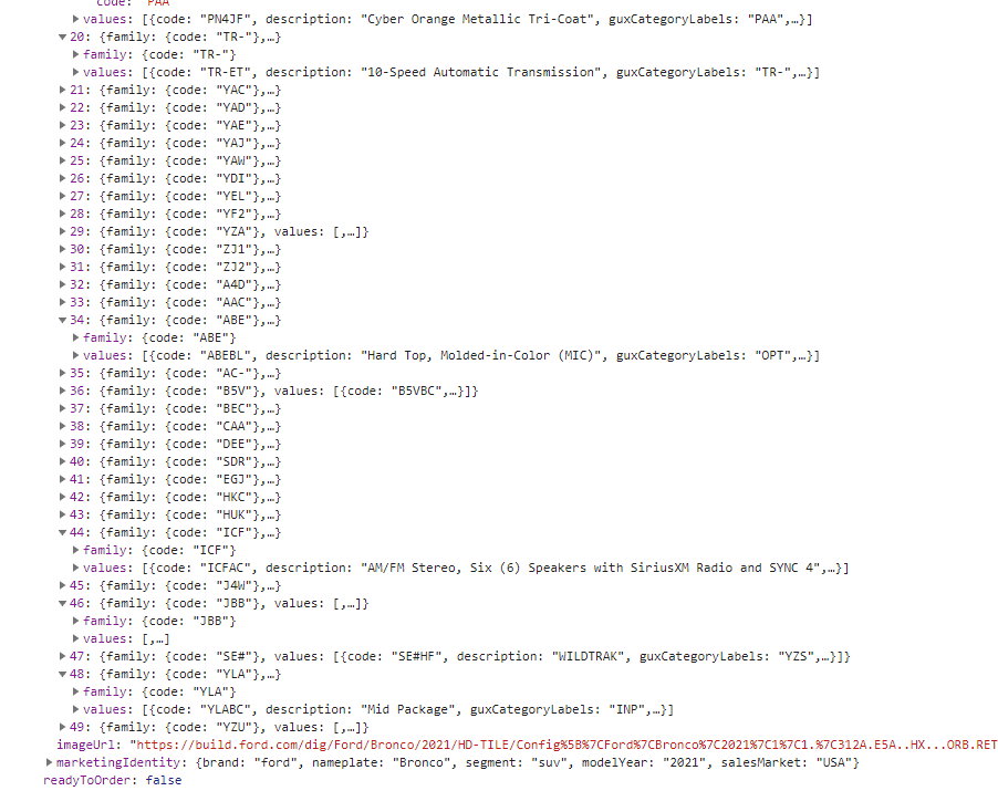

I am starting to believe these codes show the initial build data, as well as a few other "current" things like if it's been ordered. My color is wrong, something I never chose. But I recall that color was the "default" when I started playing with the build and price tool. The color is not what my dealer order sheet shows, nor my Ford confirmation email. The Modular Painted hard top also not on the HTTP page.

mine looks like the original order that i place when we went in to order. I asked to add leather and lux package and was told it was all set. do we know if this updates if they make changes? (sorry if i missed this answer)
neat seeing that the information is actually there.
Ford Bronco Look up your order details through the Ford.com website code. 1616077663653
Ford Bronco Look up your order details through the Ford.com website code. 1616077722669
