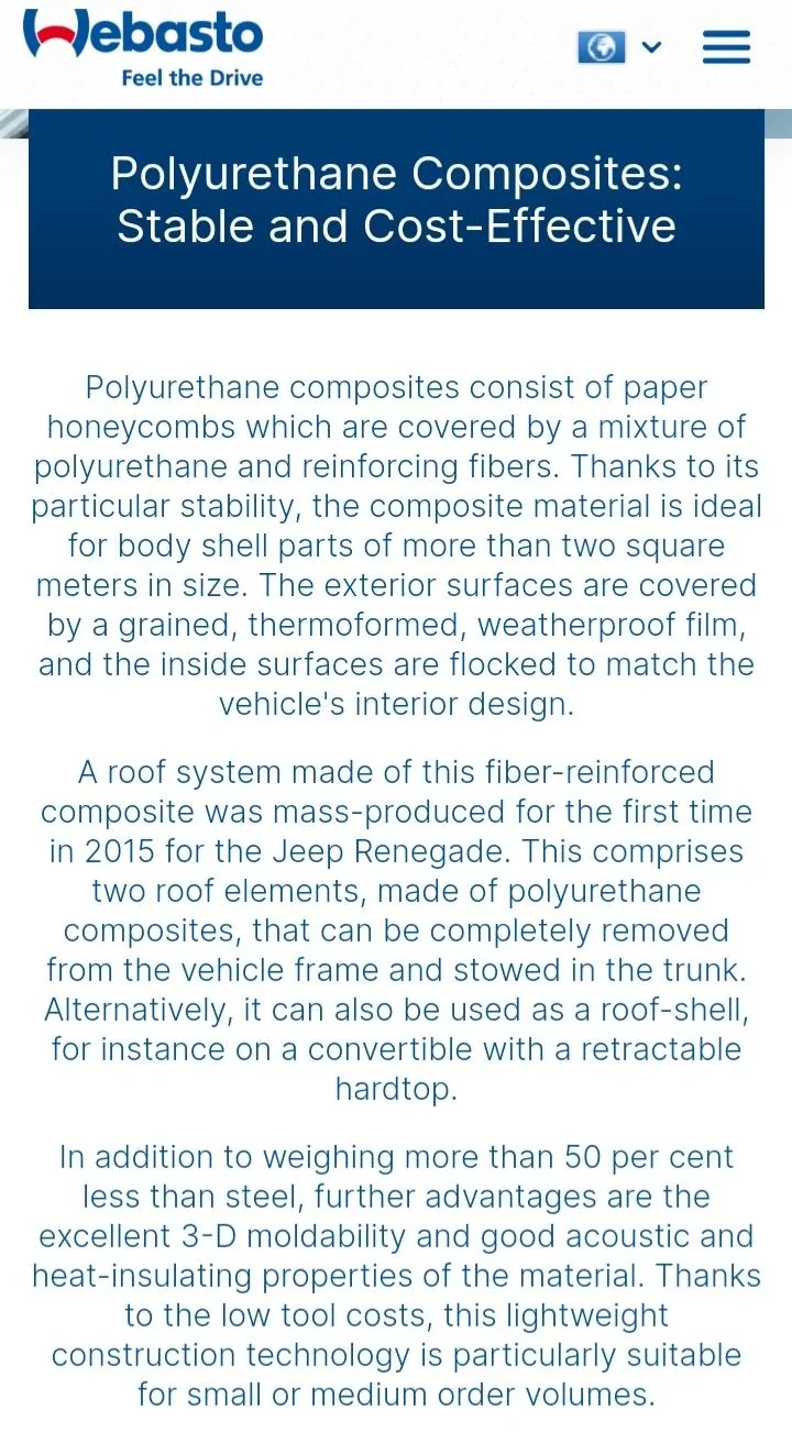

I would venture to say this is the material that a lot of the members on this board are claiming is cardboard. It took 2 minutes to search and find this, and I really don't believe an advanced car company beholden to its investors, would produce $40-60k vehicles with cardboard reinforcing the top...just sayin
I wish, she's cardboard unfortunately, this is from Webasto's sell sheet on the product.
Ford Bronco MIC Top 1.0 inside construction & material (cross section) - pics Screenshot_20211104-131117_Chrom

I'm no top expert, but the innards don't appear to be the problem, right? The issue seems to be the outer layer of construction.
All this hand wringing about what the inside looks like is fraught with concern but would be much ado about nothing had the outer layer been constructed better and more consistently.
Seems like misplaced angst, IMO.
This is a paper core coated with a resin to make your desired density core, i.e. 2, 4, 6 or 8 pounds per square foot. Worked the Aircraft industry and saw enough core to last two lifetimes.

I think the confusing part for me is why not just make a single-layer fiberglass top? Maybe reinforce the edges where the roof rack connects and put some decent insulation inside. Why does it need to be a composite sandwich?
Full disclosure, I know nothing about tops so there may be an easy answer to this.
one word; Weight.

To me the issue is not what's in the middle, its the inner and outer layers are too thin, and the edge seams are not well sealed.
