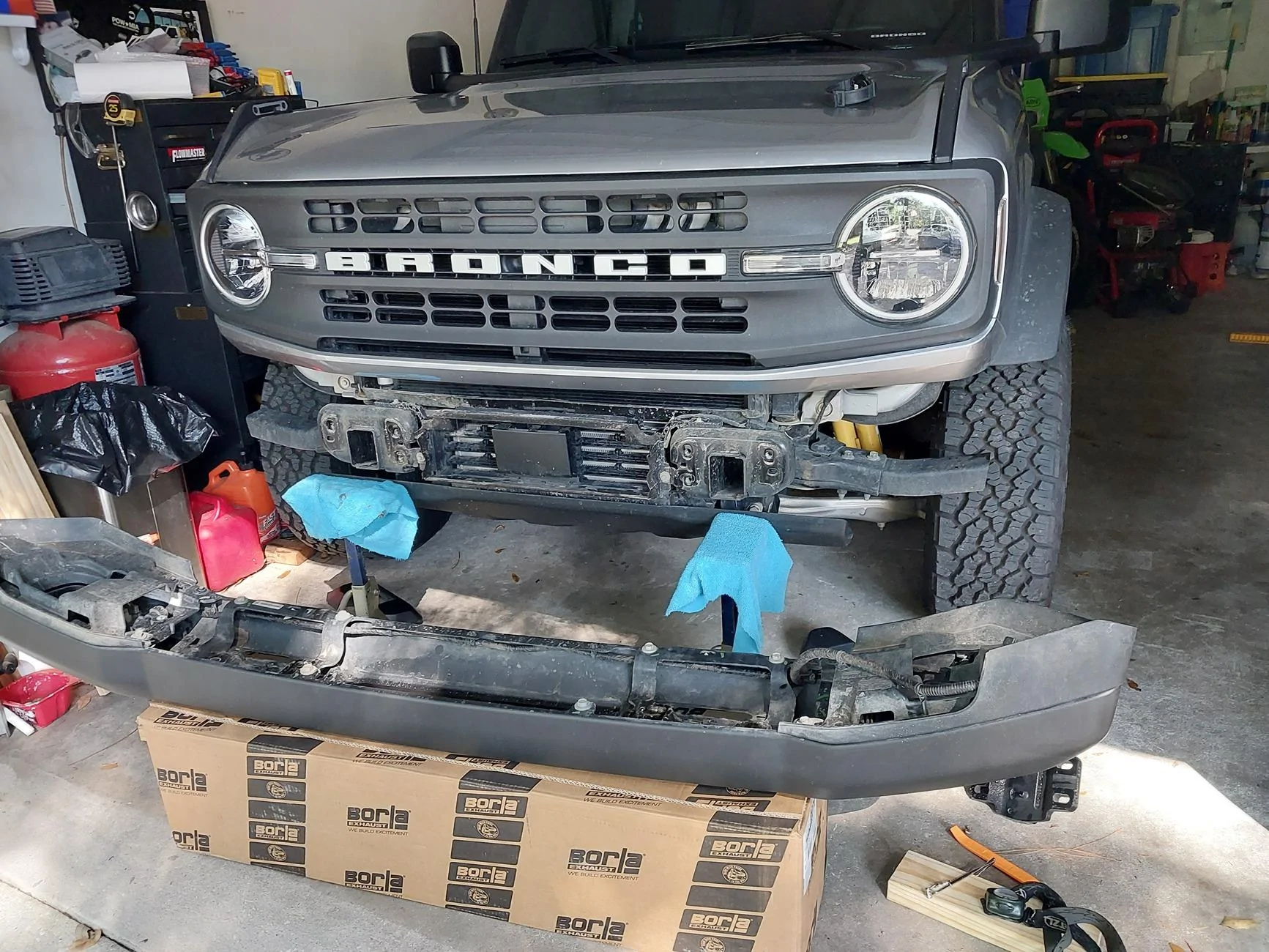

Do I have to remove the bumper to install the gussets? I don't have any options (stock black diamond) and I'm sure I can do it but I don't know if I have to.​
GI_Jo_Nathan
Jonathan
Jul 30, 2021
2,223
4,093
32571
Yes you do. It's pretty easy and doesn't weigh much. I normally support mine with a couple of milk crates and a cardboard box. Jackstand will work as well, but prone to falling off.

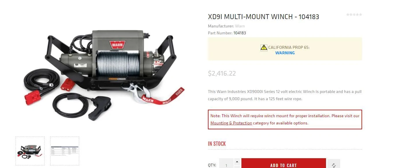

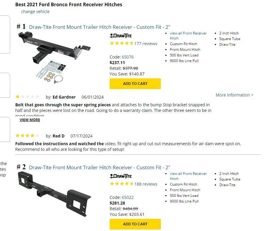

Hello everyone, my name is George and I am new to this forum. I have a completely stock 2021 Black diamond two-door 2.3 manual transmission. I was off the road exploring yesterday and I came to an area that concerned me. A chilling feeling came over me as I realized it wouldn't be good if I were to get stuck several miles from any roads or town. I realized that if I had a winch I could likely have continued. But as it were I turned around and went back home. So I checked out YouTube and saw a Warren Mount and winch combination that seem to be a bolt on proposition. I am asking for help and advice regarding buying a winch and mount that would be relatively easy to mount to my black diamond with the modular steel bumper and keeping it as much as is possible to a lightweight & simple/basic proposition. I am only concerned with a most basic winch setup. Thank you for your assistance, I am overwhelmed as I do searches. I am new to the four-wheel thing.
The most minimal winch setup??? Would be a front mounted receiver with a multi mount winch plate.............

You can use it in the back of the Bronc as well if you have a rear hitch mount and run some leads back there. 😁
One last thing in closing. ALWAYS remember to practice safe winching if not it could result in your death. Have a towel/old coat/hoodie/something over the winch cable. If it, or some other part, were to fail it will absorb the kinetic energy stored in the tight cable. If not dampened it can be a missile, and it will kill. :wink:
