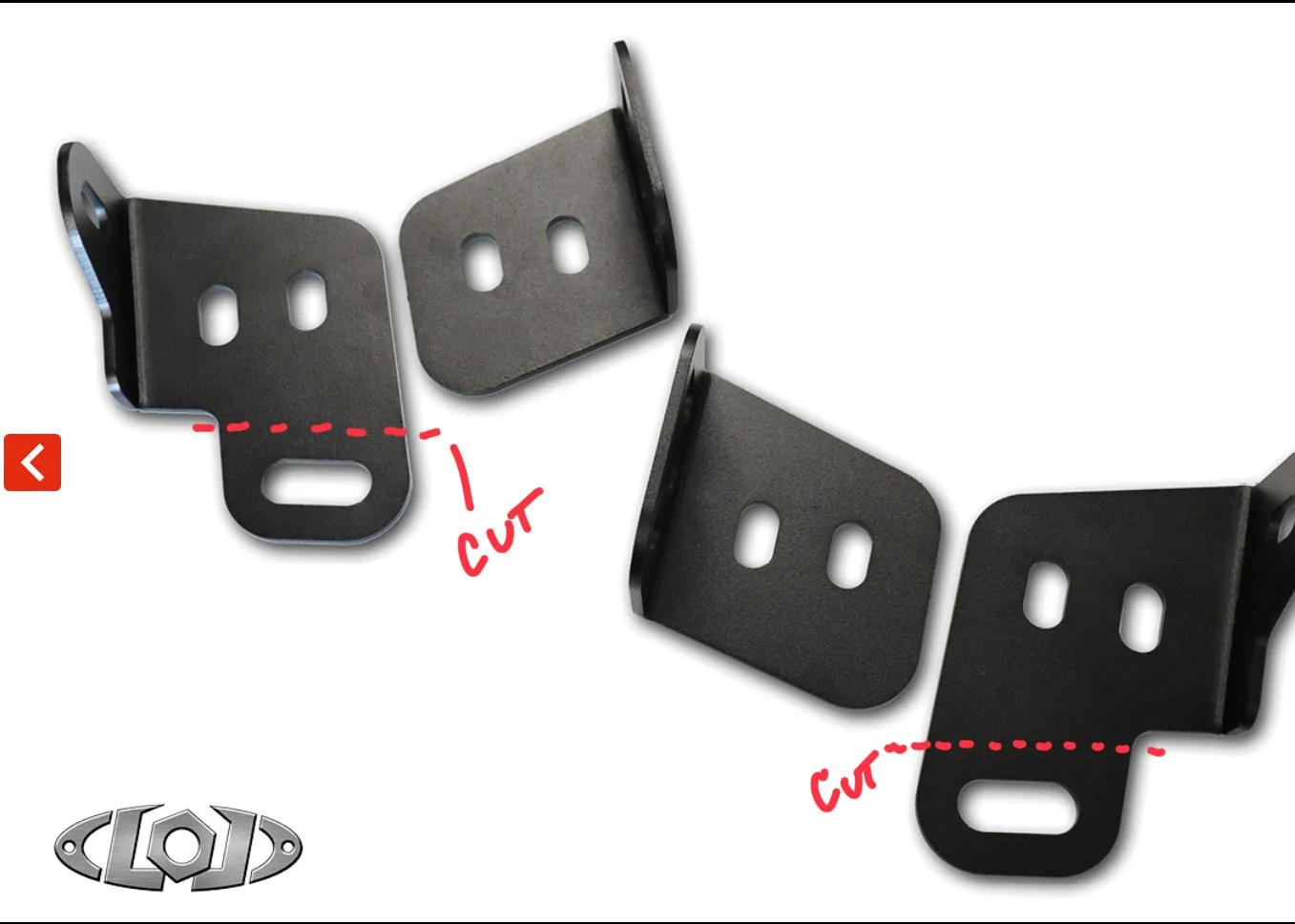

I can’t speak to the ADD ones but I can tell you the only issue anybody has with the LoD ones (myself included) is that there is a tab that hangs down on 2 of the brackets that has to be removed to prevent contact with the factory skid plate. It’s easily removed on the work bench with a grinder or wheel before installation.. I’d hit the naked edge with a can of paint afterward too.
Here are the LoD ones https://lodoffroad.com/products/2021-bronco-lod-front-bumper-frame-tie-in-brackets

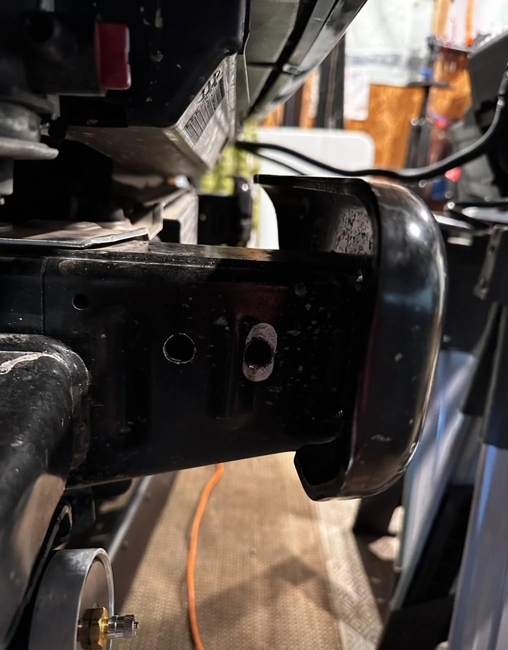

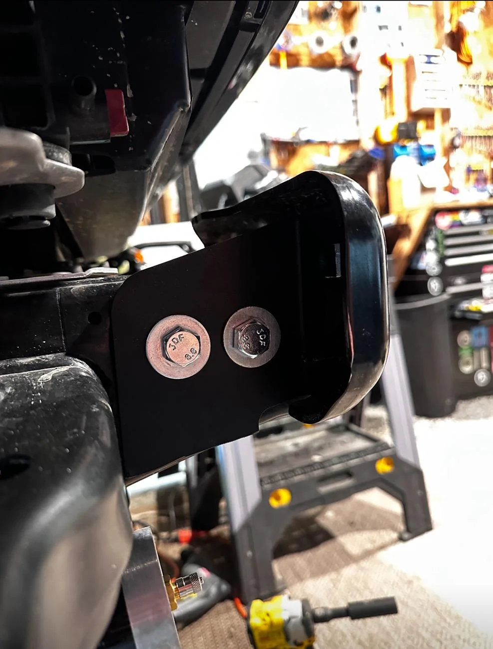

Here is a picture of where I had to cut. Also note LoD uses 2 bolts for each bracket piece vs. ADD’s 1

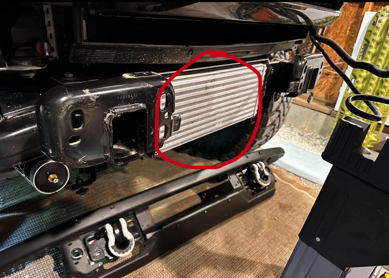

And yes, I drilled the extra hole through the frame after marking it by using the brace as a guide. With the bumper off it’s pretty accessible so wasn’t hard. Thats a big reason to do the reinforcements at the same time you do the winch/winch mount.. it’s all already off and readily available. I’m really struggling to remember the fine details as this was over a year ago but I also remember having to be real careful not to damage the fins on the oil cooler as its right in between the frame horns. Also I vaguely recall one or two of the holes being a pain as they’re right in the crush dimples or near them. Nothing you can’t do with a good drill/bit and some patience. I’ll attach the only photos I have of when I did mine

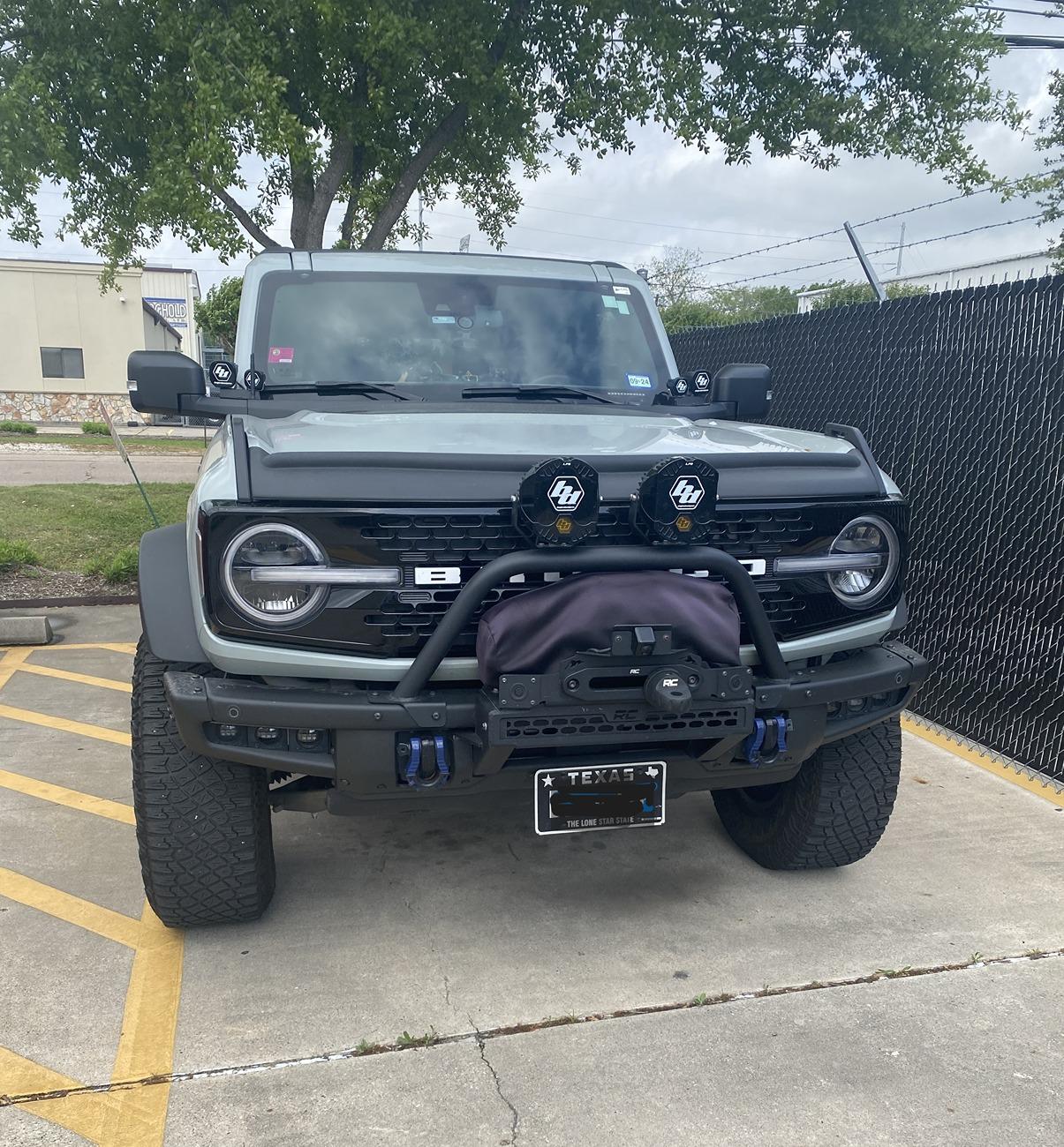

George, I was in the same boat with ya! Fairly new to 4 wheeling but I do get aggressive from time to time and wanted something similar to what you're asking for and surely never want to get stuck offroad somewhere when a few bucks up front for a winch would have taken care of the issue. I chose the Rough Country high mount that bolts directly to our bumper (same as yours) and their 12,000 lb Winch with synthetic rope. I chose the high mount over the low mount because I don't want to be rooting around in the mud or snow when trying to get to my winch. Just a little insurance policy in my mind! I do keep the winch covered so the rope isn't exposed to the sunlight all day long which can deteriorate the rope. Another factor is safety, most will agree if a winch cable is to break, it's safer for a synthetic rope to break vs a cable and they weigh less.
High Winch Mount | Ford Bronco 4WD (2021-2024) | Rough Country
12000-Lb Pro Series Winch | Synthetic Rope | Rough Country
Hope this helps!
