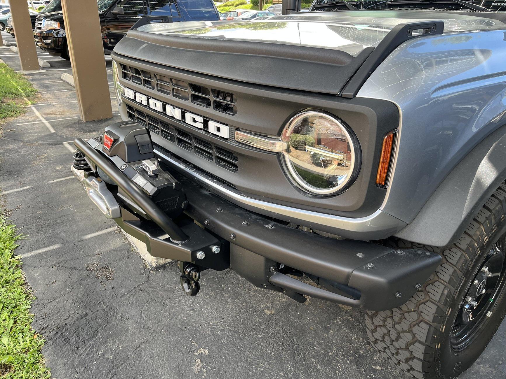

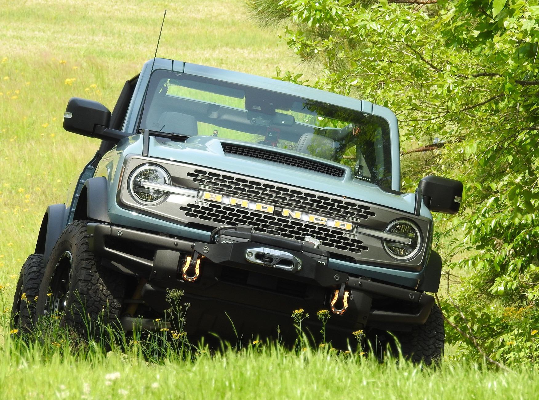

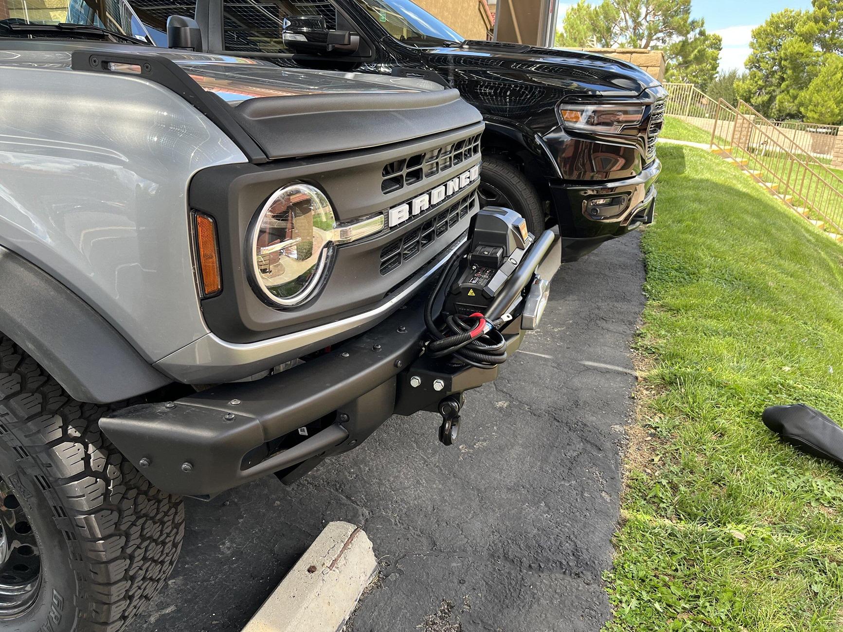

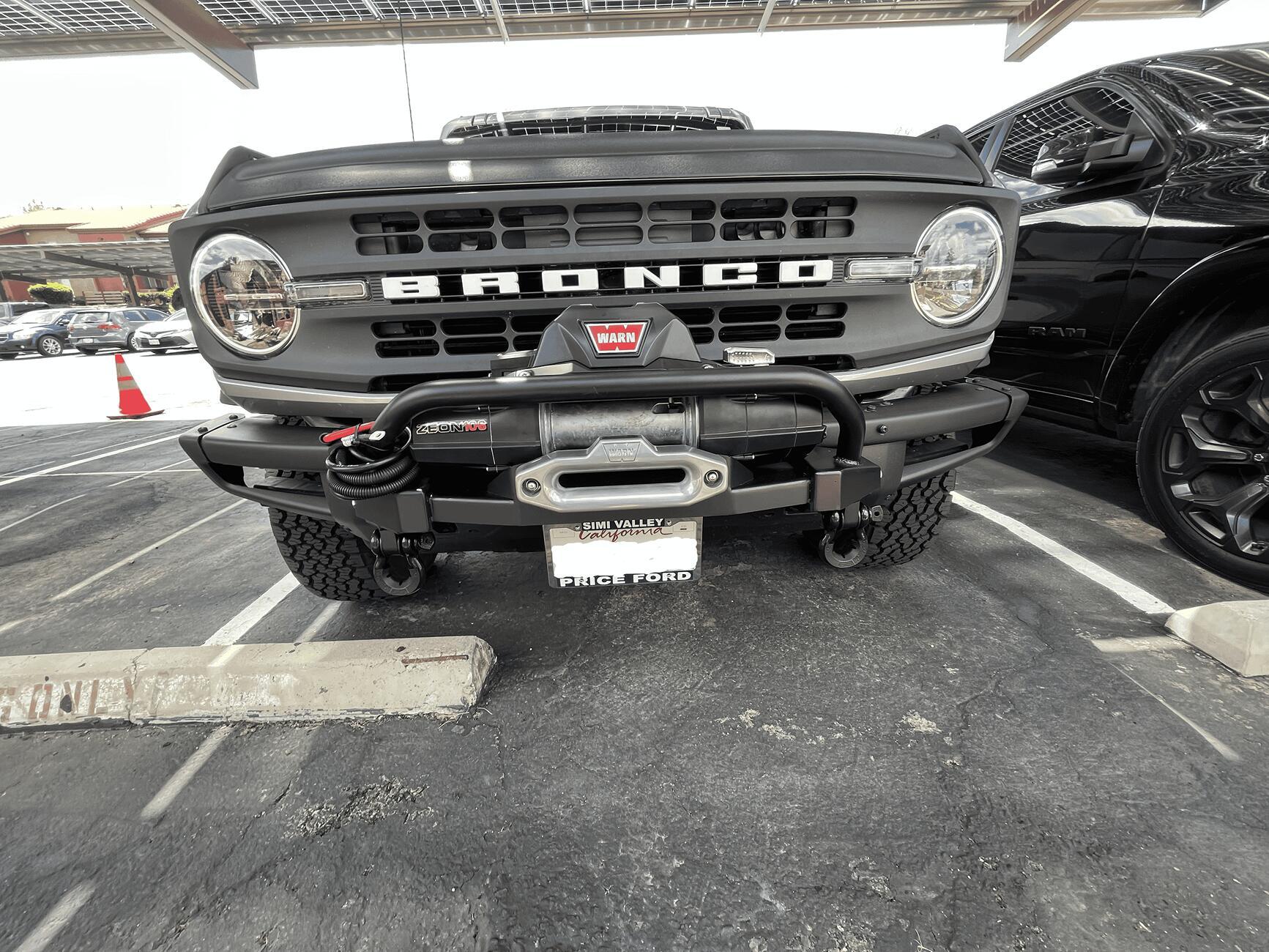

IAG I-Line Modular Front Bumper Winch Mount w/a Warn Zeon 10s Winch.
Ford Bronco Minimal Winch Help IMG_0584A
