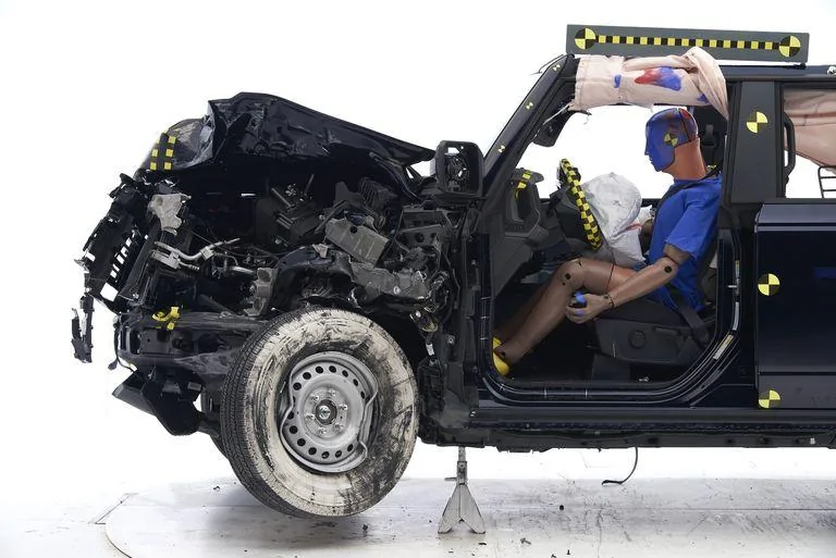

Look at the wheels in this photo.
I’m leaving them on.
Oof, definately looks like it did something protective from this picture. I don't plan on pulling them and moding stuff as soon as I get it anyways. I'm gonna sit back and see how this all plays out lol. Thanks for sharing.

from another thread. you can see the difference. looks like they are contain the wheel so it doesn't move too much and jam into the footwell. that being said, rear passengers most likely will not have their safety compromised with the crash bars removed. depending the impact, the driver and front passenger may.
Preventing wheel intrusion is exactly what they are for.

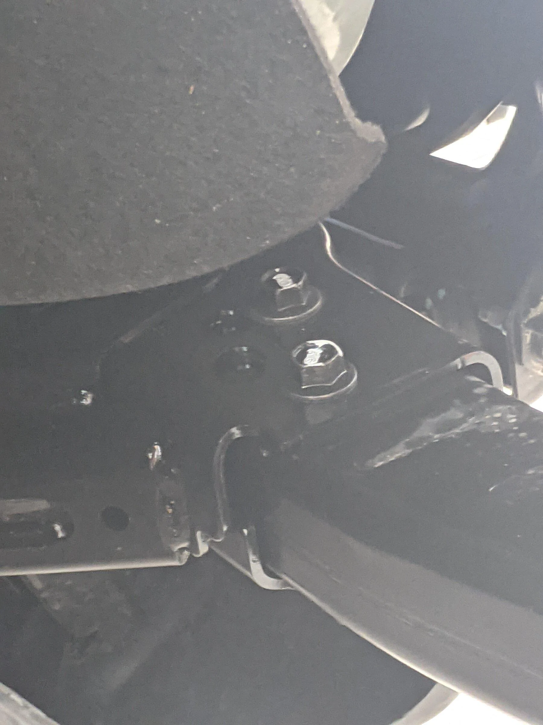

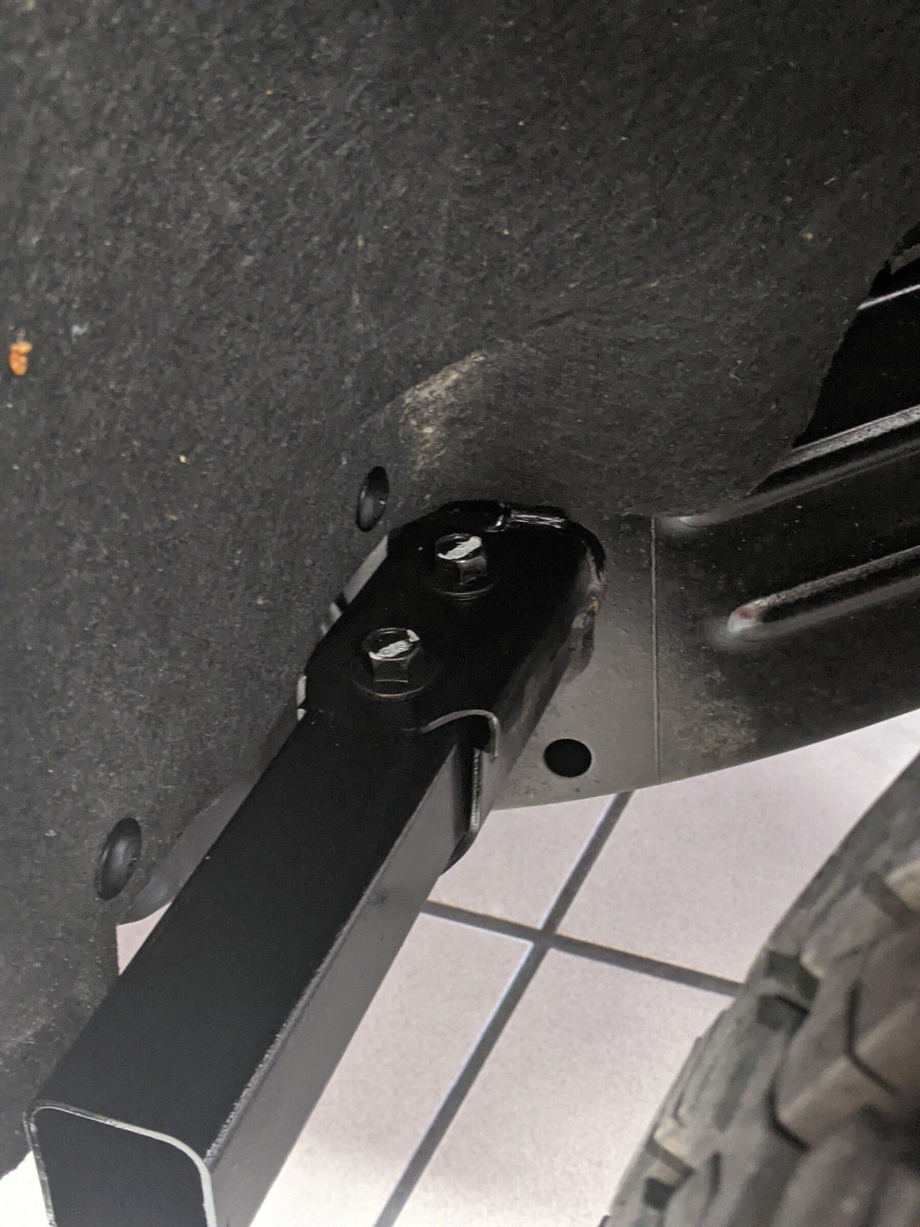

Here are some photos. They are meant to prevent the tire/rim from smashing into the frame in a crash. I think the 35's have enough width to safely have the crash bars removed. I might be mistaken but I believe all badlands 33's and SAS do not have crash bars. But I could be wrong on that.
