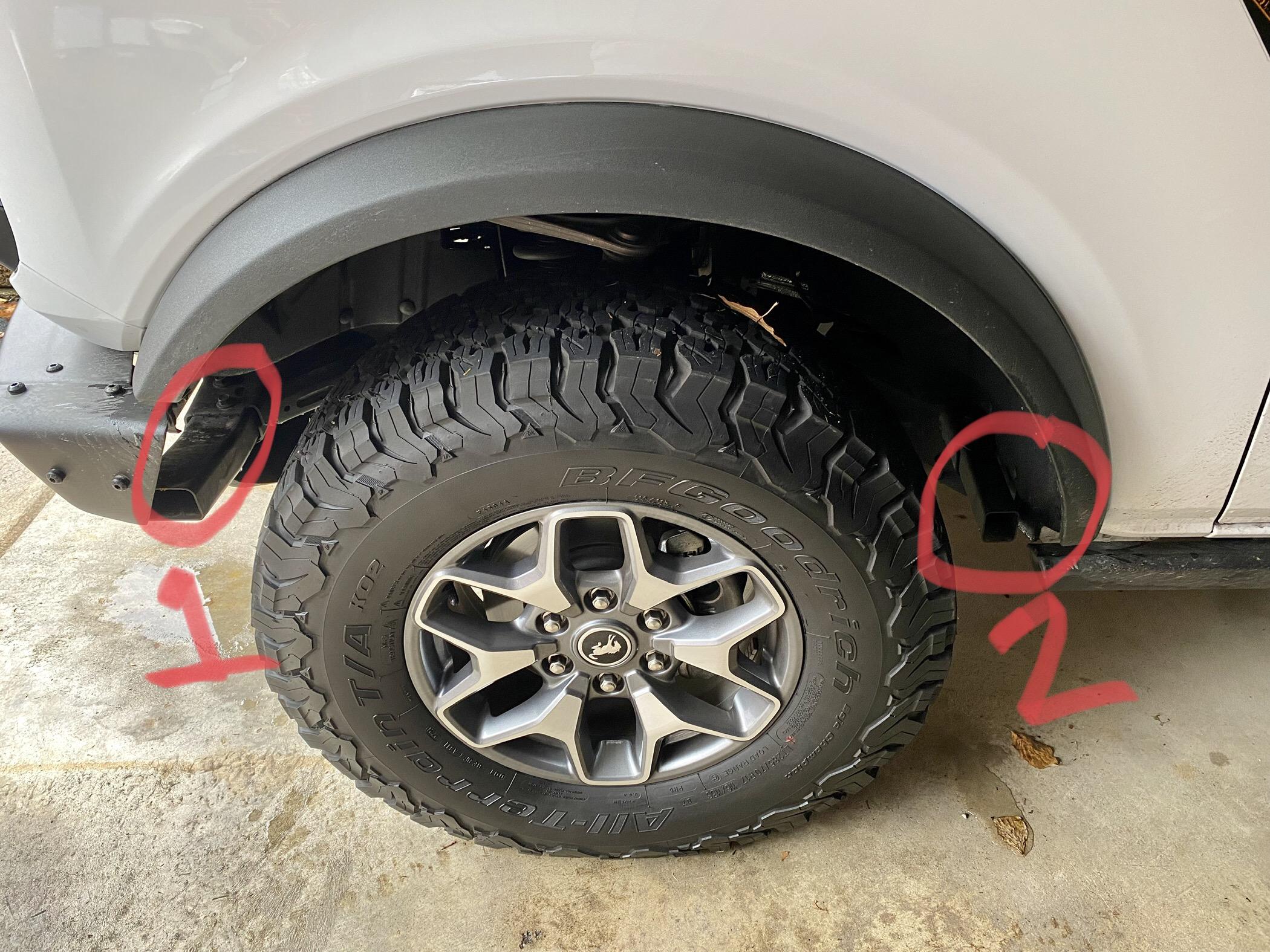

Correct. I figured because the SAS doesn’t have it that I’m fine removing mine until a suitable replacement exists. 93% of the time I’m the only occupant in my Bronco. I don’t know of SAS vs non-SAS crash ratings either.
Oh and the rear crash bars are 1.4lbs each and the fronts are 2.9lbs each so call it 1.5 and 3 for scale error. Attached is a pic of them. Front bar is the larger, angled bar. Front bar is 11 and 5/16ths inches for reference

You're over thinking this or don't understand how they work.
It's a steel tube that's less than a foot long. Go under there and look. I think it was a 13mm socket that is needed. The bolts were torqued so take a breaker bar too.
I spent some time looking at them while I was working on a light bracket (the two bolts make a great mounting point by the way) and am impressed with the simplicity of the design. Its not the weight that makes them useful. Their shape, position, bracket mount, diagonal support, etc. is genius.
I watched crash tests (on here someplace) and wondered how the impact energy from a frontal collision would push the car sideways (good thing) to keep the energy from going all the way into the cab. Looking at the entire design shows how they work. Its a series of collapsible sections that would force an intrusion out as they collapse. Its really quite simple.
Good job Ford. I'm keeping mine.
I can also see how a tapered one would be beneficial and still work to some extent if it was clearanced for a larger tire.

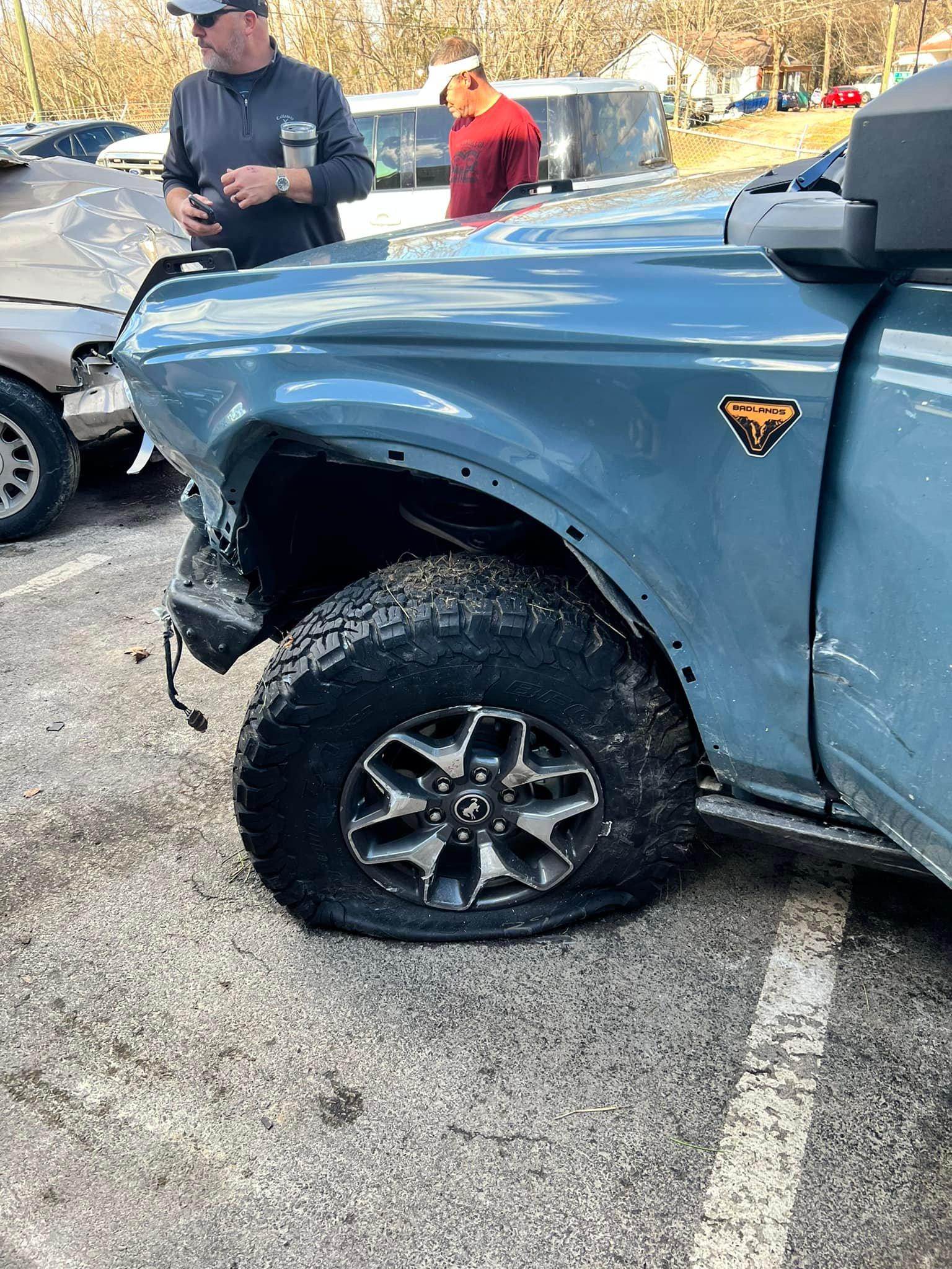

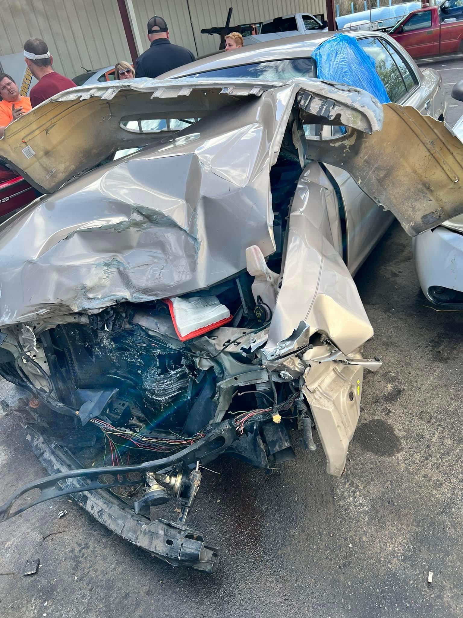

OMG really ? Here you go took me about 5 seconds to google this.... If you think you are safe because of that flimsy piece of metal, well...
This person may respectfully disagree. Hit head on by vehicle B
