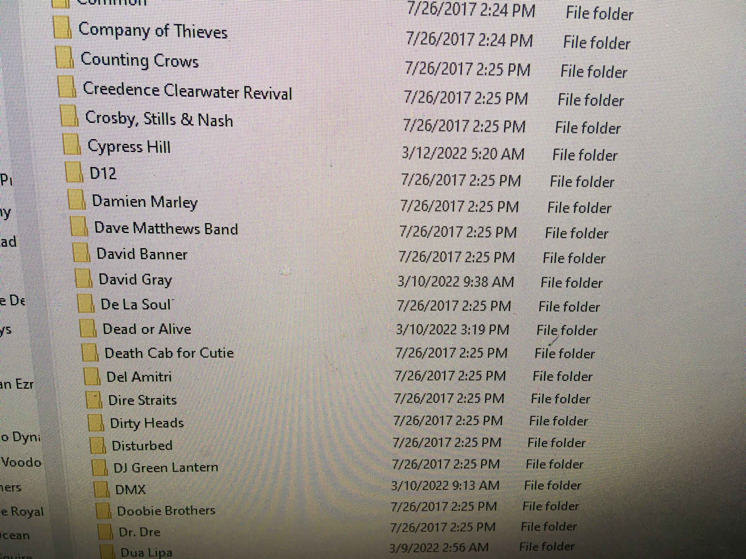

So I have a '13 Jeep Wrangler Rubicon. It has about HALF of my music collection on it's internal hard-drive and it's very, very useful ... you go to the HDD and the music appears in a list just like you'd expect on the computer - you have options as to how it's displayed but the most useful and common is to display it by the Artist, which presents you a list of the musicians alphabetically. So as you can imagine, 311 is at the top, Pearl Jam is down near the bottom, Phish after it, etc. Very easy to manipulate the music even driving.
I have twice now tried to put it in the Bronco and I guess the deal is, there is no HDD so I have to bring the memory stick with me. I can live with that. BUT... the first time, it was just a mess. Almost all the songs have a number before them in the name/file - usually it's the track listing from the album it came off off ... so there was a huge mess of songs that there was no logical method but it TRIED to be alphabetical. But it just displays SONGS, not the Artists or Folders or anything like that. Good luck finding whichever song you wanted to find... I spent hours removing the numbers from all the names on the USB drive and organizing it again, took hours sitting in front of the computer.
I put it in again, it says it's Indexing and spent a long time Indexing. I googled it and Ford apparently has occasional musical Indexing problems, so I pulled it out, plugged it back in and it fired up again... except... It's now just a Random List Of Songs. No alphabetical order, no logical order, no Folders or list of Artists, just a long random list of songs.

I haven’t tried it but with some experimenting you night be able to get it to work by adding the artist name and album before the song name. A batch renaming tool would make the renaming much easier. Could have removed all the numbers in a few seconds.

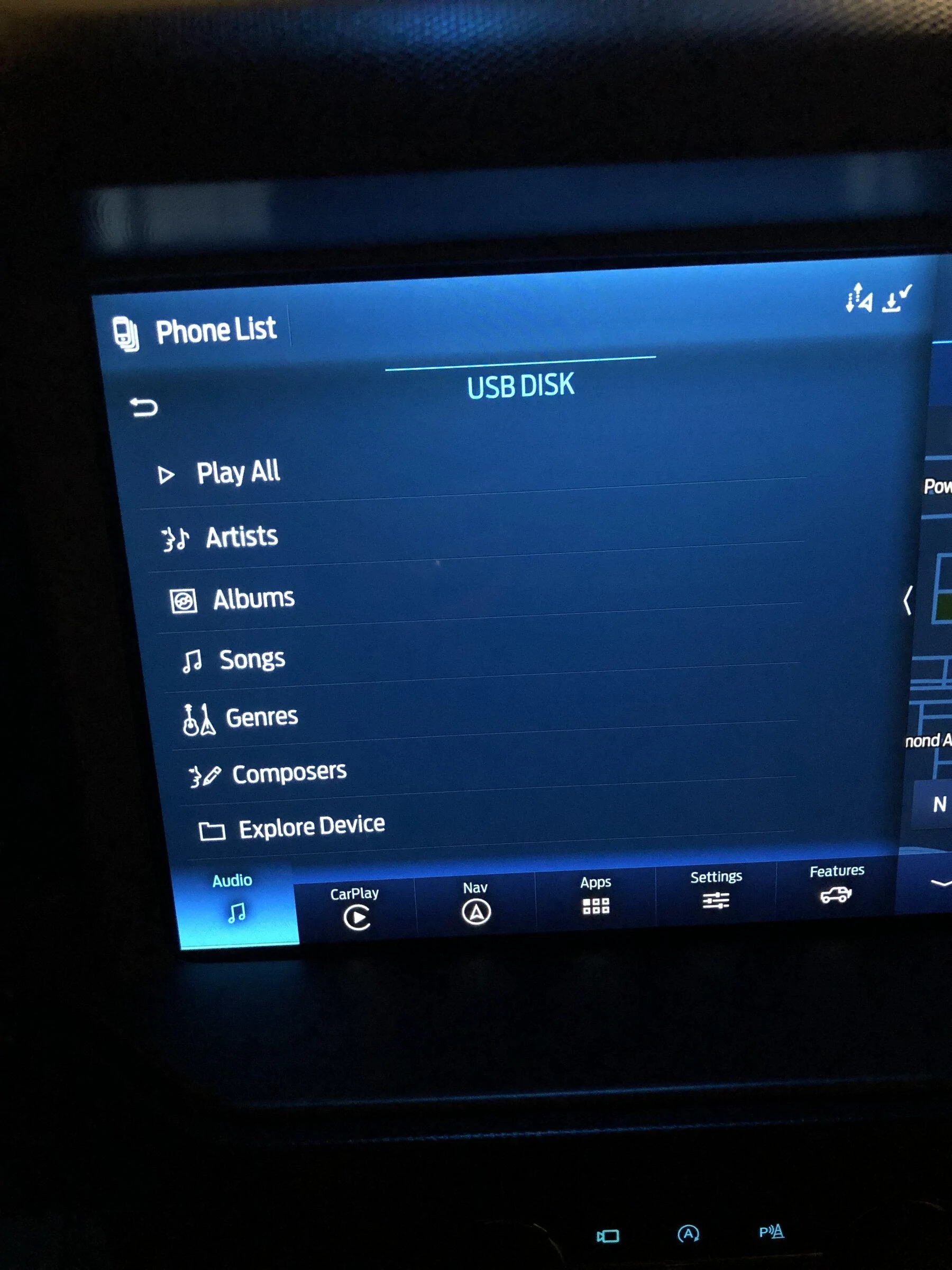

I use a small flash drive with music on my Pilot. I recently ordered a tiny flash drive so that the USB door mostly closes and loaded it with music for my OBX. I have 2 different folders for 2 different genres of music. When I open up the USB label, and choose which music folder I want, the music is all listed in alpha order. I label my songs this way as an example: The Who - Won’t Get Fooled Again. Everything works as it should. I use the USB port under the dash in front of wireless charging cradle. I will say that when I open the Browse window, it shows the music in alpha order of the performer, although the performer’s name doesn’t show….just the name of the songs. It all works well for me at the end of the day. The USB listing does offer the music to be viewed by Artist, Albums, Songs, Genres, & Composers.

It took a while, but eventually my Bronco indexed the drive and it is searchable, with options to sort by song, artist, album, etc. It also has the playlists available.
