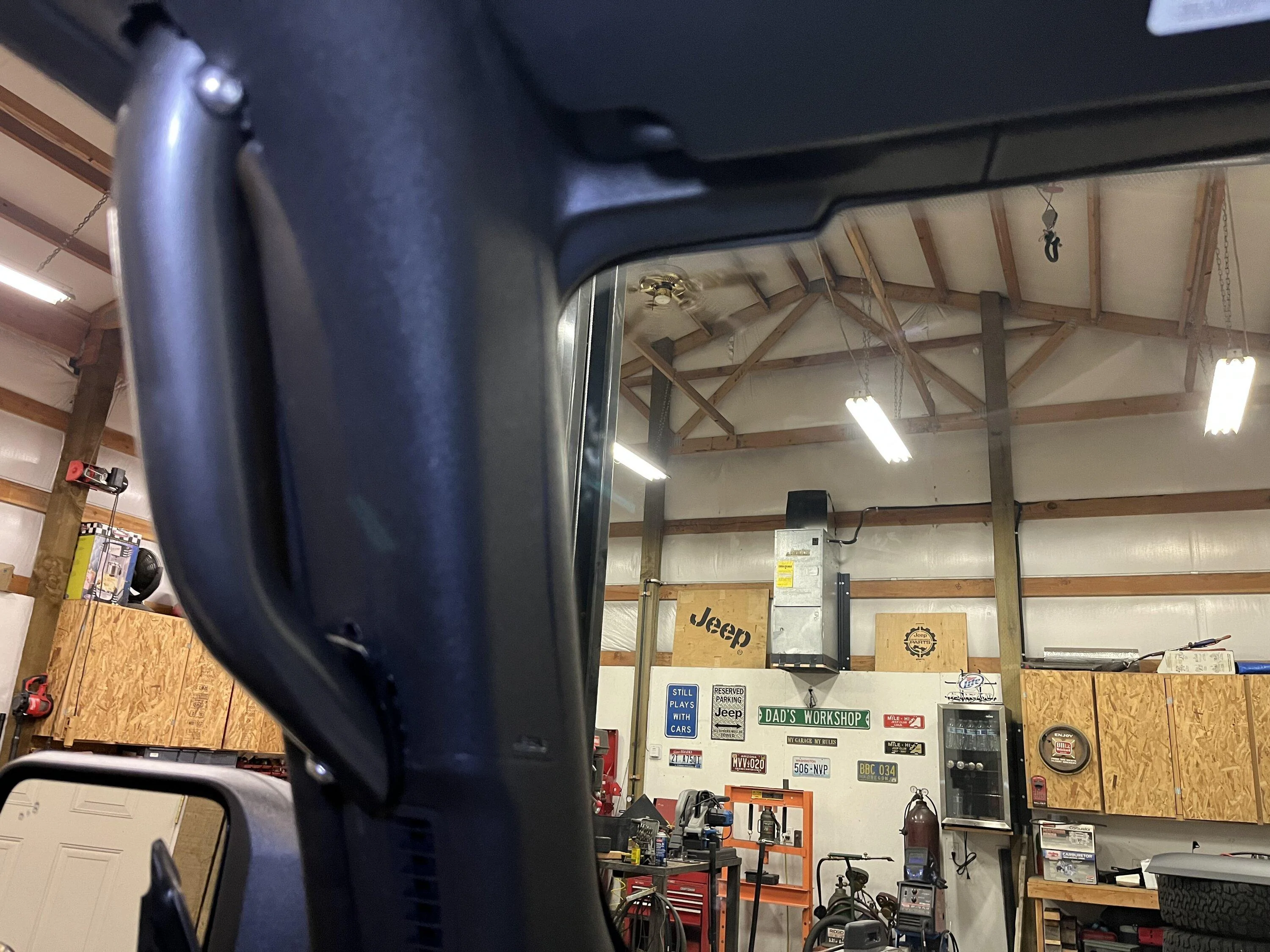

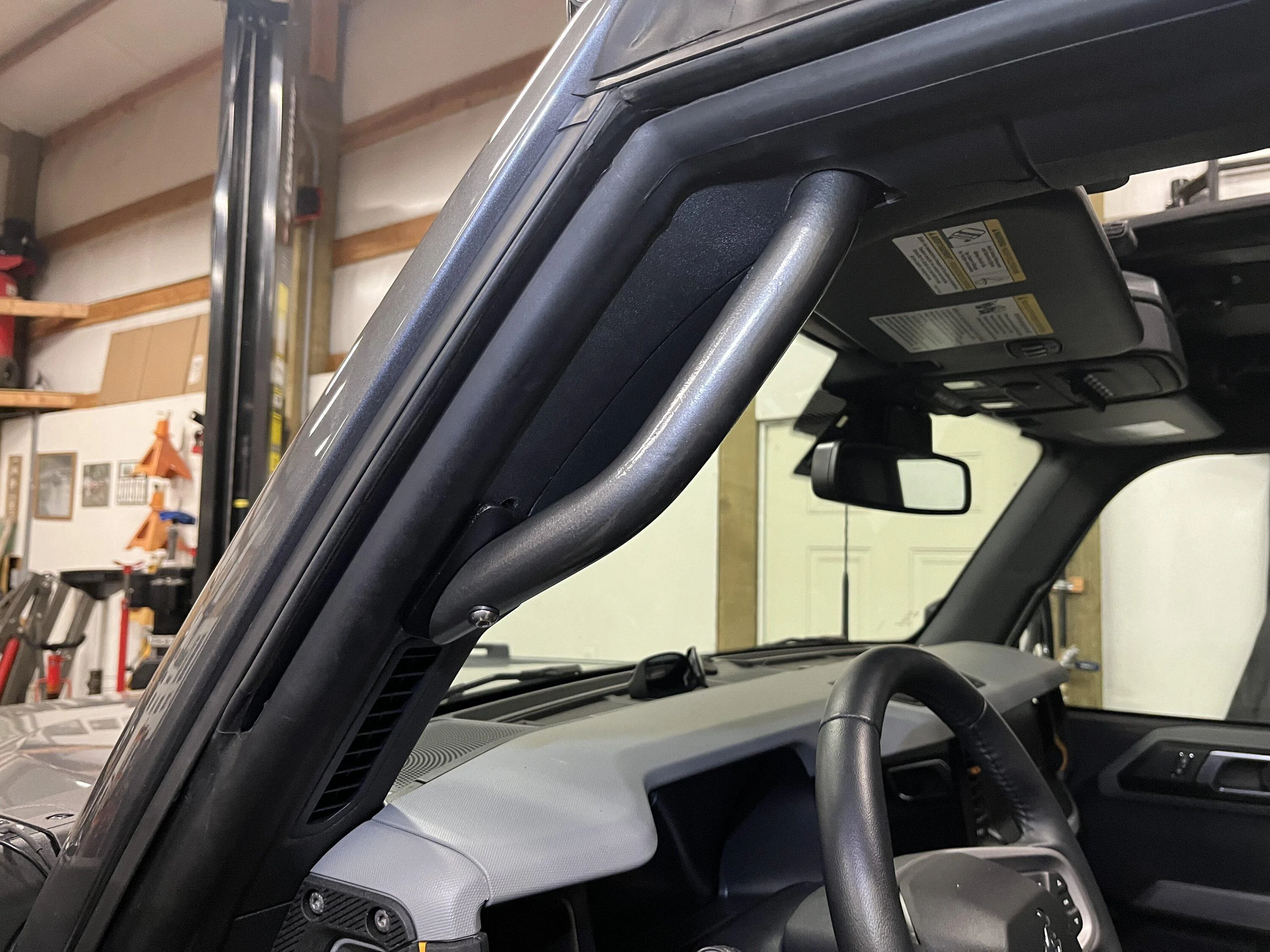

After living with my first draft for a couple of months, it became apparent that the 3/4" tube I used was a little too small and was hard on the hands. Plus, I wasn't entirely happy with the lazy route I had taken in the overall design, and wanted something a little cleaner looking. For this go-round, I used 1-1/4" tube and made the handle an assembly comprised of 3 sections, ultimately aiding in ease of final installation and a little less arm wrestling to get things in place.

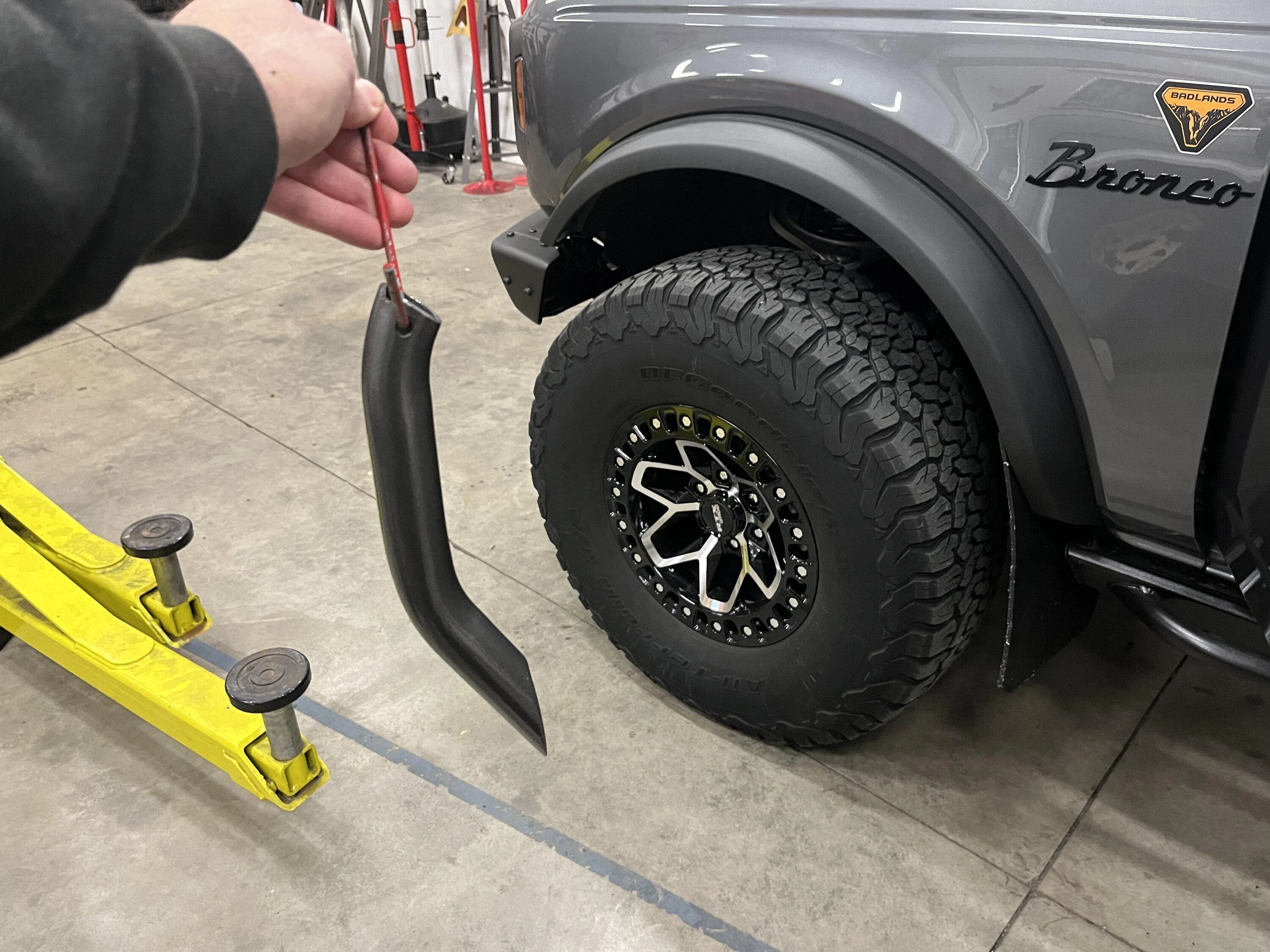

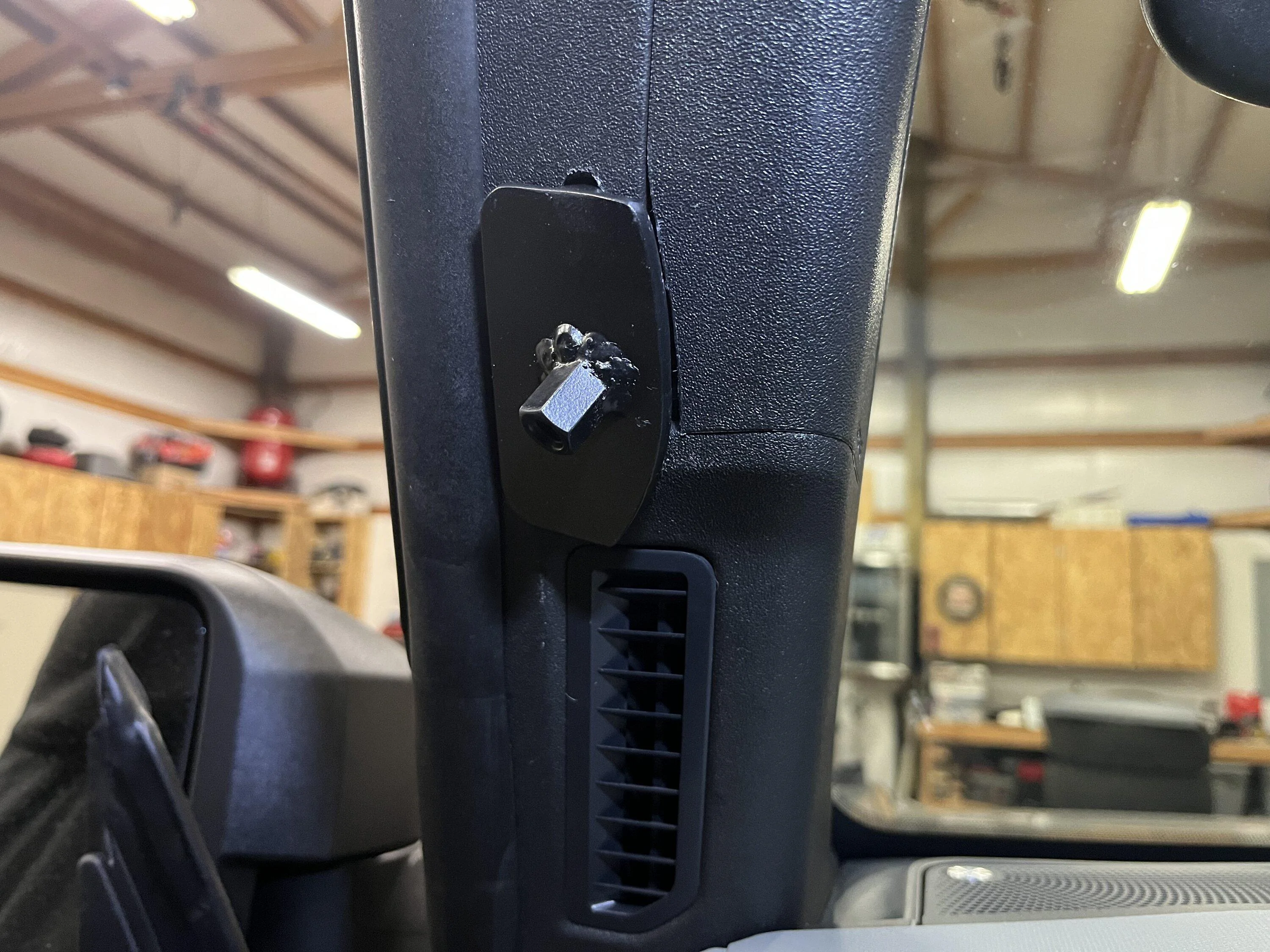

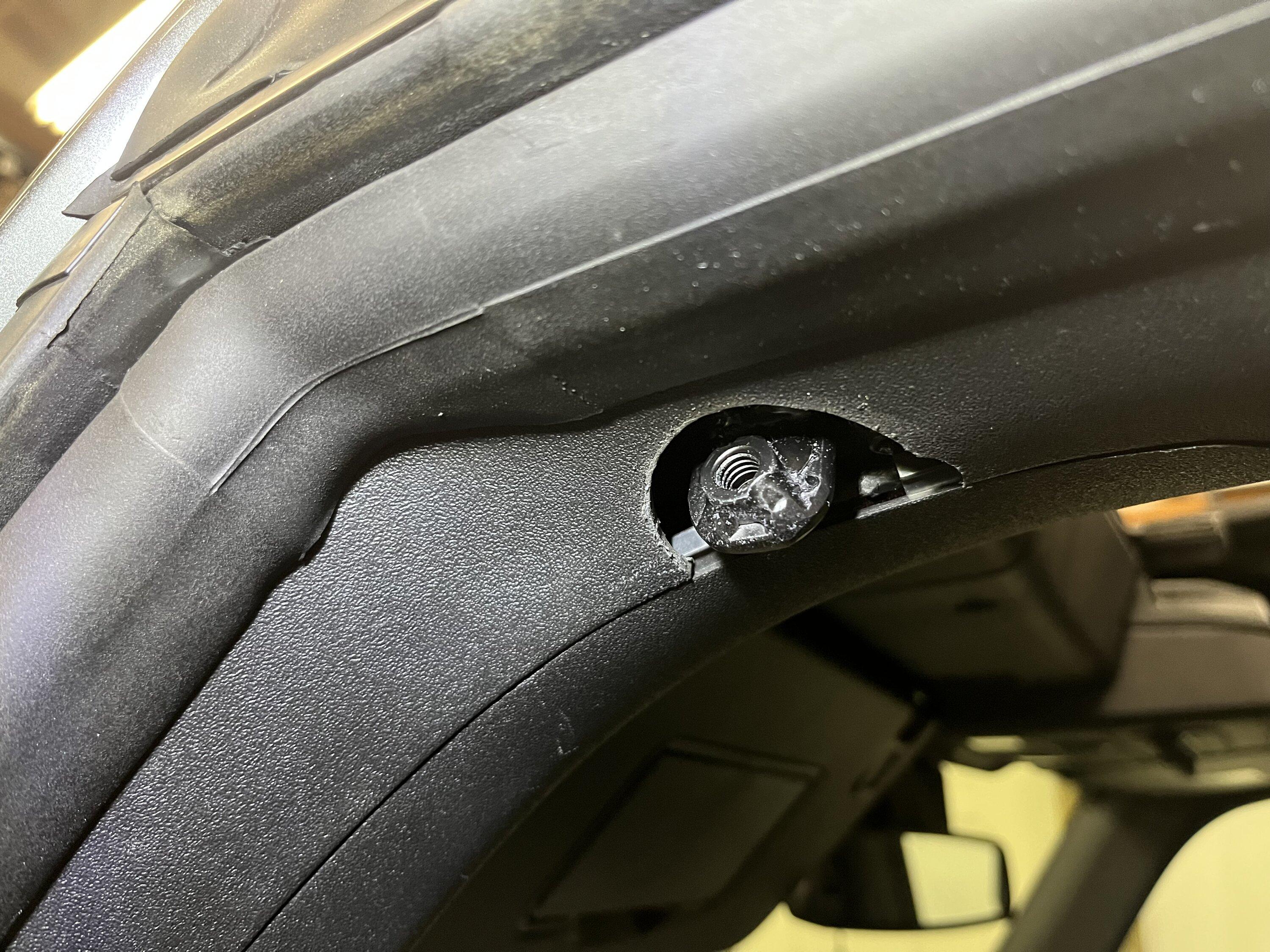

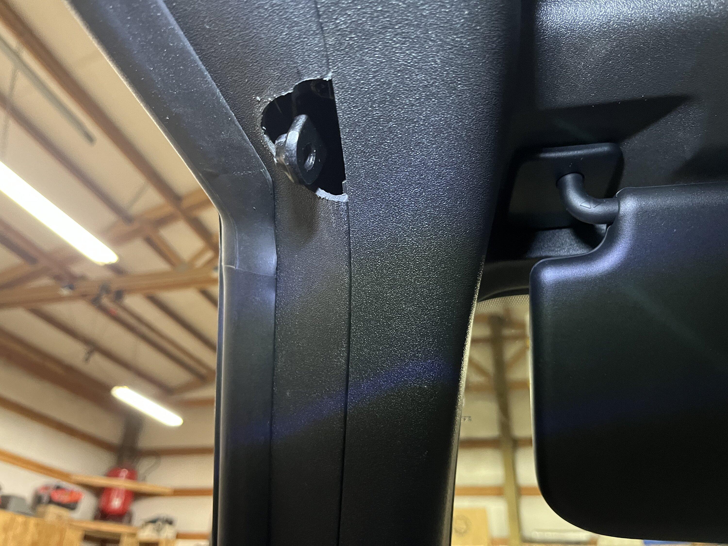

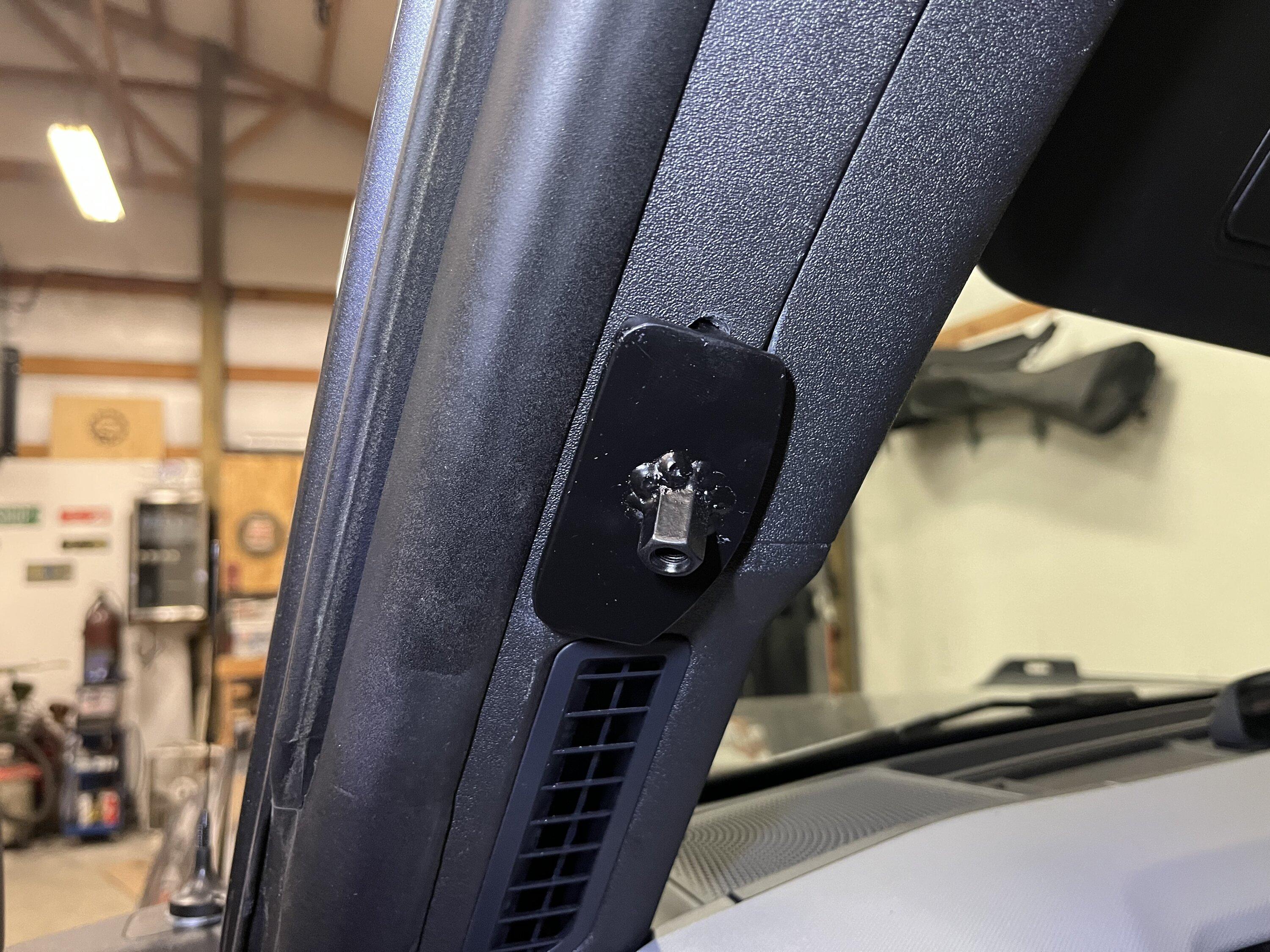

Does it hinder the side air bag all all?
No, the side airbag is meant to deploy straight down, parallel to the side window, and I was careful to keep the handle and mounting brackets clear of the blow away panels and the travel path of the airbag as it unfolds/inflates. I did have to carve a little bit of the plastic out to allow it to clear the lower mount bracket and the upper assembly bolt head though, again just to ensure a clear travel path in case the worst happens:
