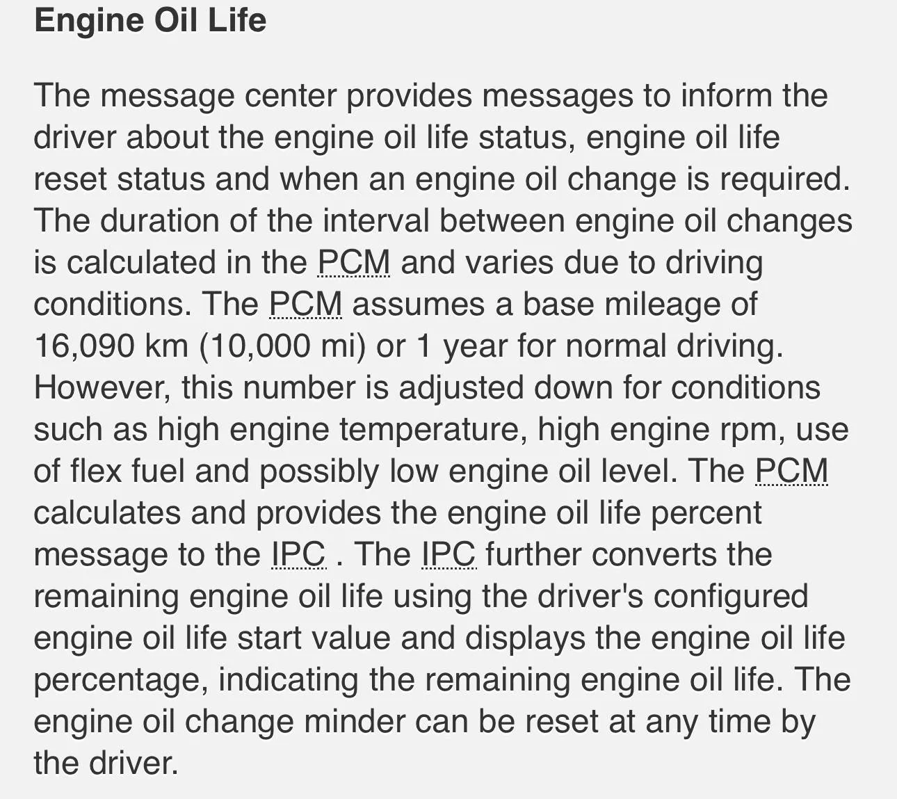

I wondered about this. I’ve gone 3200 miles since my first oil change and lost 32% of the oil life (68% oil life remaining). Kinda seems like a 10k countdown.
I would tend to agree.
Ford Bronco Oil Change Frequency IMG_9777

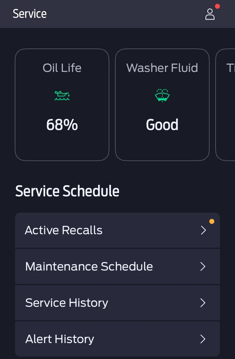

Ah. That little Distance nugget is missing in the app.
Ford Bronco Oil Change Frequency IMG_2691

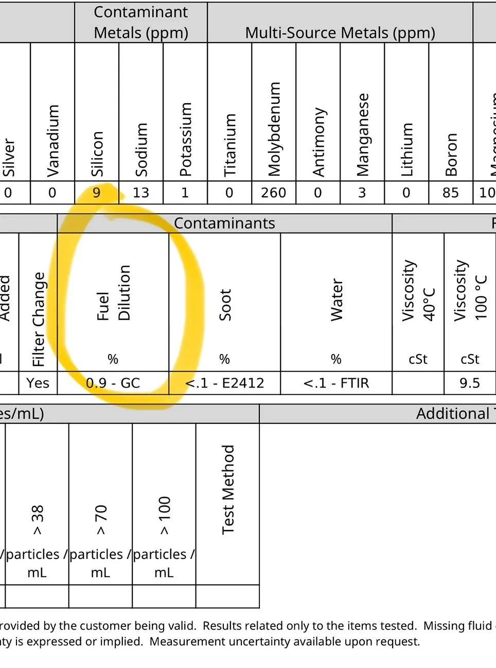

I have heard that it's important to change oil more frequently with E85 as it tends to contribute to oil dilution more quickly than gasoline from what I understand.
I’ve heard the same. My most recent oil analysis shows that it doesn’t seem to be an issue with the 5K interval.
Ford Bronco Oil Change Frequency IMG_7106
Exactly... 5k miles is well before significant dilution occurs... is it overkill? Perhaps, but it's better than being on the wrong side of the curve.
